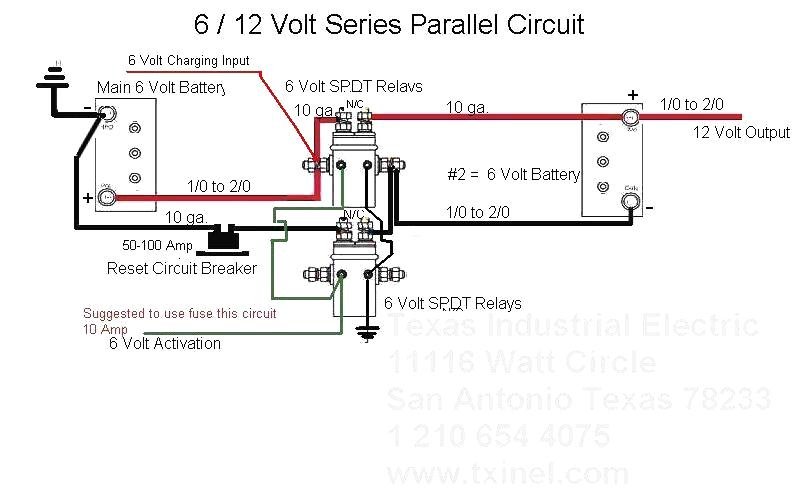

The tech "Steve" at Texas Industrial Electrics has come up with a less expensve and rather ingenious circuit for starting with 12v while running on 6.
Yeah, in a perfect world I would keep my 1924 T on six volts. Difficulty keeping all the contacts beautiful in a Florida salt spray environment led me to wanting to add a second battery and send 12v to the starter while not changing over to a 12v system. I tried a 12/24 series/parallel relay that was lying around after adding a battery under the rear deck just in front of the rear axle. It worked at 6.3v, but at 6.1v the coil couldn't keep the contacts in place against the return spring. It went clunk but nothing came out the series end. A 6/12 series/parallel switch is $550+, too much on our "It's a toy" model T budget. Steve came up with this circuit, which uses two $90 six volt relays. The ingenoius part is that he figured out how to wire them so that the generator still charges both batteries when they are in parallel, but there is not a feedback route while the starter is fired up. [image][/image]

Hi Tim,
Being familiar with series/parallel starting systems and with basic wiring schematic practices, I believe there is a small mistake in the wiring diagram. I suggest you confer with your tech. Steve to ensure his specifications are correct.
When drawing a schematic with different width lines, representing different wire gauges, the same width is used for the same gauge. Thus the thick red wires and thick black wires should be the same gauge wherever they are the same width on the schematic.
Steve has BOTH the red and black wires labeled 1/0 or 2/0 in places AND 10 gauge in other places. I believe they should be 1/0 or 2/0 in ALL PLACES where they are depicted as the same width.
Another small problem is there is NO gauge designation for the Main 6 volt battery ground wire. This should be labeled as 1/0 or 2/0 as it will be carrying high amperage as does the #2 6 volt battery POSITIVE output that is labeled as such.
Maybe this is all spot on but a 50-100 amp circuit breaker in a 10 gauge wire appears to be incorrect when the current rating for 10 gauge wire is 15 amps maximum continuous.

You putting 12V to a 6V starter is a bad idea thats been done & is ignorantly still done. With good connections, a good starter & proper cables, its not necessary & is detrimental to the bendix & ring gear. I'm sure you've heard this.
Possibly your idea of this 6/12v relay unit could have benefit & less a damaging effect if the starter saw 6V to engage the drive, then 12V kicks in to turn the motor over. Still all unnecessary. This is a band-aid to mask the real problems.
Another, less harmful band-aid would be to install an 8V battery. A bit more expensive than a 6V battery, but compatible with all the 6V system.
(lights , dizzy coils, etc. are rated 6-8 volts.) Benefit brighter lights.

I agree with many of the other posts here; if you're doing this because the starter motor turns over too slowly then you should probably sort that out first.
However I want to comment on your original post; I would not add such complexity to the Model T, it's simply not called for. A good T will start and run fine on 6V, it will start ok and probably run even better on 12V, and the generator will charge 12V without issue, there's simply no need to switch between the two voltages as per your circuit should you decide to put a 12V battery in place.
The money you'd save on the switching relays etc would be better employed in purchasing some LED bulbs, and altering the starter motor to better operate on 12V.
In terms of fault-finding with your present issue; firstly, can you reasonably easily turn over the vehicle with the crank? If not then take note of some of the suggestions above about what might be causing drag etc.
If however it turns over ok you'll need to use a voltmeter and start at the battery then work your way forward looking for any significant voltage drops when the starter motor is employed. If you have one an IR camera is a very useful tool and will quickly identify poor connections and/or cables. Checking the battery will tell you if it's dropping too low at start (thus suggesting has too high an internal resistance and may require replacement), looking for voltage drops across cables and/or connections will determine if that cable or connection has too high a resistance. If so clean or replace the connection, or replace the cable (or crimp lug if that's where the issue lays).

Hi Tim,
Putting the 6 vs 12 volt argument aside. I have seen this on a car years ago but did not figure out how it was done. With that aside in
your schematic, yes the 10Gauge wire is incorrect it should be a 00 /000 wire on the cranking circuit. A 10 gauge wire will most likely
be a smoke indicating slow blow fuse. the other issue I seen is the batteries are in parallel not series so that would still be 6 volts.
One issue that will occur using 6 & 12volts is while cranking anything in the 6 volt circuit that is on will be damaged i.e. brake light
bulb if you have your foot on the brake & head lights if left on. and still only one battery is in the charging circuit. To charge both
batteries you need a battery isolator switch and they are hard to find in 6 volts. Tim I have some unorthodox ideas on this that are not
conducive to the forum conversation, give me a email and we'll bang some ideas around OK.
Craig.
Craig.

- Posts: 6588
Re: 6/12v series parallel circuit
I think the impression that a 12 volt battery is a better starting battery than a 6 volt is because the proper battery specification is not being compared. A starters power, torque, is driven by amperage not volts. If you go buy a drill you'd likely pick the one with the highest torque specification which is in amps (some now use UWO, Unit Watts Out. basically the same, higher the value the more torque). Torque is needed to rotate a stiff engine. Jump starting an engine doesn't take much vehicle speed to cause suffient engine RPM's to get a car started
Frank,
Just to clarify, power is a function of both voltage and current (W=E*I). Torque, typically measured in ft/lbs or Nm, is a function of power and angular velocity, thus torque is affected by voltage as well as current.
You are right that the battery (the supply of energy from which power is derived) matters, and that to some extent this is independent of the system voltage. However the starting system, which comprises a number of components (including the wiring), may work appreciably better if the power|torque is derived from a higher voltage and lower current since for a given size of cable you will only be able to pass a certain amount of current.
Luke.

- Posts: 8663
As I understand it, higher voltage will push more current (amperage) through a given circuit. A 6 volt system in good condition, including the battery, is fully capable of moving more than enough current to operate the starter to near its design limit. Raising the supply voltage significantly above what a system or component is designed for, that is in good condition, will lead to trouble sooner or later. Probably sooner. Slamming a 6 volt starter with 10 volts or more can be expected to damage it, and likley damage the flywheel ring gear and other mechanical parts as well. If all connections are good, applying 12 volts from a healthy 12 volt battery to a 6 volt starter will overload the battery and the starter and could be expected to shorten the life of both of them, and the starter switch as well.
Pat,
Voltage and current are two separate things, thus a higher voltage will not 'push more current'.
However a higher voltage at the same current will ultimately deliver more power, or conversely a higher voltage will deliver the same power at a lower current. This is why a higher voltage is preferable for systems that have components only just able to carry a given current at a lower voltage, or wiring that is of a size/length/resistance such that voltage drop is significant enough to affect the desired outcome...
You are right with regard to applying 12V to the T starter. There have been several ways espoused as to how to deal with this, I favour simply connecting all the field coils in series (as opposed to series/parallel per the original), which deals with the issue nicely - and inexpensively.
Alternatively, at least in the U.S., it would seem that 12V field coils are easily obtainable at a good price (or just speak to AdminJeff
Luke.
