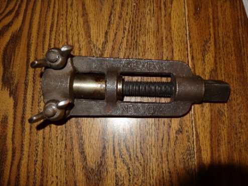

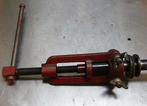

A side note to looking for an example of my missing piece, there were 3 versions of this tool:
The one that I have (and need to make the part for) is the type shown in the second photo. The only difference between the tools shown in the second and third photos would be the handle and the placement of the lettering/wording on the tool. The one in the second photo (handle missing/removed) has no end caps on it and there is a set screw in the square end of the screw that would hold the handle in place or allow it to be removed so you could use a wrench. The one in the third photo has nicely knurled end caps that would keep the handle from being removed.

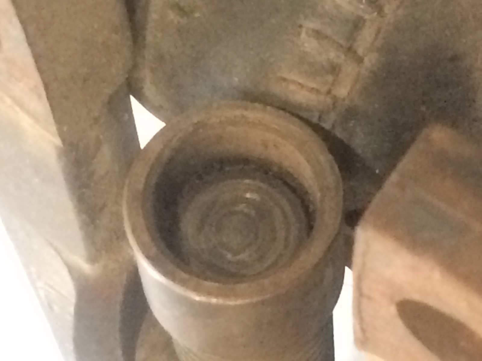

Post by D.Yoder » Sat Apr 27, 2019 10:54 am

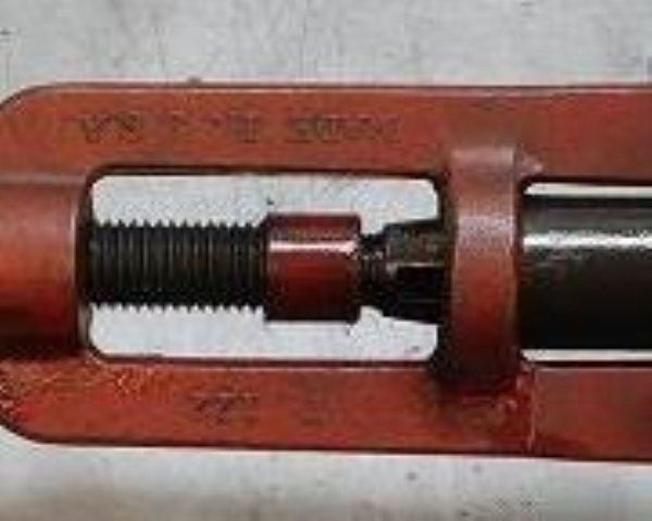

.750 long .652 ID. .872 OD

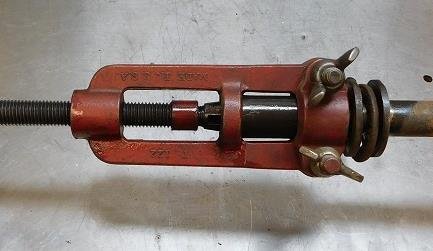

Thank you Dean! Is it threaded in any way or is it just a sleeve that fits over the axle threads and the end of the screw on the puller? If I am seeing it right in the photo, it just looks as though it is a sleeve.

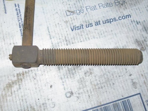

Post by Pep C Strebeck » Sat Apr 27, 2019 3:24 pm

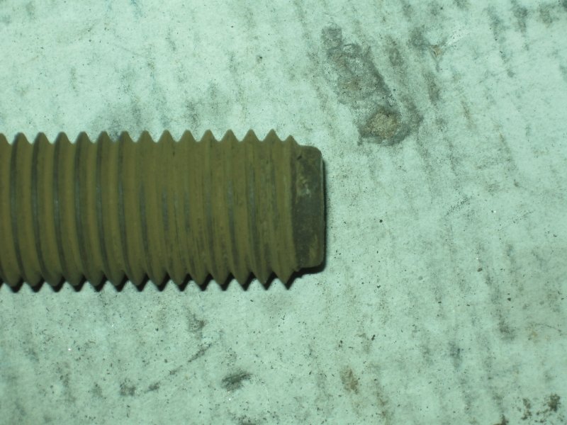

I looked at the end of the screw handle shown in the photo below:
The diameter of the end is 0.580" and the un-threaded portion in just shy of 0.125" in length (before the threads start). With the ID that you gave me, there would be about 0.020" clearance for the threaded end of the drive shaft. So it would appear to me that it is just a sleeve that bears the brunt of the force. The only other question I would have is, in the photo you posted it looks as though there is a chamfer on the inside of the sleeve, do you think that is "factory" or was it created from use?
