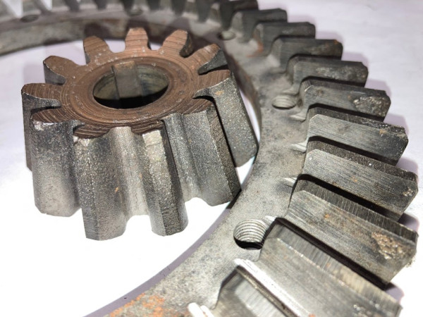

Is this ring gear okay to use?
- Posts: 4838
Re: Is this ring gear okay to use?
I would not.
The drive side of the teeth surface is breaking down. Metal is coming off. Heat treat is gone.
If some one offered this gear to me for $5, I would pass.

I have seen a lot worse working well and most times very quiet. Do you have the matching Pinion? For the amount of miles your most likely to travel and if you infact have the Pinion I would reuse it. I agree that’s it is breaking down but those defects actually hold oil! Sometimes a worn genuine Ford part is superior to reproductions and what you have may give you years of service. Just my opinion

I doubt the pinion I have was used with this ring gear

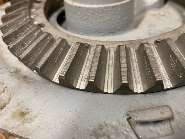

- Posts: 7657
It looks bad to me, but evidently a number of people have had good results with gears in similar condition. It looks like the major wear is near the outer diameter. Since you probably don't have the original pinion gear, or the settings it was running at, you might get better results if you set it up to have the tooth contact area more nearly centered. I'd keep speeds and loads down for a hundred miles or so to give parts a change to wear in. A heavy gear oil might be advisable. You could also consult with Mr Chaffin for advice. I don't know what noise level is normal for a T axle in good condition. I don't think they were ever as quiet as a spiral bevel.

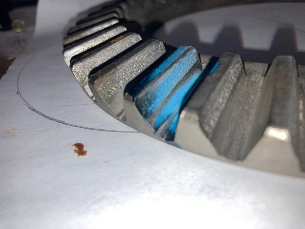

This is my first Model T and have only driven for about an hour total, when I bought this gear I told Chaffin's its only an occasional driver definitely not interested in touring, Chaffin said this gear would work fine and I have no reason to doubt that, he comes highly recommended on the forums, just that being such a newbie I thought I'd check, I just never want to touch the rear axle again.
I blued up a tooth and stoned it, this is what it looks like.
I think I'll post a wanted add for a better gear, just for piece of mind and I don't know any better of whats good and whats not.

For the occasional putt putt for ice cream or a parade, it will probably provide good service.
If you wanted to do significant touring, I would pass on it. My cars get 2,000+ miles a year and if that gear was mine, I would put it in the pitch it bucket.
Chaffins provided a gear that should suit your stated purpose and I'm sure for fewer $$ than a new gear. Should be a good deal in your world.

The main concern with those gears is broken or badly chipped teeth and those teeth are all there.
While there may be a hum associated with the higher speeds, it would not wear beyond use in 25,000 miles.
