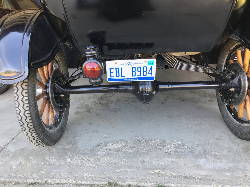

I realize they'll never be confused for 1920ish brakes, but I absolutely love and depend upon my sure stop disc brakes. No adjustment required, work in reverse and when wet, about as good as you can get for a Model T. They aren't cheap but in my opinion, money well spent. If you want a good, safe car to tour in you can't go wrong. While you're at it, you might consider floating safety hubs. One more thing, if you don't know the condition of the rear end (like whether it has babbitt thrust washers or bronze) plan on tearing it down for inspection. I've helped on a number of cars this past summer and all required new axles and a couple had the dangerous babbitt thrust washers. One with the babbitt washers had the ring and pinion so torn up they had to be replaced. This was on a car described as "meticulously restored."

26-7's already have a stout lined parking brake shoe. The suppliers offer an equalizer bar that allows those internal shoes to activate as a service brake. I run big drum rear ends in 3 of my T's with e brake extensions to activate the brakes when extra braking is needed.
Of course, the lining must be maintained grease & oil free.
How this for a range of brake options??
