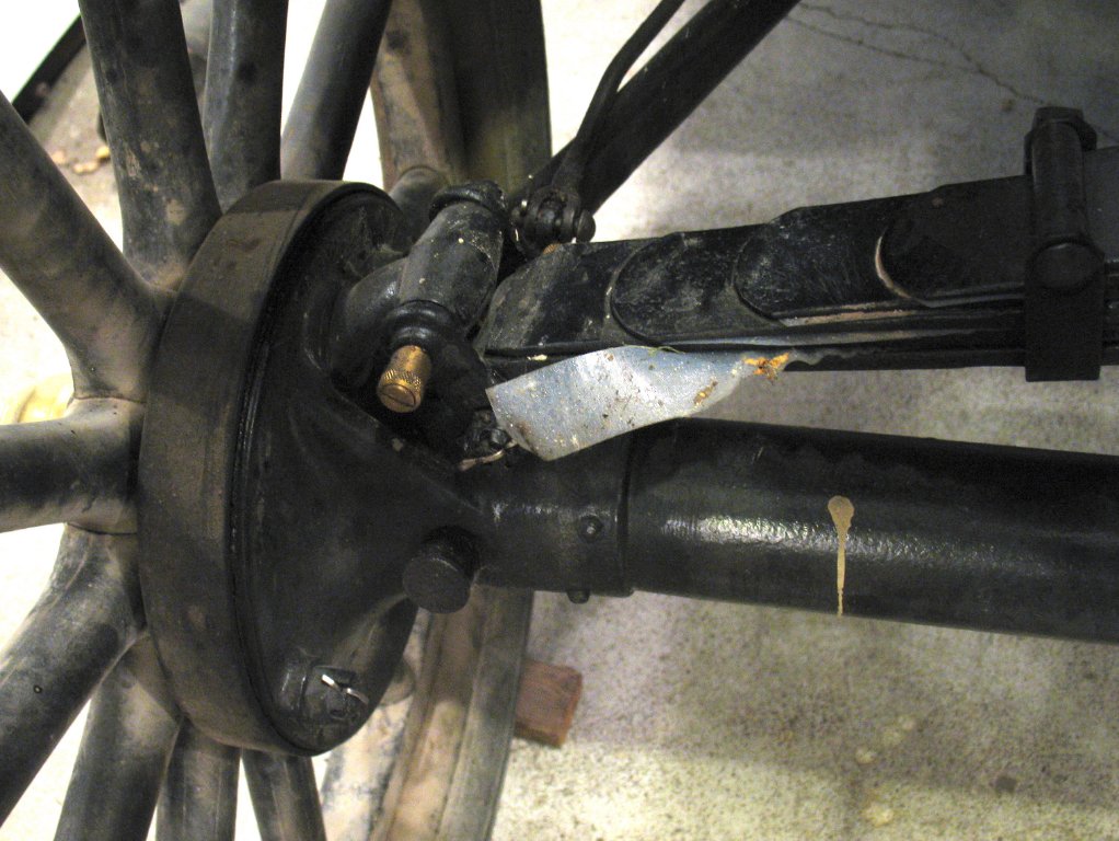

I was just reminded of this while working on the runabout, because it's still happening.
Nine years ago in a forum discussion about lubricating leaf springs, somebody suggested UHMW tape. It sounded good, so I used it. Don't. Within a couple of years it started working out from between the leaves. It still is.

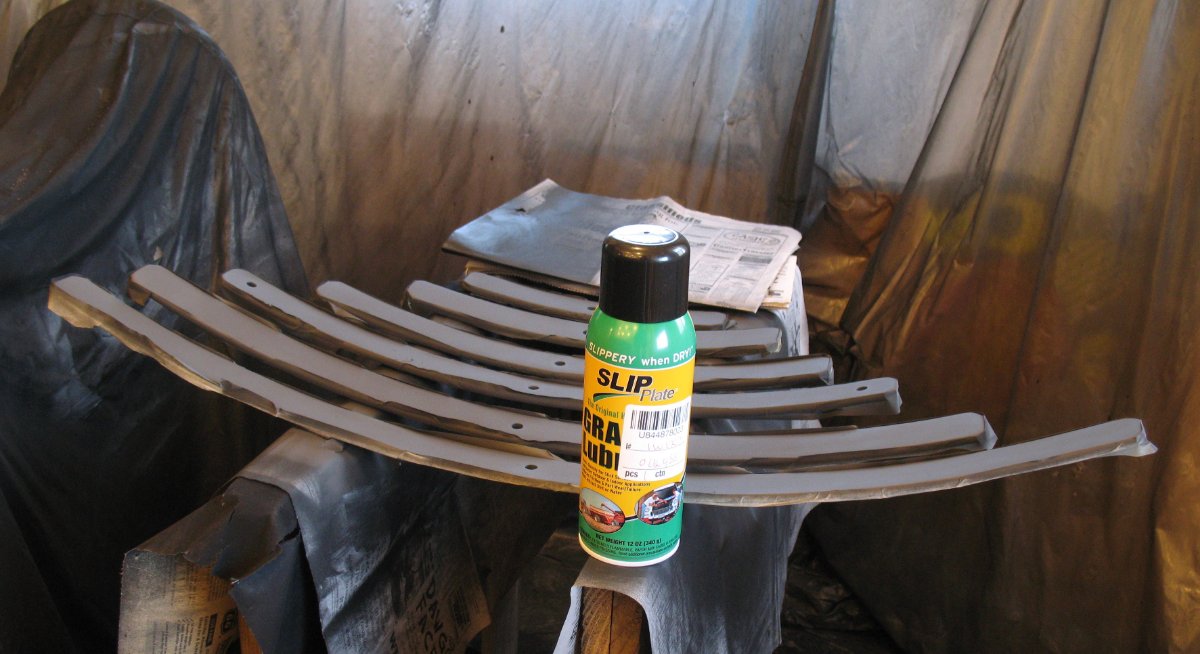

Since that failed experiment I use Slip Plate. It's fine.

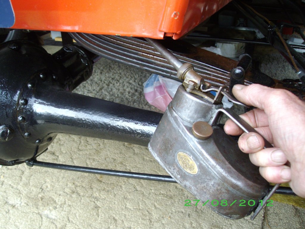

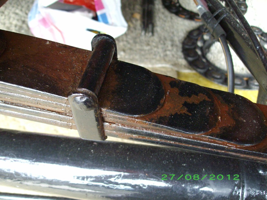

I do it the cheap way before a tour.
Just a few drops of oil on the top of the spring .

Nice oil can!

I was going to paint them anyway, just to make them look better. The slip plate was easy.
