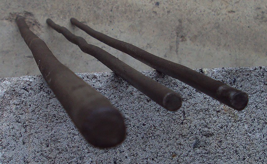

Post by Reno Speedster » Sun Nov 20, 2022 3:52 pm
I oiled the hinges last night then this morning I turned up driver to fit the inside and outside of the central rod then drove it right out. I wiped the inside of the hinges out then drove the new one in. Glad it was not harder.
