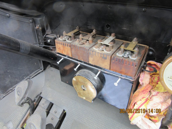

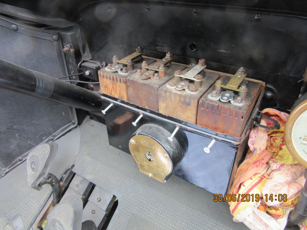

Robert ; On a Tour in France , I saw this SOLUTION .

Antonie, those need to be slot headed screws to be authentic.
