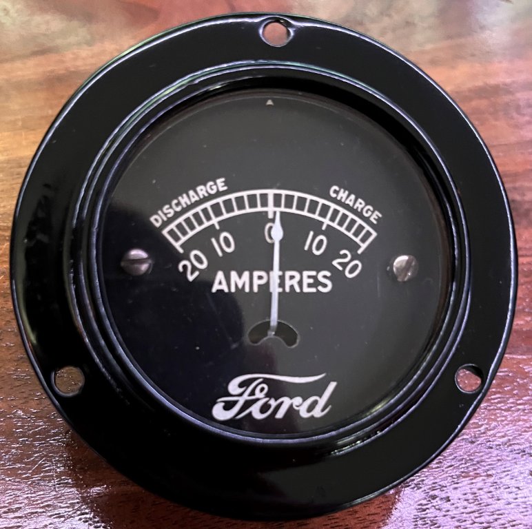

I have found a large type ammeter that appears to be not functional, I do know it has spent it’s life in a toolbox completely dry. What would the feasibility be of either rebuilding it or having it rebuilt?

I’ve got one it looks to be in alright condition I don’t know quite how to put a picture here but the dial is in good condition and the needle moves freely, I need to get it hooked up and tested but it looks promising

Post by M.Sinclair » Thu Dec 01, 2022 9:16 am
Hooked it up and tested it it worked beautifully, media blasted the trim ring just to get the old paint and gunk off.

Post by M.Sinclair » Thu Dec 01, 2022 12:51 pm
I opened it up and checked the contacts, the resistance was normal for what I found but I touched them up anyways, when I tested it there was no feelable heat.

Post by M.Sinclair » Wed Dec 07, 2022 3:19 pm
Here's the completed ammeter, rezeroed it and checked the insides.

Post by A Whiteman » Wed Dec 07, 2022 3:49 pm
Nicely done !
