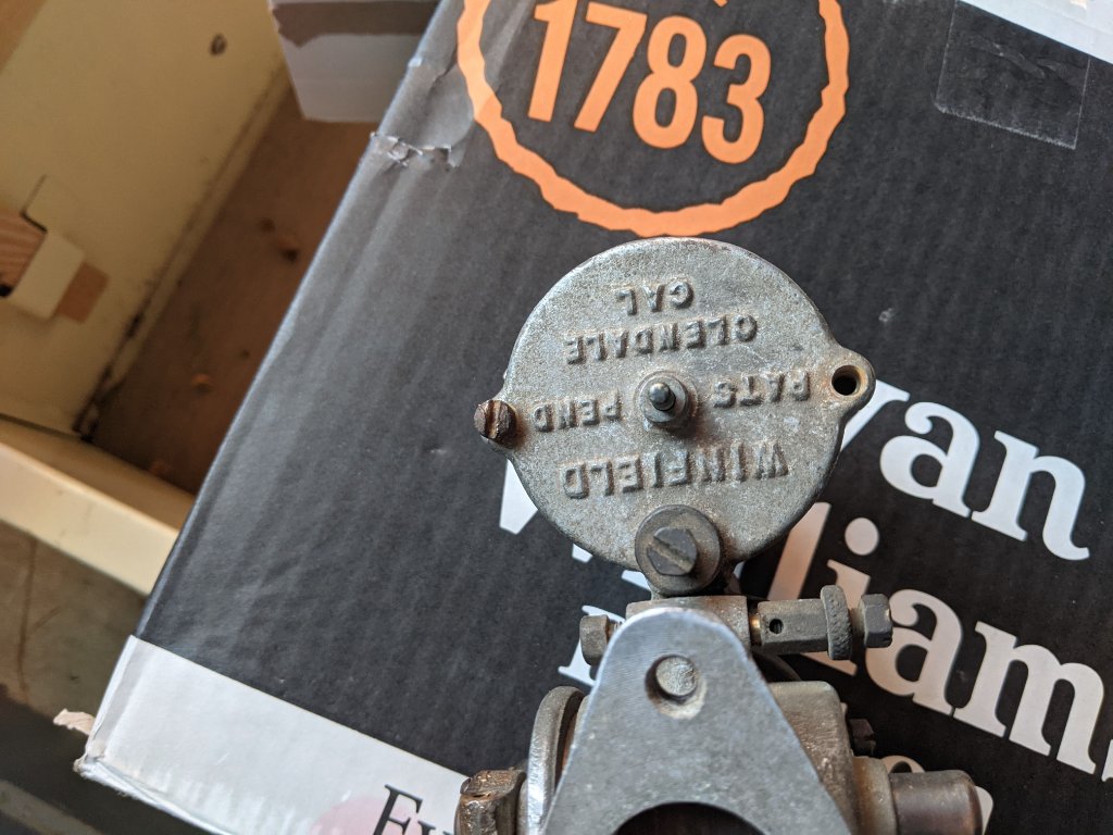

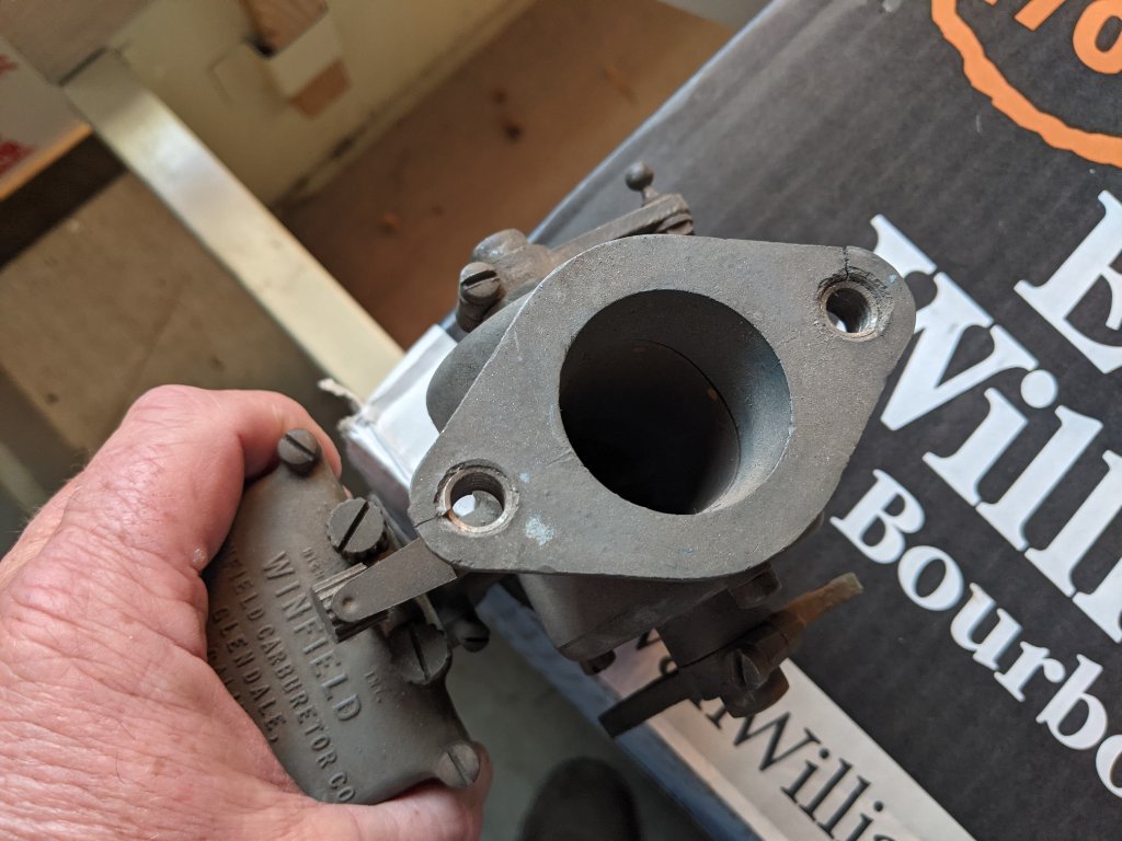

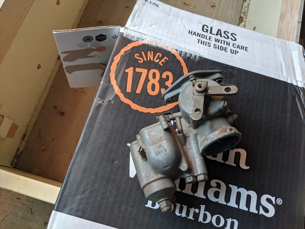

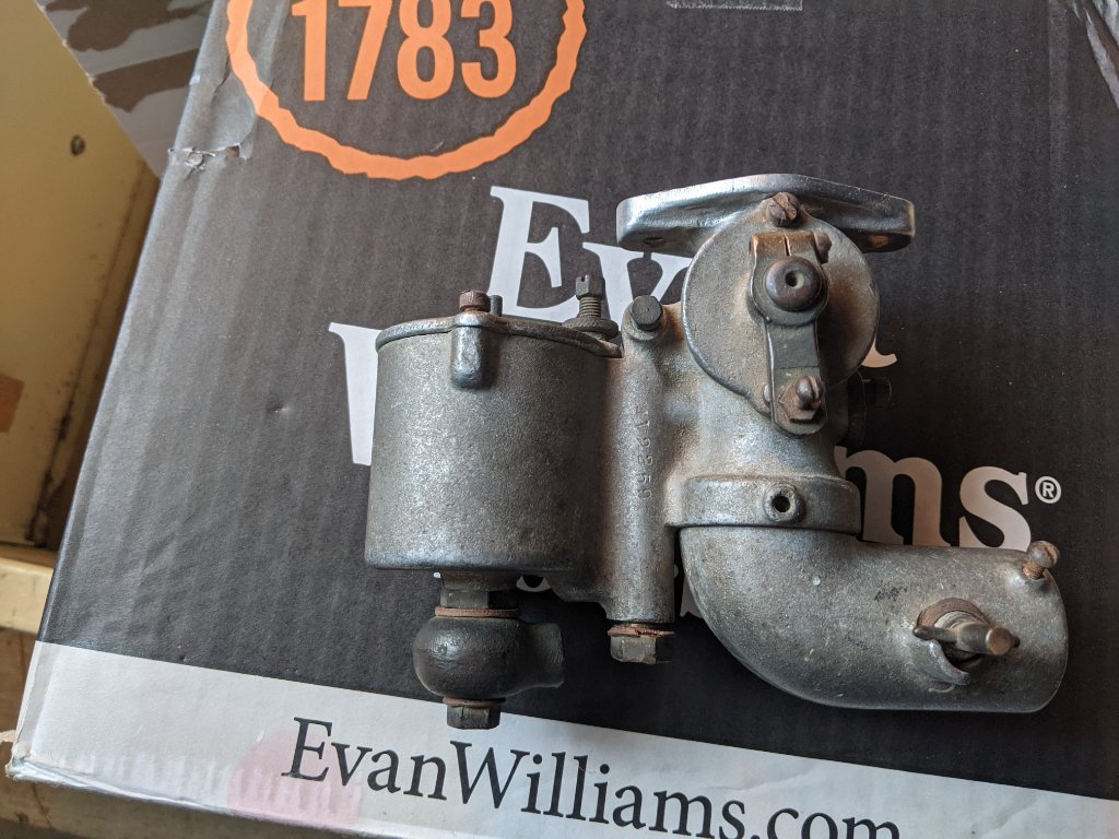

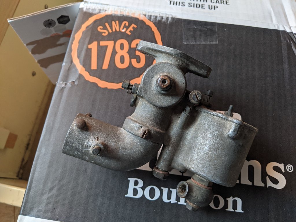

These carbs came with the speedster's I recently became caretaker of. I know nothing about Winfields other than what Mr Pharis has posted.
Look at the picture of the newer model M. Kiss of death for that one?
Any comments and information is greatly appreciated!

However, there are two very different "era" Winfields. The updraft model T era carburetors are great! IF (big IF!) they are in good condition! However, the earlier era updraft carburetors had poor material choice and very often the unstable pot metals have resulted in material breakdown. I can see the stages of that around the bolt holes in one of your photos. If it hasn't progressed too far? It might be possible to file and fit pieces, stabilize some parts with epoxy, and make one usable for awhile.
Frankly, I have never had one because I never found one decent enough that I could afford to buy. The ones that are really good are usually not for sale. And most of the ones I have seen for sale were way too far gone!
What you show looks much better than most, and may well be worth trying to use!

The one with the horn is an aluminum V the other a M. Both are absolute junk and you should mail them to me. Not knowing the size (A,B,C,D etc) you can't judge value as well. I would be surprised if they couldn't be put back into service. Unfortunately for you it appears from the photos that the I would not be surprised if some internal parts were missing on the V and the M was probably put on a shelf due to the cracks.

The V is a size 4 (1” nominal) as seen in the serial number prefix “4V”. The V/H series carbs are aluminum, and so tend to survive better than their pot metal counterparts. All barrel valve carbs tend to wear at the barrel, causing air leakage and poor idling. I had the very same carb in my ol roadster and was very happy with it… after I made an oversized barrel and cured the leaks!
The Model M is a size “B” (1-1/4” nominal) as seen in the casting number on the bowl and also the serial number. Same barrel problems as described above, but with the additional pot metal problems. Most common failures are the float bowl covers break apart into pieces, and the choke elbow flange breaks off at the set screws. Mounting flanges also tend to warp.
Based on the pics, I would perform a bit of triage on the M, and run em!
