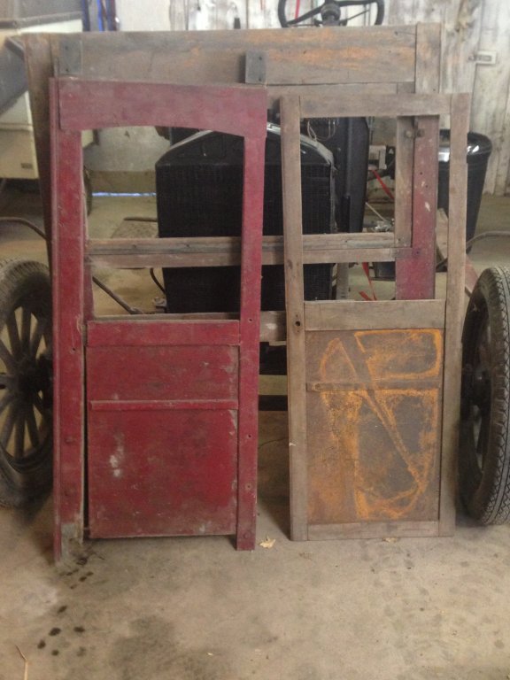

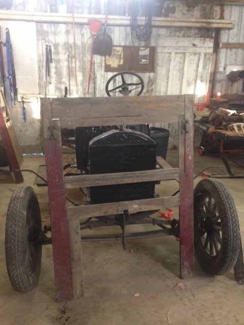

My cab was apart and rotted. I pieced it together for photos. After research and alot of help from forum members, I had a plan.
The bed was complete but in bad shape also.

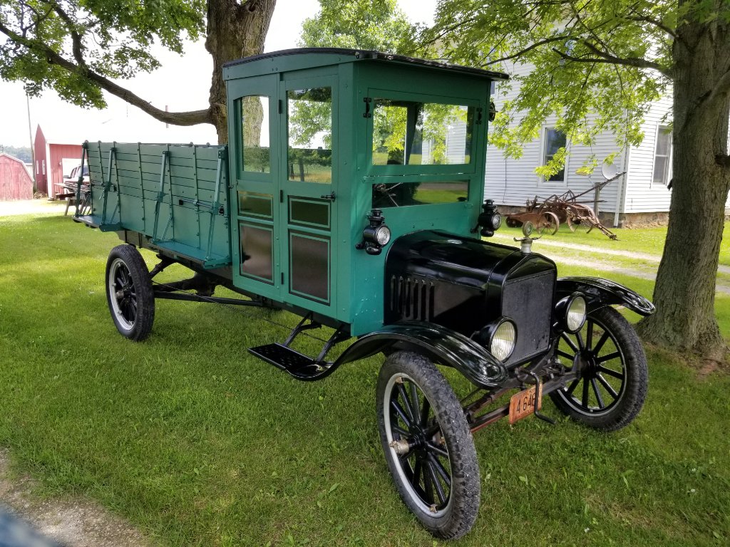

After 2 years and many enjoyable hours the 23 TT with Martin- Parry cab and American 8in1 convertible truck body made by the Ameican Wagon Company came together. since photo I made and installed rear fenders. It has 5:1 gears in rear and Chicago 3 speed. Hassler shocks out front and soon to have Hassler's in the rear. Also sporting and Apco explosion proof muffler with built in cut out.
The knowledge on this forum is great. I could never have done this truck without their help. Yes I done the work but used their knowledge. Its great your truck is a family owned project. Take your time, ask lots of questions and enjoy the process. Some photos would be great to see.

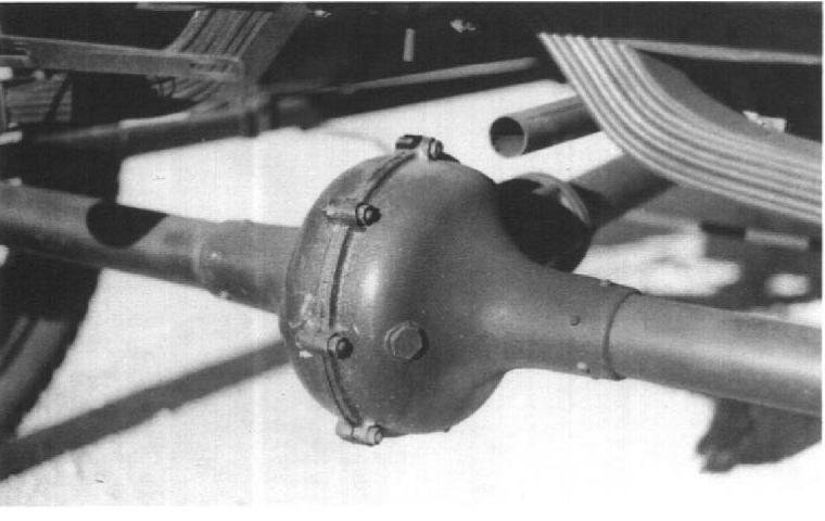

Ford Model T Car rear axle generally looks similar to the photo below:

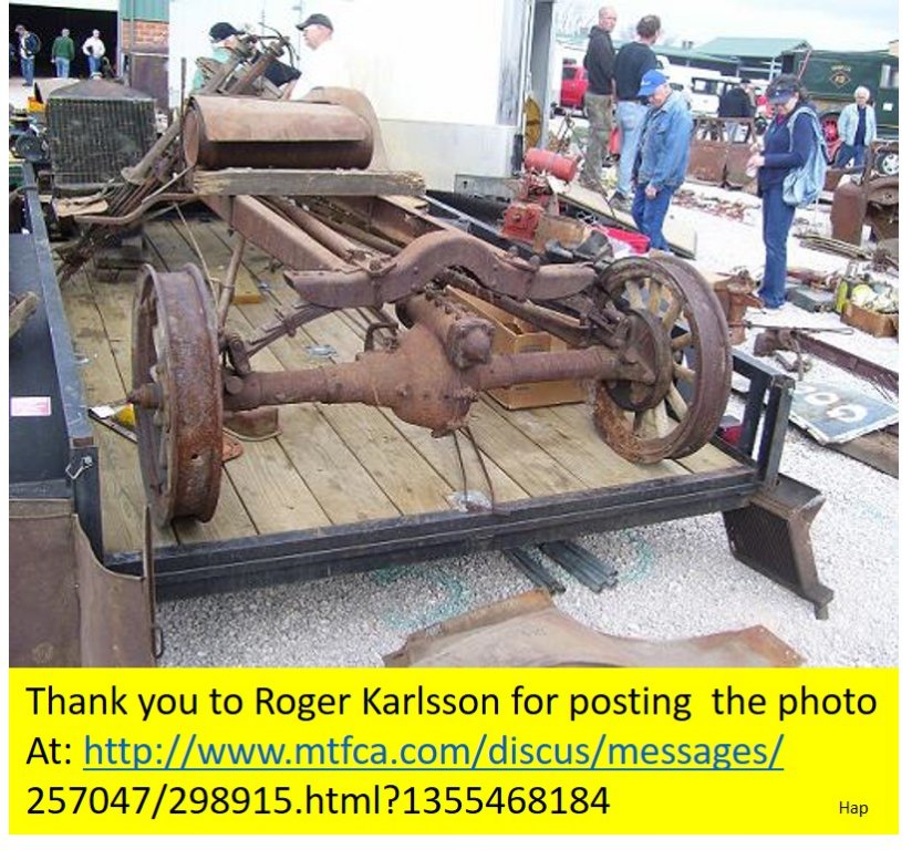

Ford Model T Ton truck rear axle generally looks similar to the photo below note this one has an accessory Ruckstell rear axle that adds a fatter looking half to the USA driver's side of the rear axle. Note the drive shaft come into the top of the rear axle house and that is called a worm drive rear axle.
