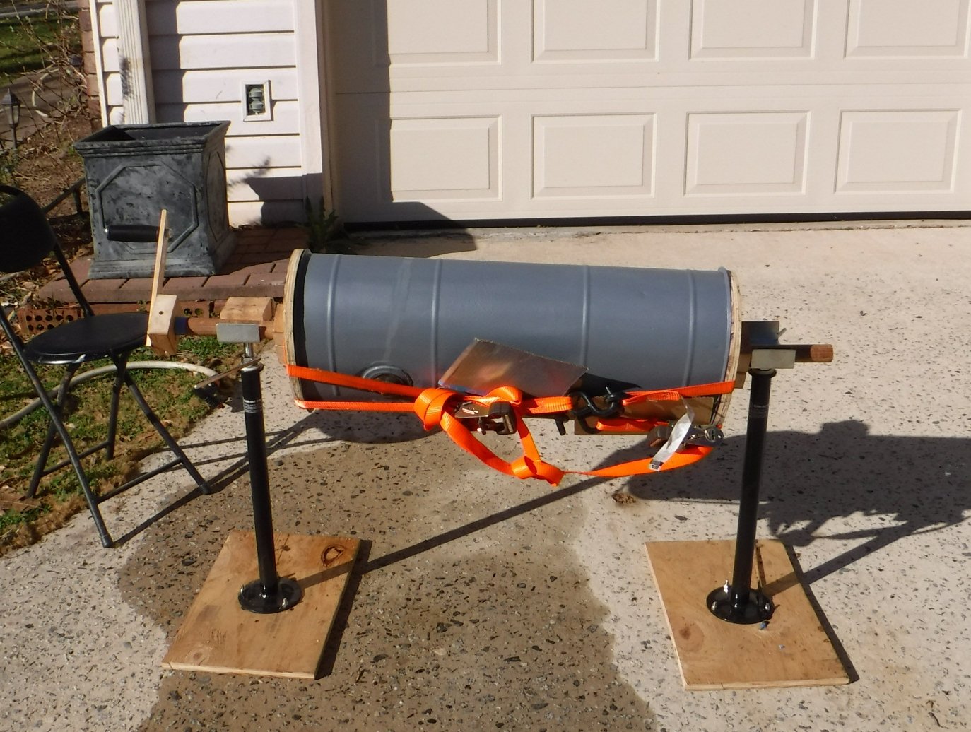

I used the pea gravel method with water in a homemade rig. Did this for about half an hour changing which side was uphill periodically so the gravel would work back and forth in the tank. After I finished I flushed with water and made sure all the gravel was out. After it dried for about a week I used one of the tank re-lineing kits to coat and seal the insides. I can't remember who the seller was but it was one of those 2 part coatings made to handle today's ethanol.

Jim in GA, is that the tank I sent you ?
Looks like it cleaned up nice.
