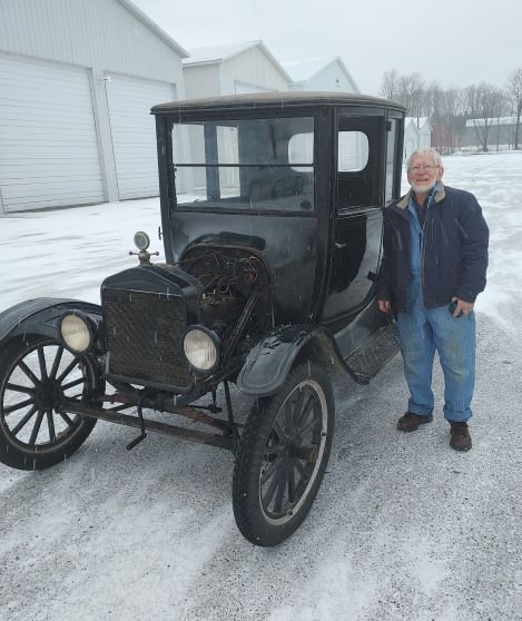

Success! Drained the oil and poured in parts cleaner fluid. Hand cranked awhile, drained and refilled with engine oil. With a rear wheel jacked up and the engine running, worked the pedals until neutral acted normal for a T. Was able to push it out of the garage without the engine spinning and drove it around the parking lot. The owner is thrilled. Thanks for all the help.

Beautiful little coupe, I like that BIG motometer! Glad you figgurd it out.

Scott, you have no idea how close you are to the truth. This guy had a model T coupe when he was a kid in the 1950's, too young to sign the paperwork so it was in his dads name. His dad sold the car a few years later, against the wishes of the son, and that was the end of his Model T ownership. That is until, at 87 years old, he thought about finding a T like he had as a kid. He found one locally, just like how he remembered his. 1920, made in Canada, same seat cover, same wood repair to the trunk... and the bill of sale from the 1950's with his fathers name and signature! Reunited after 70 years.
He bought it a couple of months ago in non-running condition. I worked on the mechanicals and Ron P. helped with the coils and electrical, and today we were able to drive it around in the parking lot. Back in the 1950's it had a Ruckstell axle, but now it has a standard rear end that is shot. I will rebuild a rear end for him but for the effort I would prefer a better core to start with. Anyone in Northern Michigan that might have a decent small drum rear end core for a rebuild please let me know.
