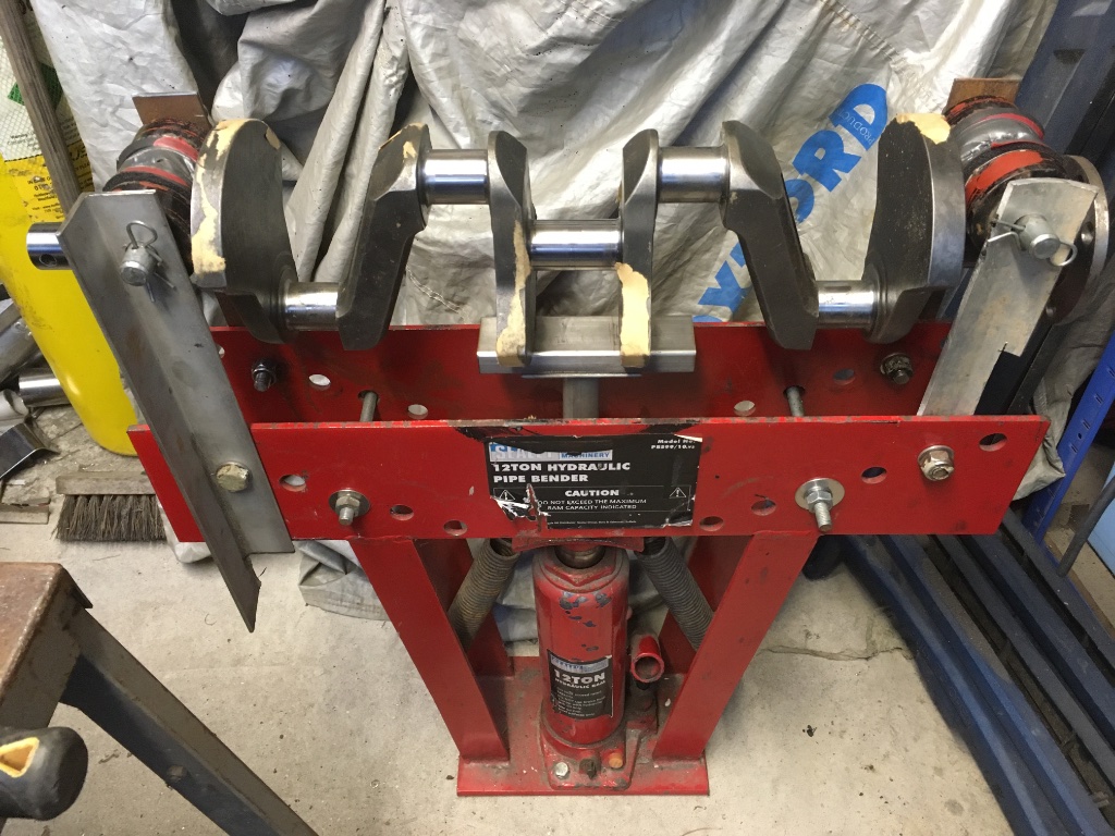

I am not in the habit of volunteering others to provide guidance, but I think this is an excellent time to sent an email to a couple of our well known and respected engine rebuilders on the forum and ask for their opinion/experience/advice.
I personally have straightened FORD cranks which were out by even more than that but will NOT advise anyone to try the same, much less on a new SCAT crank which is under any kind of implied warrantee.
So, to be clear, the only advice I'm offering is that you reach out and contact folks who do this stuff all the time and likely have experience with this sort of thing.
Any other advice you receive on the Forum, from even the most generous and well-meaning folks should be very carefully weighed before acting on said advice, lest you back yourself into a corner and end up with a very expensive paperweight. Right now, it's a paperweight, but not of your own making and may have some sort of recourse or mitigation available to you...go off on your own, and you will clearly "own" the problem.

In addition to micrometer measurements, vee blocks and a dial indicator would give a better indication of the condition of the journal surfaces.

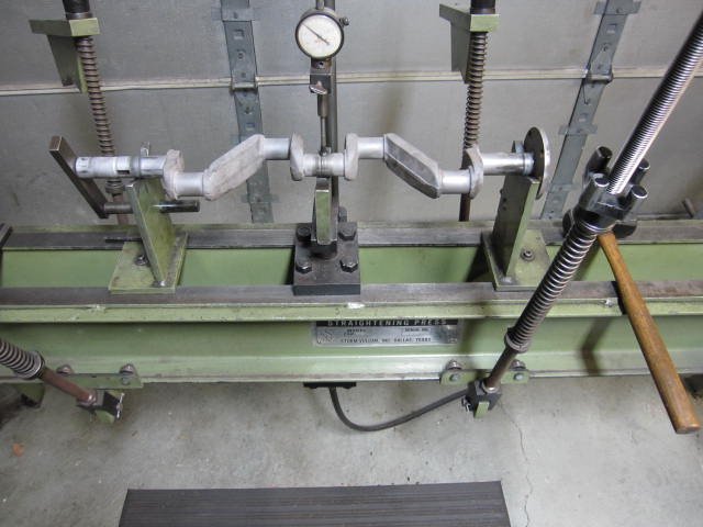

So if I’m reading this right you are getting a dial indicator reading of.004”. So this translates into actually.002” of bend. Laying flat for that length of time would easily cause this. Personally I would just use it as that amount of deflection would not concern me. I’ve been building T engines for almost 50 years and some really high performance ones!
- Posts: 4694
Re: Bent Scat crankshaft
Be careful of trying to straighten the crank. You MUST find someone familiar with the process and trustworthy. I once had a crank with no need to be turned but took it to a shop to be magnafluxed for cracks. They told me there were no cracks but needed to be straightened. I asked them if they had the equipment to straighten it and was told yes. After they worked on it, I took it to our local bearing pouring shop and they miked the crank and found the mains 50 thousandth under and the rods 30 under. Apparently all they did was turn the bearings until they all lined up! That was when I installed a SKAT crank and have had no problems with it. I then took my old crank to an auction with our local club and I labeled it and what size the journals were. Someone actually bought it. I don't remember whom nor whether or not they had trouble with it or ever used it?

I have straightened several cranks over the years. Nothing wrong in the way Robert has determined the run out on his new crank, the fact is it is out. over 50 years of engine re-building and machining, I would not except that amount of run out, engine engineering books on specs will give you .0025" at the max, less is what one would be striving for.

However the crank could be straightened but I would wait to hear back from Lang's, Have you tried directly contacting former owner of SCAT?
Tom Lieb <tlieb@ScatEnterprises.com>
Problem with straightening your crank is they may have ground it with too much force on center main causing the out of round.
If the crank is bent from being dropped then by using the setup I have shown above, you may be able to peen it back as you mentioned other machine shop.
With so little off they could use a brass peen and wouldn't cause damage to crank rather than regrinding. But Time is money.

Bob, it is NOT my intent to upset you nor argue with you, but if your "engineering shop" has a normal protocol to straighten your crank and then re-grind it, ...IMO you really need to find a shop that is knowledgeable about, and has proper experience on vintage crankshafts. As I mentioned above, a press is not how you would straighten that SCAT crankshaft. It is to be done with peening, ...which does not damage the surface.BobUkPipedream wrote: ↑Thu Dec 01, 2022 4:06 pm
I have now visited an engineering shop and they concur that the crank is bent by 4 thou. Straightening it will cost money and as their normal process would be to finish it off with a grind, that option is not open to me as my babbits are standard. So although I could convince them to do it the press way and leave it at that, they are less than impressed with that. If I do ask them to do it, I will be taking a huge risk (given how much the crank cost) and will be out of pocket and will also be out of warranty.
Also, with the comment about Nitriding, to be clear to others who may have the same misunderstanding, the surface hardening is done on many crankshafts that survive re-grinding and post-peening to straighten without damage. Therefore straightening a crankshaft (-either pre-grinding or post-grinding) that has been surface hardened has no ill affect whatsoever as long as the process was properly done.
As someone with experience in straightening crankshafts, I do not feel there is any risk involved however based on your comments both above and in your video, do you think at this point it would be best for you to ship this crankshaft back to Langs and seek some sort of a refund. At that point, I would be happy to either purchase your crank from Don or correct it for him. Likely there are other T engine shops that would do the same.
Thanks Scott,
Just in case future people have a similar problem and wonder how I did it, here is the final video which I hesitate to post as it is not very good and I feel quite self conscious…
https://www.youtube.com/watch?v=F6DsNxP9hio
if people prefer not to click on YouTube, then I used a modified pipe bender. I had planned to buy a hydraulic press, but just as I went to click ‘buy’ I realised that it would struggle to fit in the sort of press I could afford as the length would be difficult to accommodate. So I added some bars to my pipe bender so the crank would sit above it:
My pipe bender is 12 ton, but I think I only used a very small portion of that capacity - perhaps as small as 1-2 tons. I did it in three hits. The first one shifted it 1 thou, 2nd time it was about another thou and the the final time, it went to just about perfect. People talked about elasticity of the Model T cranks, I am not sure the Scat has the same elastic nature, but I have measured it yesterday a few days after I straightened it and it is still where I left it at under half a thou from straight (0.0005 that is), so it is stable. Now I am just waiting on my con rods and then it will be reassembly time.
