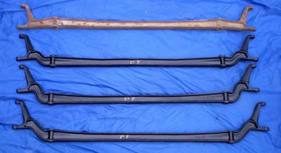

So a few years back I had a local guy come here looking for a T front axle. Said he is going to stretch/bend it for lowering. I asked him to do one for me too. He agreed and I sent him off with two axles and some other stuff to even out the deal. "be back in a week with your part". He took the payment and the axles and vanished. Fast forward a few years and enter my current project, building a brass speedster on camera to pass along what I have learned over the last 50 years. Now I really want that lowered axle I paid for.
Does anyone know someone in the "south of boston" area that has the ability to stretch one of these? I'd like to film the process as part of my build series if posssible.

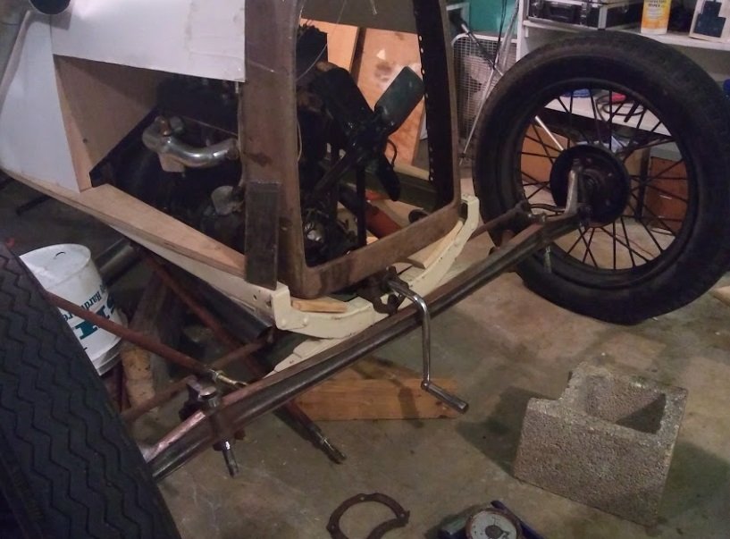

Re: Front Axel

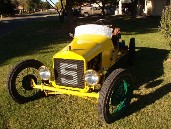

Anyone that has seen my speedster knows I have no trouble under slinging a model T without a drop axle. What I'm
looking for is some one that can put a smile in my T axle so I have room to put a hand crank in so I can hand crank
the engine. Is any one west of the Mississippi south of the Mason Dixon line that can do that?

Re: Front Axel

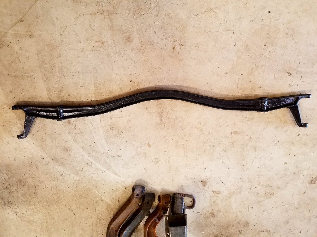

Correct, once you get around the 5-6" point a crank gets sketchy. If memory serves Sid does a dip but it is large (long) and doesnt look as nice as a short one. If you come across someone doing a short more aggressive drop let me know.

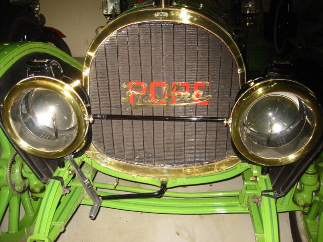

Re: Front Axel
Never said it would lower the car, it isn't supposed to. When you lower a car enough and try to run a crank the axle gets in the way so a dip is placed in the axle to clear the crank. This is noticeable on Many other manufactures in the early teens.TheSpeedsterProject wrote: ↑Mon Nov 28, 2022 7:31 pmI see no way that axle in your photo will lower the car. It's upside down but still - ????

To clarify what Chad wrote above- this is a problem only when the axle is used with a suicide front end arrangement - when the front spring mount is moved upward to create the drop- this method drops the centerline of the crankshaft to where it intersects a stock height front axle, which causes the hand crank to hit the axle. The purpose of the "dip" is to get the axle center below the hand crank.

A stock T axle can impact the crank, when installed in a non-stock fashion, which was whole point of showing the "dipped" axle.TheSpeedsterProject wrote: ↑Wed Nov 30, 2022 10:21 amagreed. I see no way a stock T axle impacts the crank - and hey - there is a post with your name on it near the top of the list today.... Someone wants to talk to you.Dan McEachern wrote: ↑Tue Nov 29, 2022 6:02 pmTo clarify what Chad wrote above- this is a problem only when the axle is used with a suicide front end arrangement - when the front spring mount is moved upward to create the drop- this method drops the centerline of the crankshaft to where it intersects a stock height front axle, which causes the hand crank to hit the axle. The purpose of the "dip" is to get the axle center below the hand crank.

- Posts: 6581
Re: Front Axel
I copied a picture from a previous posting assuming it's the one needing a smile on your axle. Since the axle looks like its pushed a bit ahead of the cross member do you envision any problems with the length of the hand crank clearing the axleCraig Leach wrote: ↑Mon Nov 28, 2022 12:55 amAnyone that has seen my speedster knows I have no trouble under slinging a model T without a drop axle. What I'm
Craig.

Re: Front Axel

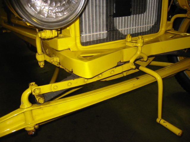

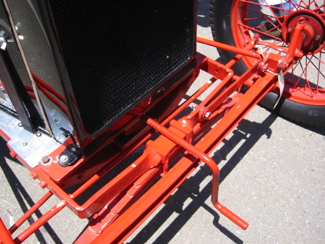

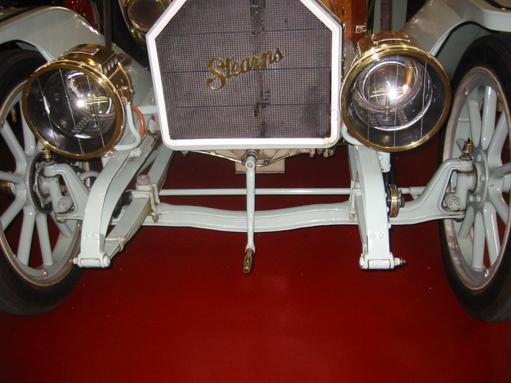

Slid a crank in for checking Note where it has knocked the paint off A good speedbump . . . Note dip to avoid crank Another factory dipTheSpeedsterProject wrote: ↑Wed Nov 30, 2022 10:21 amagreed. I see no way a stock T axle impacts the crank - and hey - there is a post with your name on it near the top of the list today.... Someone wants to talk to you.Dan McEachern wrote: ↑Tue Nov 29, 2022 6:02 pmTo clarify what Chad wrote above- this is a problem only when the axle is used with a suicide front end arrangement - when the front spring mount is moved upward to create the drop- this method drops the centerline of the crankshaft to where it intersects a stock height front axle, which causes the hand crank to hit the axle. The purpose of the "dip" is to get the axle center below the hand crank.
