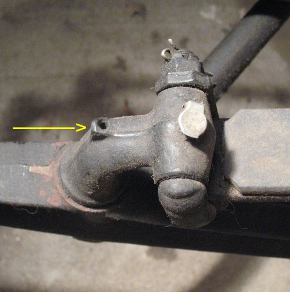

Allan forgot the steering case at the steering wheel needs to be tight in the column
Also if this is a new to me car make sure front axle in right according to the perch boss to rear of the car just fixed a T with them in backwards

As mentioned above the shackles could be in backwards the left side has the odd number and the right has the even number. You can check the parts book for the correct numbers. You can't tell by looking at them. The easiest fix is to turn the axle around.

- Posts: 7342
Re: Severe front end shake? Shackles?
I think David means perches backwards, not shackles. Yes, you can tell right from left by looking at them.
The casting boss (see arrow) should be toward the rear.
Several people have mentioned shackles as possibly being the problem. Specifically, a stuck shackle can cause the death wobble. Other parts of the steering system being worn loose can also be part of the problem. One worn part may not do it, but several can add up to trouble.
