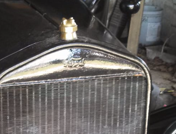

Post by cramagraham » Mon Nov 28, 2022 10:05 am

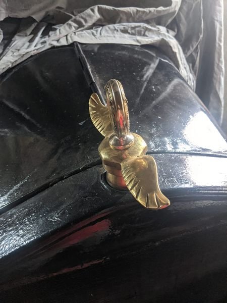

I bought one of those fancy hood ornaments and the thing won't screw in right. I have tried adding some rubber rings aka gaskets to supplement it but it still won't fasten correctly. When i screw it on it tightens north south not east west. . . regardless of the gaskets. I have come to the conclusion that to make this work I probably will need a new filler neck. The question is: Can this even be done? I don't see any bolts holding it on. It looks like its pressed on or maybe welded. I am not super technical with this stuff. Any knowledge on this?

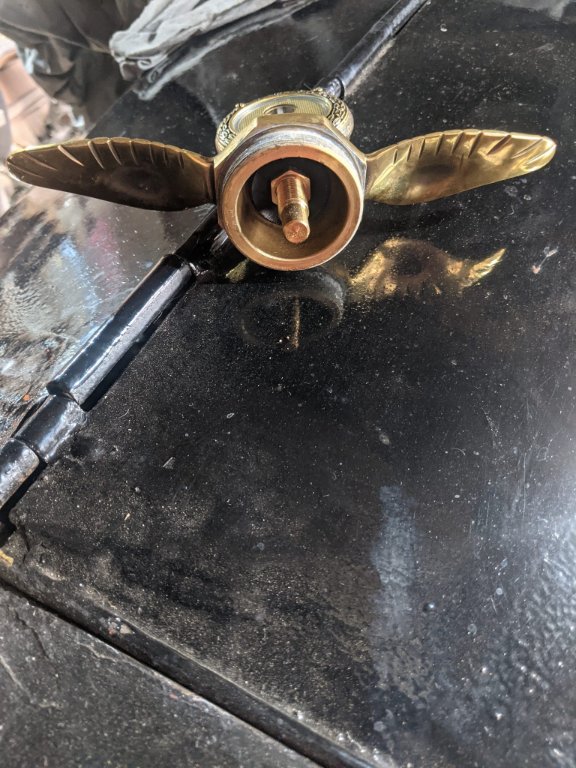

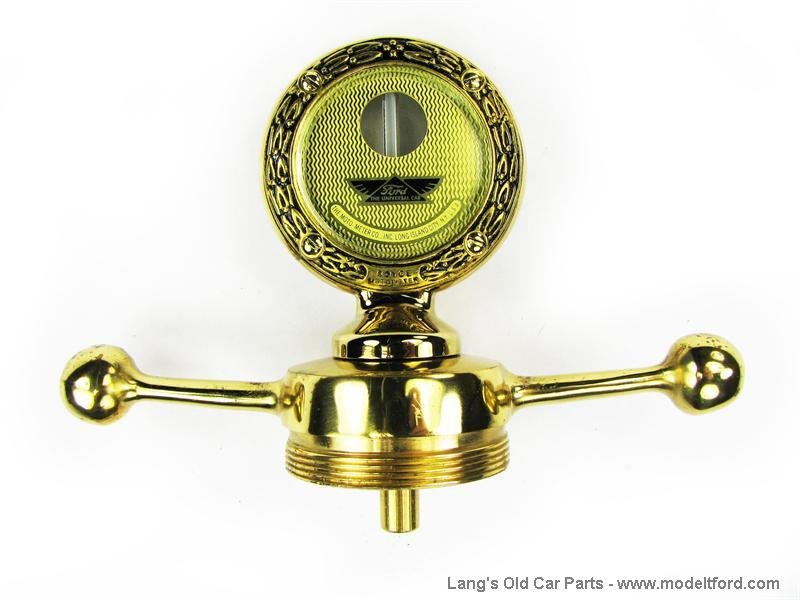

Its this thing here

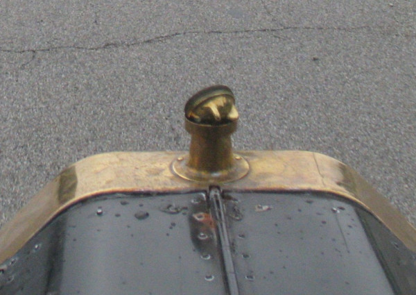

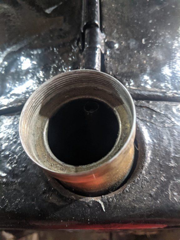

See picture below. North south meaning when i am looking at the radiator from the front the wings are pointing to me and the windshield instead of pointing to the front wheels. That is where is screws to. I wish i had better pictures but i am at work.
Radiator is original yes. i attached a pic of the moto meter that we bought for it.

I know exactly what you're putting on and I know exactly what you mean by north/south, but thank you for being explicit.
the thick gaskets I'm trying to lead you to will solve your problem. Removing and replacing the neck of the radiator will not.
Call Langs...tell them your trouble, and they will sell you the gasket or gaskets I've recommended. Problem solved.

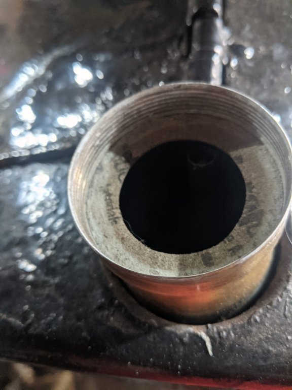

A close up picture of the threads inside your filler neck may be helpful. They should look just like the threads on the new cap.

I understood the direction North/South & East/West but was trying to confirm if the movement was in the new cap movement in the water neck and not the water neck flexing.
Some previous discussion mention that original necks were pressed in (some Brassworks too). And pros & cons of ornaments

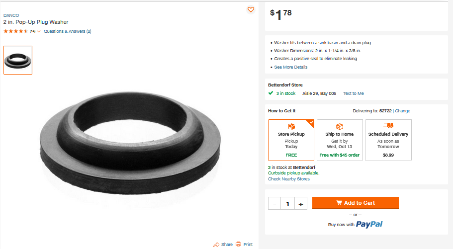

This is the gasket that Lang's mentioned that hardware stores sell - 2inch pop-up plug washer

On my screen the view of the radiator neck in the first photo appears to be such that the top of the neck is angled to the passenger side as if it has been knocked or bent in that direction. It certainly is not centered in the shroud. If it has been knocked/bent, it's also possible that the neck is out of round, and that could be preventing full thread engagement of any radiator cap or appliance. If you have added the recommended gaskets to no avail, the problem might be lack of full thread engagement, the new 'cap' may not screw down into the neck sufficiently to make contact with the gasket(s). Again a closer view inside the neck would help determine if this is the issue. And if the neck is out of round, bent or damaged, be very careful in straightening it, you can easily cause more damage than you correct. And if the bent neck is an optical illusion, don't mess with it or the shroud. If the dogbone is horizontal with the proper thread engagement, the neck ok, and adding gaskets should be sufficient to get tight while pointing 'true North'.
Good luck, jb

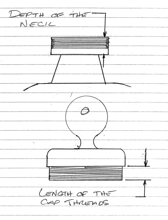

Post by Jerry VanOoteghem » Tue Nov 29, 2022 2:59 pm
Oh my gosh... His cap tightens up 90 degrees from where it should be. The threads are fine, or it wouldn't tighten at all. He needs more washers under the cap.
Brian,
Measure the depth of your radiator neck, from the top edge, down to the shoulder where the gasket sits. Measure it with no gasket in place. Then measure the length of the cap threads. I'll bet the neck is way deeper than the cap threads are long. The difference in the 2 lengths, is the minimum thickness that your gasket stack should be. In fact, the stack should be just a bit thicker.

Post by cramagraham » Wed Nov 30, 2022 2:22 pm
Holy cow I never thought of this. This is probably it exactly. What should I use around the cap threads to block them?

Nothing on the threads. Your gasket/spacer will keep any fluids from weeping up the threads. This is an open, no pressure system.

Here are some more pictures and hopefully these will help.
Posts: 8643
Re: 1918 Ford Model T Filler Neck questions
Post by TXGOAT2 » Wed Nov 30, 2022 2:40 pm
If you put enough shims under it, you can make it snug up anywhere you want it to.

Post by cramagraham » Thu Dec 01, 2022 12:23 pm
Allan wrote:
Mon Nov 28, 2022 5:33 pm
Different thickness gaskets will allow different orientation of the dogbone ears.
If the dogbone is bottoming out on the base when you screw it in, you could also machine/sand/file a little off the base of the dogbone thread, allowing it to screw a little further round.
Brassworks radiator necks are soldered in place. I know this because I had to shift one for the radiator shell to fit. Original radiators are different. The top plate has a flange bent upwards into the base of the radiator neck. When the neck is fitted, the flange is bent down to capture the rolled-in base of the neck. Thus the joint has a mechanical element to it, which is then sealed by soldering. This makes a joint which will support more weight of an accessory cap better than one which relies solely on the solder joint.
Did you see my added pictures? The problem seems that it only bites on the neck threads when its near the bottom of the neck.

Post by Mark Nunn » Thu Dec 01, 2022 1:20 pm
Does your neck have a hairline crack that would let it expand rather than grasping threads? My old radiator had cracks and was "fixed" by someone with a standard hose clamp.
Posts: 4472
Post by Jerry VanOoteghem » Thu Dec 01, 2022 2:47 pm
I'm not sure that the pictures really show that. Does the regular T radiator cap do the same thing? Can you show a good picture of the moto meter threads?
Posts: 6800
Post by Scott_Conger » Thu Dec 01, 2022 5:30 pm
You have a paper gasket in there.
You'd need like 20 of those to make the dogbone seat on it
the Langs rubber gasket is, perhaps, 1/8" thick
either 1 or two of those langs gaskets (probably 1) will snug the dogbone long before it bottoms out on the top edge of the neck
or, as I mentioned before, wrap 1, 2 or 3 wraps of teflon pipe tape on the dogbone threads which will physically "enlarge" the threads and will be an interference fit all the way to where you want to leave it facing...meaning 3/4 of a turn shy of where it is seating at now

Yeah my dad was supposed to show that in the picture but he failed to do so. The mere fact that he was able to use his smart phone and take pictures and send them to me was mind blowing in itself...lol.
