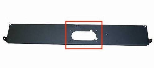

Who would have a cutting plot for the Magnetometer and Ammeter instruments? see attach the picture.
I bought a TM-200 dashrail and I want to convert it to a TM-201 because I can't find it.

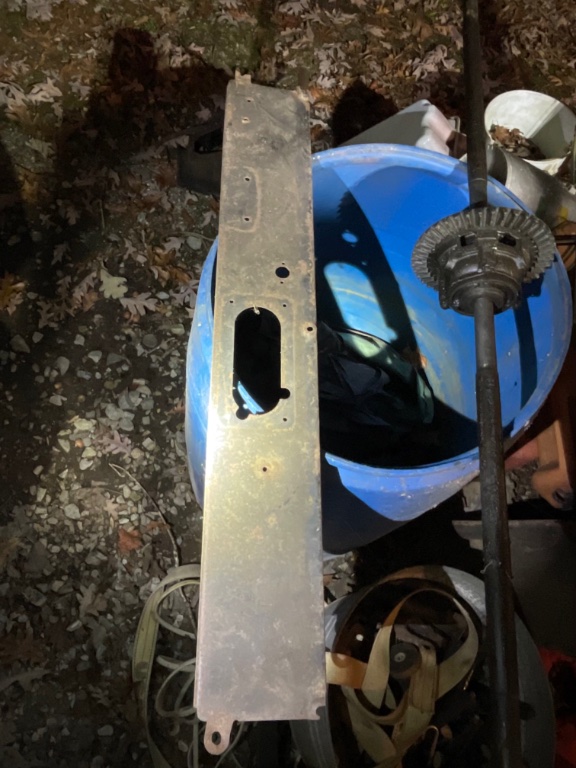

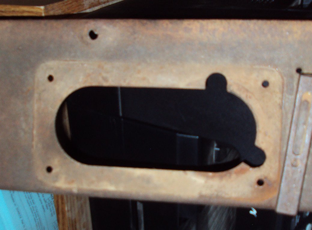

Is this the one you need?

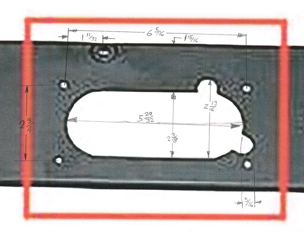

Post by Rich Eagle » Mon Nov 28, 2022 6:28 pm
This is what I measured on mine. I hope it is accurate enough.

Post by Sanary22FT » Tue Nov 29, 2022 6:51 am
Thanks a lot
