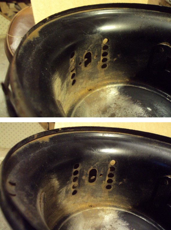

Re: Headlight Restoration
This lamp has its original paint and even a run I believe was from the dipping process. It looks like it was glossy to me.
I don't doubt you for a second. Other than unpainted primer in small select spots that were covered with wood, I have never seen any evidence for anything other than what could be described as "glossy paint" on any single part of a T. Black or otherwise.
