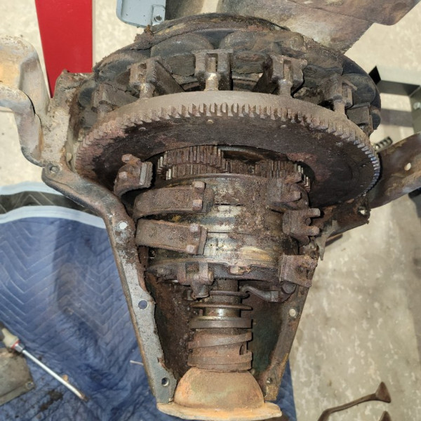

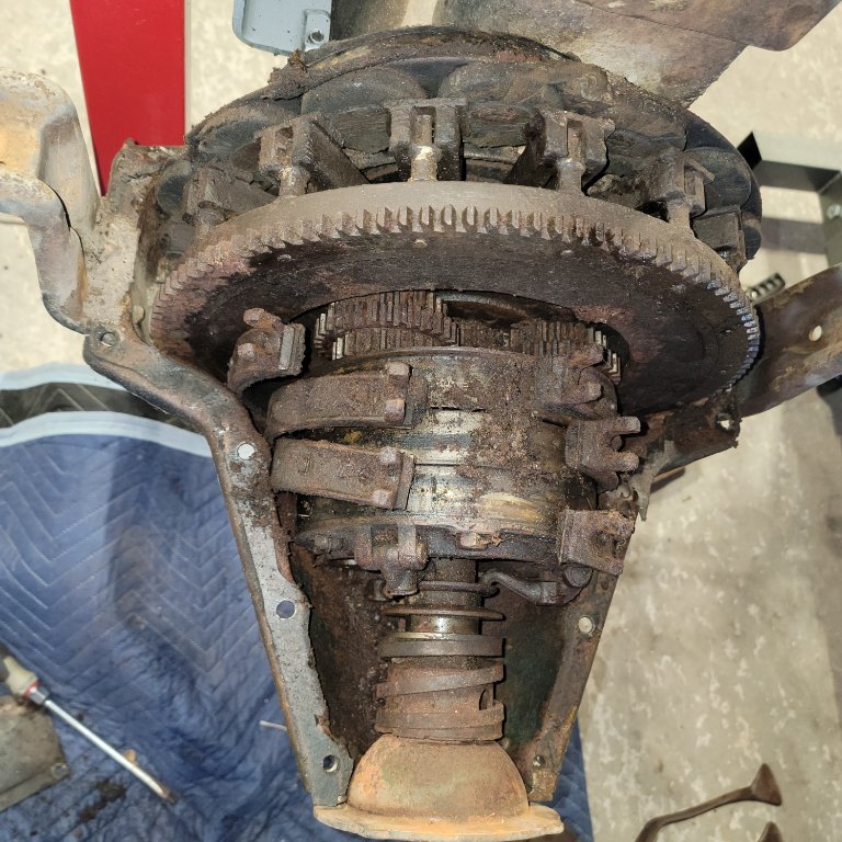

This is a 19 engine in a 25 roadster. The goal is to the current block with a 25 and put it back in the roadster with a correct 25 bed (Yes I have the bed).
I got the hogs head off today and I am some what unsure of the next steps. This is what I am thinking:
1) remove oil pan to get complete access to the transmission.
2) Take apart the transmission.
3) Use electrolysis to remove rust. The engine/transmission was a major mouse nest over the years.
4) ***** This is where I need help. What should be replaced no matter what, what should be inspected and how.
Any help or input is considered valuable to me.
AgaIn, Thanks for your help.

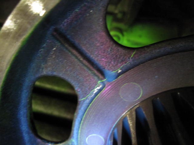

I tear every thing down & soak individually in carb cleaner. Then bead blast everything. Do not bead blast anything that moves, like the 3 fingers of the drive plate or bushings. Manually clean with a wire wheel. Wash the blasted parts in solvent. In the process any drum cracks will show themselves. Debur gears & polish shafts. Now clean, you can determine bushing wear with feeler gauges.

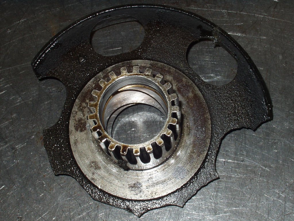

The work of taking apart and putting back together should not be wasted. Between taking and putting should be looking. Inspect all parts carefully and see if anything needs replacing. Pedal ramps are often worn badly. Original reverse drums are more often cracked than not. Magnets are sometimes cracked. If the bands could use new linings,it's easiest while they're out. While you have it apart you might as well charge the magnets. How is the coil ring? If the insulation is deteriorated and brittle the coil ring should be replaced or rewound. There's a lot to do, and it may seem to take forever, but it ain't rocket surgery.

The drums may be cracked along with magnets and the triple gears may be toast along with the pins.

Diesel fuel put on a cleaned part and then wiped dry will reveal cracks as it will seep out of cracks. If you are not familiar or do not know to use a caliper or dial indicator it is a good time to learn. You can get both at Harbor Freight or off Amazon and not break the bank.

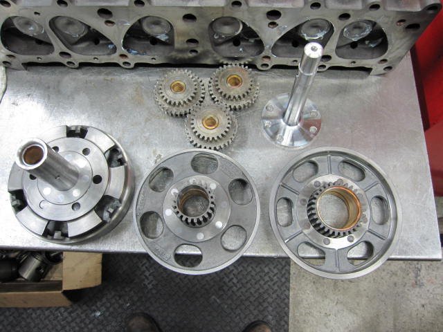

I tore into a transmission on camera, went over the process, polished the drums various ways, explained and rebuilt a hogshead, and tried electrolosis as well. Take a look --> youtube.com/@whatthedevil You want the playlist named "Model T".
