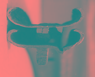

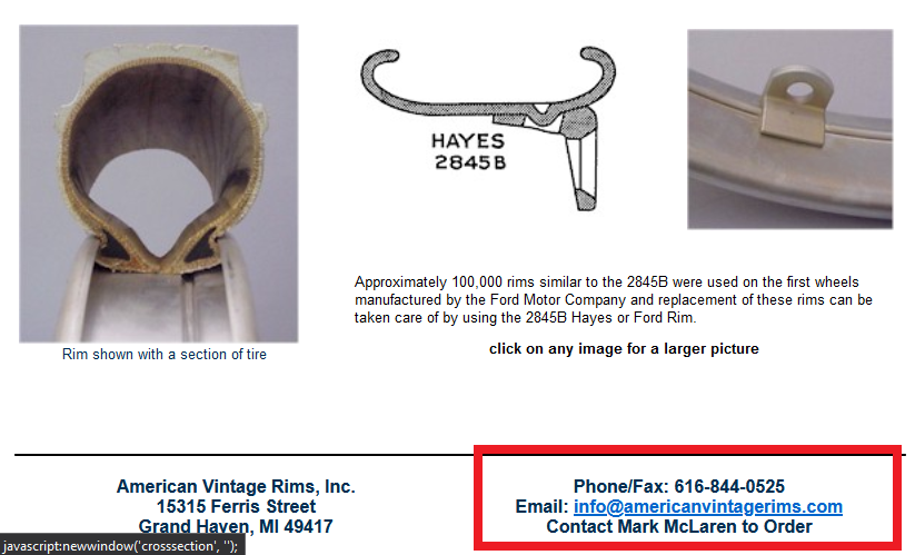

What should the cross section of that type rim look like?

Here is a photo of a Ford rim (top) and a Kelsey on the bottom.
You can see how thin and sharp (and rusty) the Ford rim is compared to the Kelsey.

Excellent comparison photo Peter. There should be no difference between the brands, but clearly one is very badly rusted thin. The problem for novice T owners is they often have no reference as to how a good rim looks. A number of times I have been told "My rims are fine". When you see them, and can show the owner what a good rim looks like, it becomes a different story.

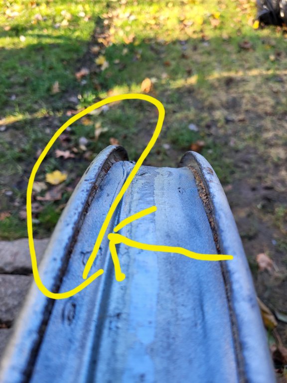

Thanks Peter for the comparsion pics! I defiantly see the difference. Im going to take the tire off this week to take a look. I decided and waiting for quotes for one new blockley tire as well as American vintage rims quote for a new rim. The plan is to slowly replace the other three rims over the next few months, in time for next years driving season.

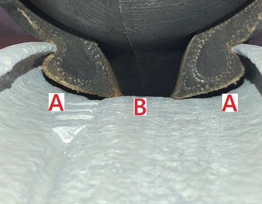

It looks to me as if the entire surface of the rim that is in contact with the tire would need to be in good condition, with its original contour intact, for best results. A rust eroded rim, besides allowing the sharp edge to cut the tire, would not give the proper support to the tire bead. If the rim's edge cuts into the bead cord, the tire is bound to fail.

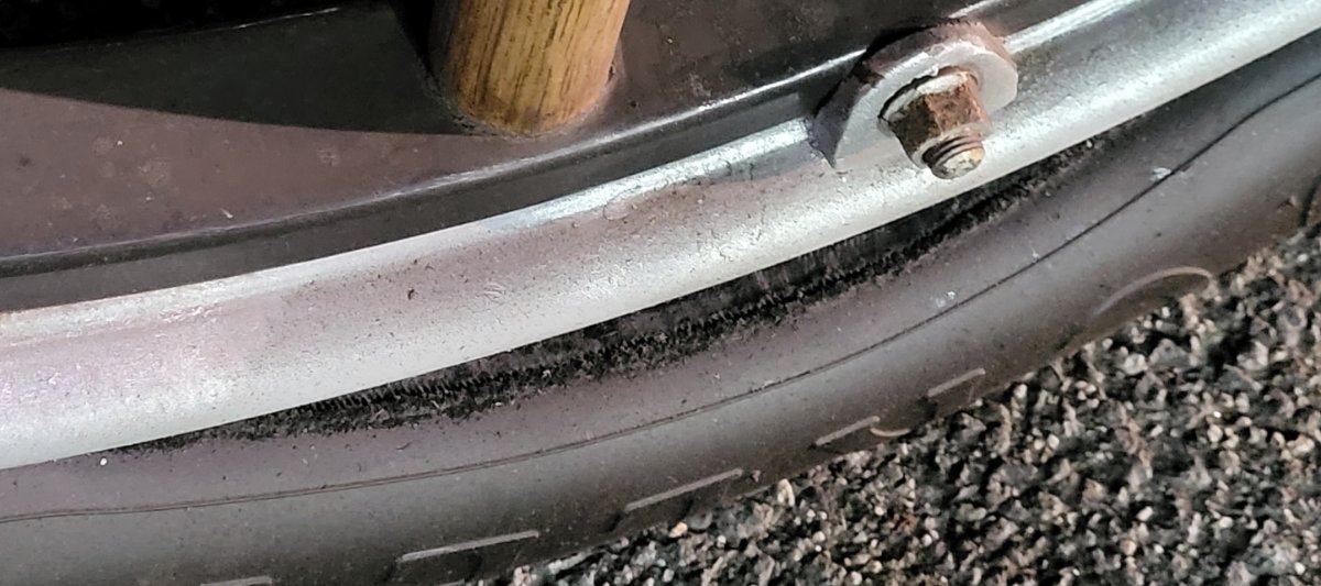

Cut bead on tire

How do the other rims look?

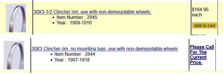

Tim, Vintage Rims, Australia, is owned by Steve Hood. He is in Kingaroy, Queensland, Phone 0429 622 208. He makes all types of rims, clinchers, split, lock rings, well based and motorcycle belt and brake rims too. My son got lucky on our recent national rally and won a $500 voucher for his choice of Steve's output. I am sure he would be keen to help, and the exchange rate will be an added help for you.

Thanks Allan.... I'm with Scott. The availability of new rims is in the same category as the availability of quality tires.... worth the extra cost. We used to have a guy right here in Michigan but no more.

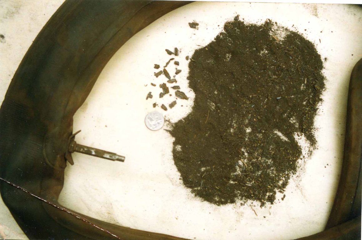

A couple of other points, I was on a tour in Wisconsin traveling with a guy when his front tire peeled off the rim as we were driving, or should I say when it peeled off several times during the day. He had ground the beaded edge so far back to get to good metal there was not enough left of the bead on the rim. You have to build it back to the same amount of metal.
The inside edge is hard to get into to paint or cover to stop rust, dipping in zinc was the guaranteed way, home DIY methods need a good method to make sure the inside (especially the underneath end) of the bead gets coated.
Also paint is not waterproof, if water is left in contact with steel for a long time it will go through the paint and the rim will still rust, that's why they put in "rust bands," tape or flaps.
Here is another problem, Years ago I purchased new non demountable wheels, They were painted and tires put on, I got a flat years later, when the tire was removed I found all the paint and primer was rattling around inside the tire. The tire was mounted onto the painted rim without a flap or band. When the car was put away after being driven in the rain (and that was lots of times) water stayed inside the rim. It can get in easy at the valve stem especially if you have original metal stems because of the stems washer holding it off the rim, there is no way of knowing as you don't remove the tire unless you have too.
Here is a photo of the amount of loose rust and paint which I cleaned out of the wheel when I took off the tire, all four wheels had about the same amount inside them. It was good hand full in each wheel. Only positive I have about the crap tires we have been stuck with for years one gets to remove the tire and see what's going on with the rim. "I hope the tire sellers don't use that as a reason why they made them so bad"
I like the idea of the rubber spray, would be better than paint.

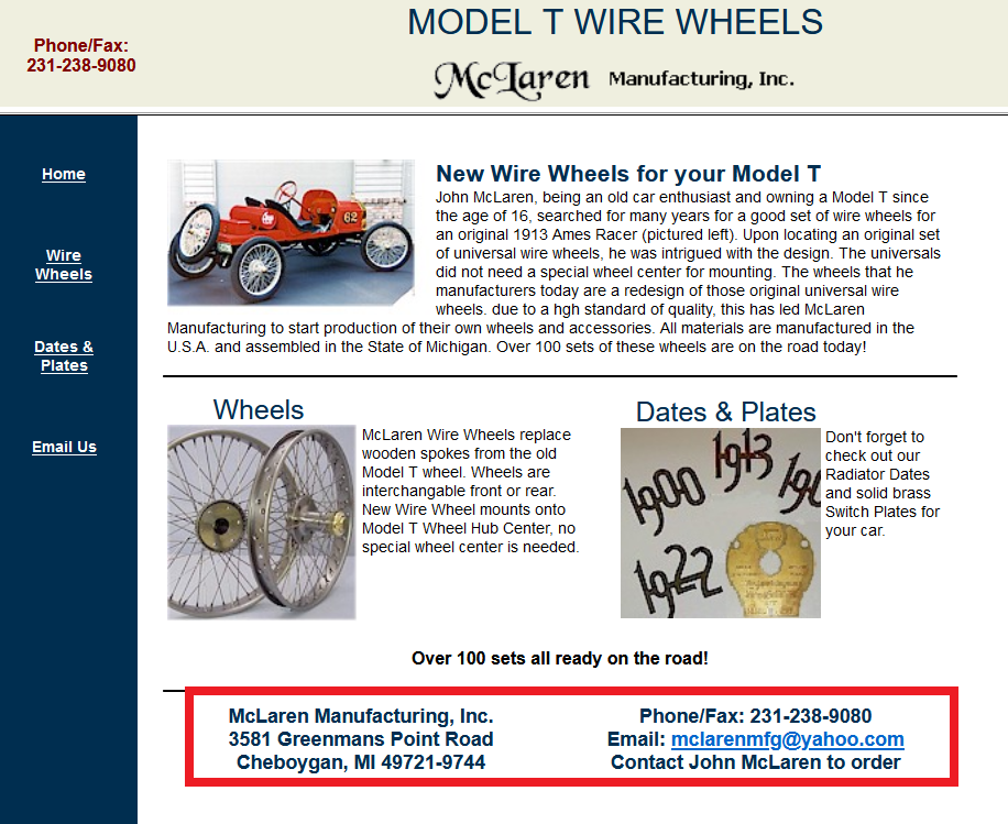

Has anyone heard of American vintage rims? Mclaren rims?

A Google search shows Vintage Rims Inc. permanently closed. I found no McLaren website, but lots of modern McLaren wheels for sale. I believe Coker used to sell clincher rims in Model T sizes, but their website shows none now.
- Posts: 6581
Re: Blockley Tires

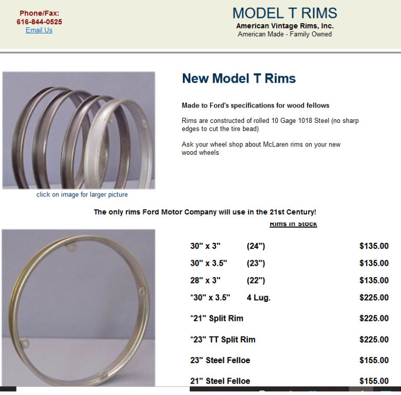

I believe that Mike Lebsack is making the wire wheels - what else ? https://www.mtfca.com/discus/messages/7 ... 1486822092
Mike Lebsack in now producing the wheels.If your interested, 319-430-4995 You can also tex to this number. Vintage Wire Wheel 802 Ryan Ct.Iowa City, Iowa 52246 He also offers a 21" speedster wheel with spinners
From the Internet
American Vintage Rims http://www.americanvintagerims.com/ --
McLaren Wire Wheels old web site no longer there http://www.mclarenmfg.com/ --
Listing in Lang's

Both of the McLarens have quit the business from what I've heard. Is Mike Lebsack just making wire wheels?

Vintage Rims New Zealand is the primary supplier for Coker Tire in recent times, and I’m assuming most other US availability as well. American Vintage Rims has not been on the map for at least a few years. John McLaren sold the McLaren Wheel business to Mike Lebsack 5-10 years ago
Mike Lebsack-Iowa
- Posts: 555
- Joined: Sun Jan 06, 2019 10:22 pm
- First Name: Mike
- Last Name: Lebsack
- * REQUIRED* Type and Year of Model Ts owned: 11Torpedo, 11 Roadster, 13 Touring, 14 Roadster, 14 Touring
- Location: Iowa
- Board Member Since: 2008
Re: Blockley Tires
Hello All,
Kevin and others are correct. I purchased only the McLaren Wire Wheel business from John McLaren 5-6 years ago. American Vintage Rim is owned by Mark McLaren, John McLaren’s son. I currently produce 30x3.5 and a limited number of 30x3.0 clincher style McLaren Wire Wheels. Lang’s carries the clincher rims which were produced by American Vintage Rims. I use the same clincher rims but do not sell the rims unless they are part of a complete McLaren Wire Wheel or an occasional Buffalo wheel that I am restoring for one of my regular customers. Thanks, Mike
