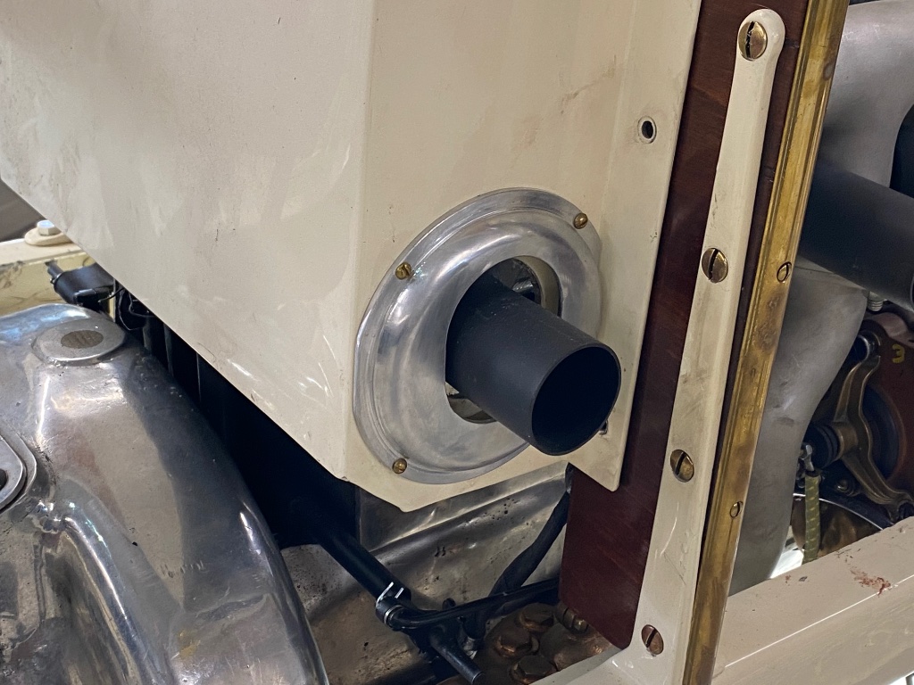

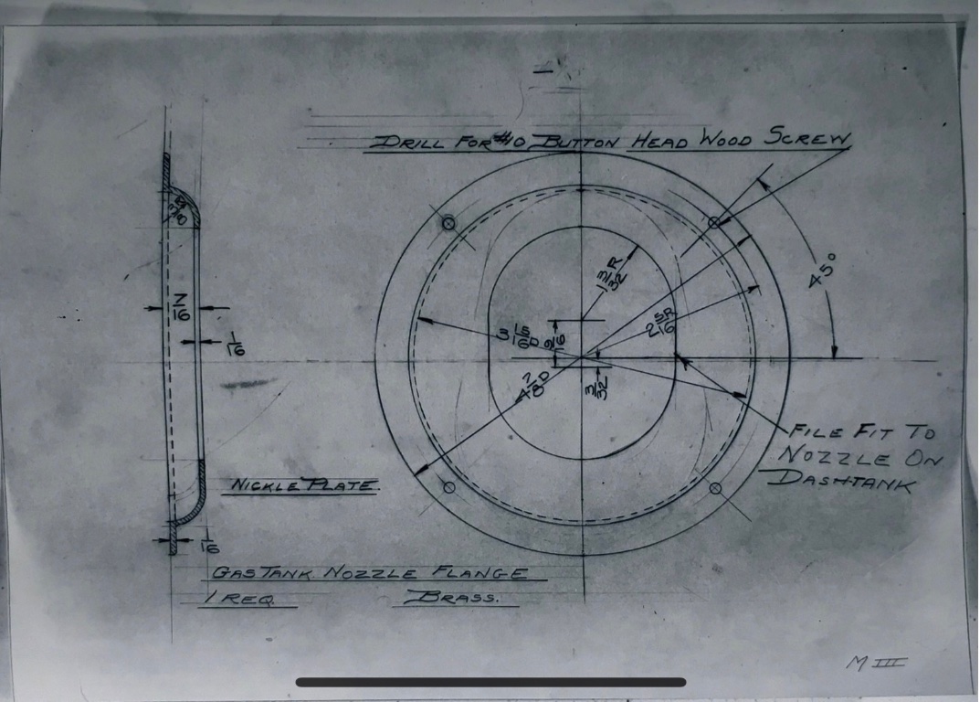

Below, one feature the Benson Library (THF) drawings show for this racer/motor (labeled “M-III”) was this bit of cosmetic “fluff,” a flange for the “dashtank” opening allowing the #4 cylinder exhaust to protrude behind the firewall. That’s one way to hide a 300 c.i. motor in a T chassis:
