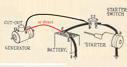

My 1914 Touring has a starter and generator. Since there is no ammeter should the wire from the generator cutout be connected directly to the battery post on the starter?

No, not the starter. What are you using for a starter switch? Depending on your starter switch, there, or directly to the battery.
- Posts: 8639
Re: Generator Cut Out Wiring
You can connect it to the battery terminal on the starter switch.
- Posts: 6581
If you wired it that way (generator to starter) the starter would continue to run once the cut out on the generator closed and electricity started to pass through the system. As others have asked - where is your starter switch? And as they suggested the ways to connect. What voltage battery are you using?fredserfass12 wrote: ↑Fri Dec 02, 2022 10:18 amMy 1914 Touring has a starter and generator. Since there is no ammeter should the wire from the generator cutout be connected directly to the battery post on the starter?

Good point. The wire from the generator should be connected to the hot side of the starter switch. Thank all of you for the input.

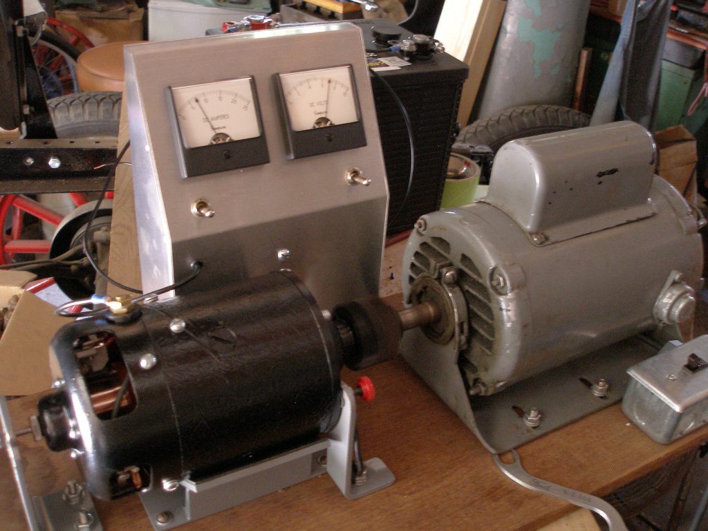

let me inject this into your topic: if you have a later engine with a FORD T generator, rather than just hook it to the battery and wait for unanticipated events and troubleshooting to transpire, consider proactively taking the generator to someone with a run-in stand to test for...function (does it even work?) set output to 4A to be kind to the generator AND battery. And then seriously consider my comment above and wire in an aftermarket ammeter to monitor both the draw and the charge to the battery.
You may very well find that the generator is non-functioning and you might as well know this going into it rather than spend hours/days/weeks wondering and troubleshooting your setup without knowing basic truths about the whole system.
If it is a "T" generator, don't go to the local Starter Shop and expect they will know a thing about it...you need someone who has the ability to drive it, monitor it, and adjust it. This particular remanufactured generator started out as 6A at 7V...it was tuned down to 4A at 7V and was shipped out in that condition:
