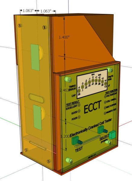

A good instructional lesson I learned the hard way a long time ago (well, maybe a time or two since); Measure Twice, Cut Once!
OK on reducing front and back thickness, that's a possible solution. BUT, has to be done selectively routed out for the coil area only. Don't thin the entire panel or you'll wind up with the same problem!
Now I usually build up a 3D model of all the parts to check form and fit before spending a lot of time, effort and money on building a prototype.
