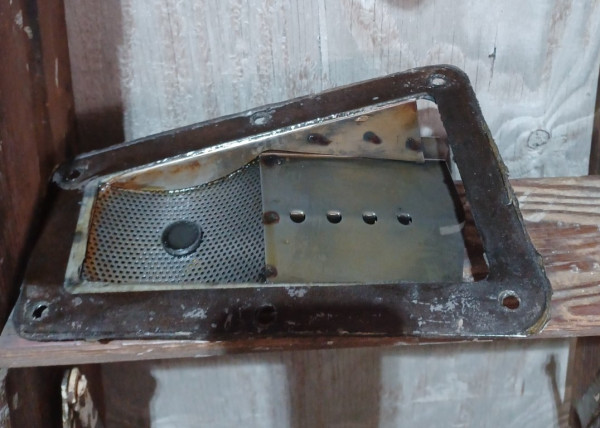

A transmission screen will aid in keeping the oil pipe clear. Getting rid of two-piece valves would be a very good idea for an engine expected to do much running. Taking reasonable steps to keep dirt out of the engine will pay dividends. A proper, high flow oil filter would require an oil pump to be fully effective. An FL1A filter will pass hot 10W30 quite readily when it is clean. A Texas T oiler might be able to push hot 5W30 or 10W30 oil through an FL1A filter at a useful rate.
