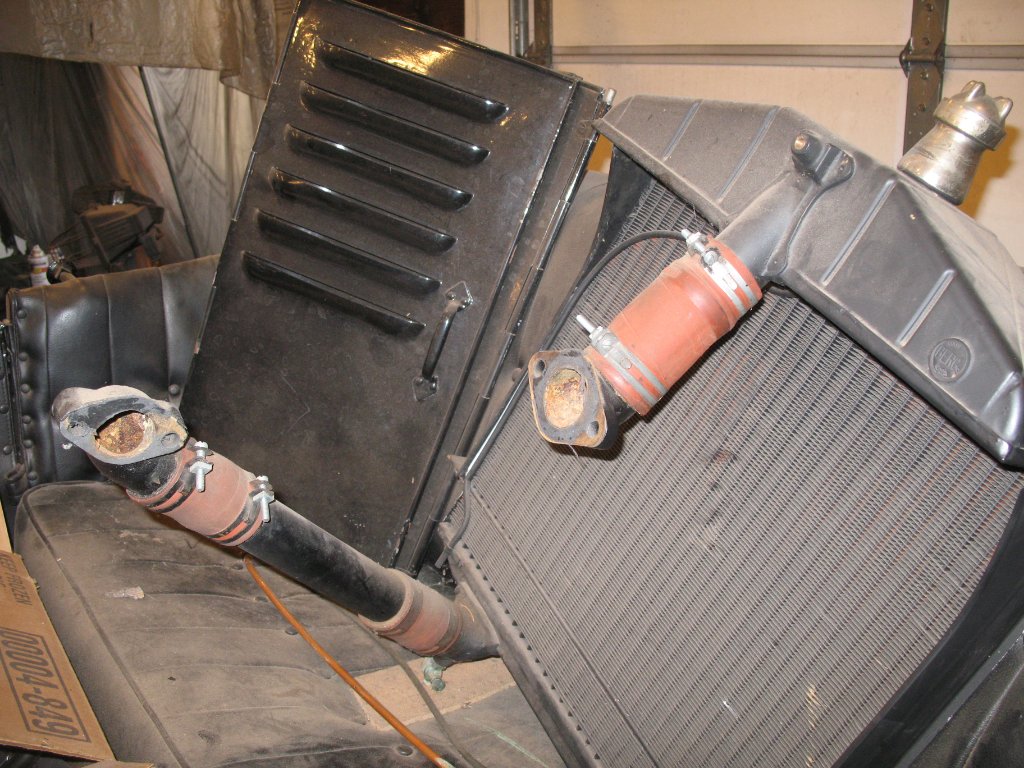

Rather than using a sealant for the hoses, I smear grease on the inlet and outlet so it will be easy to remove the hoses if I need to do that. I use the old style clamps, but with fillister head screws that allow the screwdriver to get a good bite.
I also remove the radiator and hoses as a unit so I don't have to disturb the hoses. The first time I reinstalled the unit I applied Ultra Black to the inlet and outlet, then the paper gasket, then another layer of Ultra Black. I smeared grease on the head and the block, bolted on the inlet and outlet just enough to flatten the Ultra Black, and let it set up. This made a permanent rubber/paper/rubber gasket on the inlet and outlet. Now any time I reinstall the unit I smear grease on the permanent gaskets and bolt the inlet and outlet onto the block and head. I don't have to clean off old sealant and use a new gasket.
