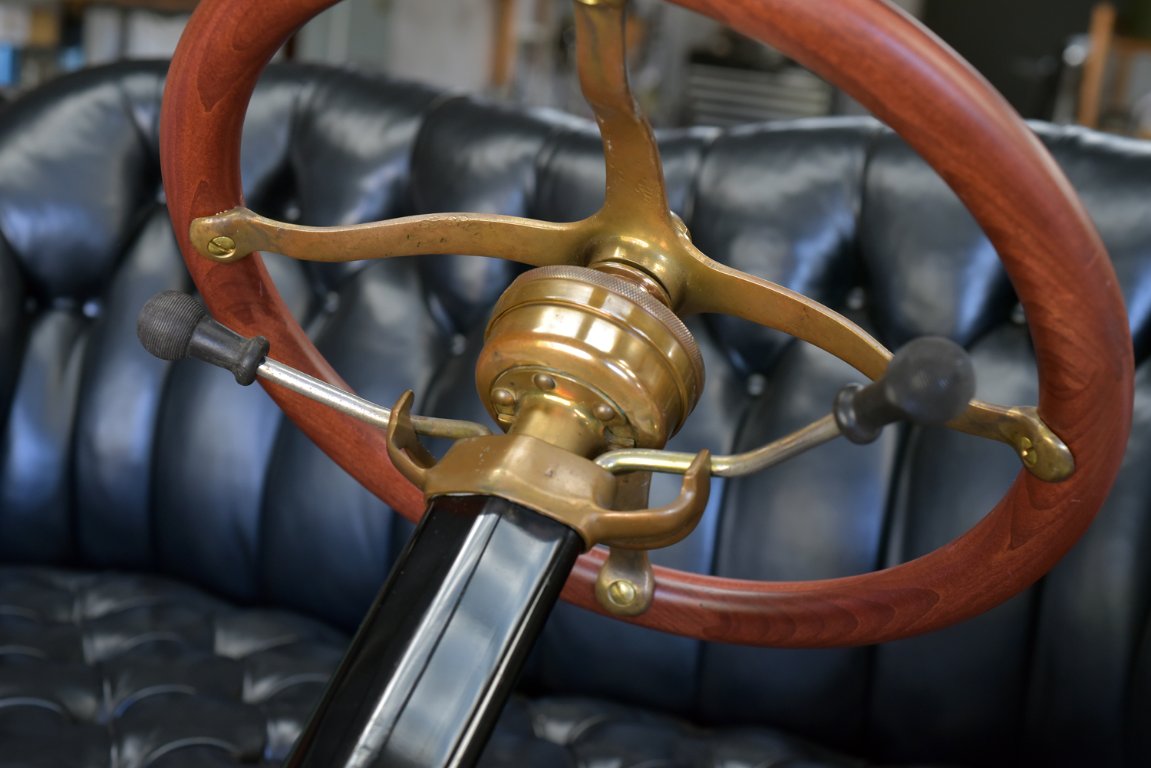

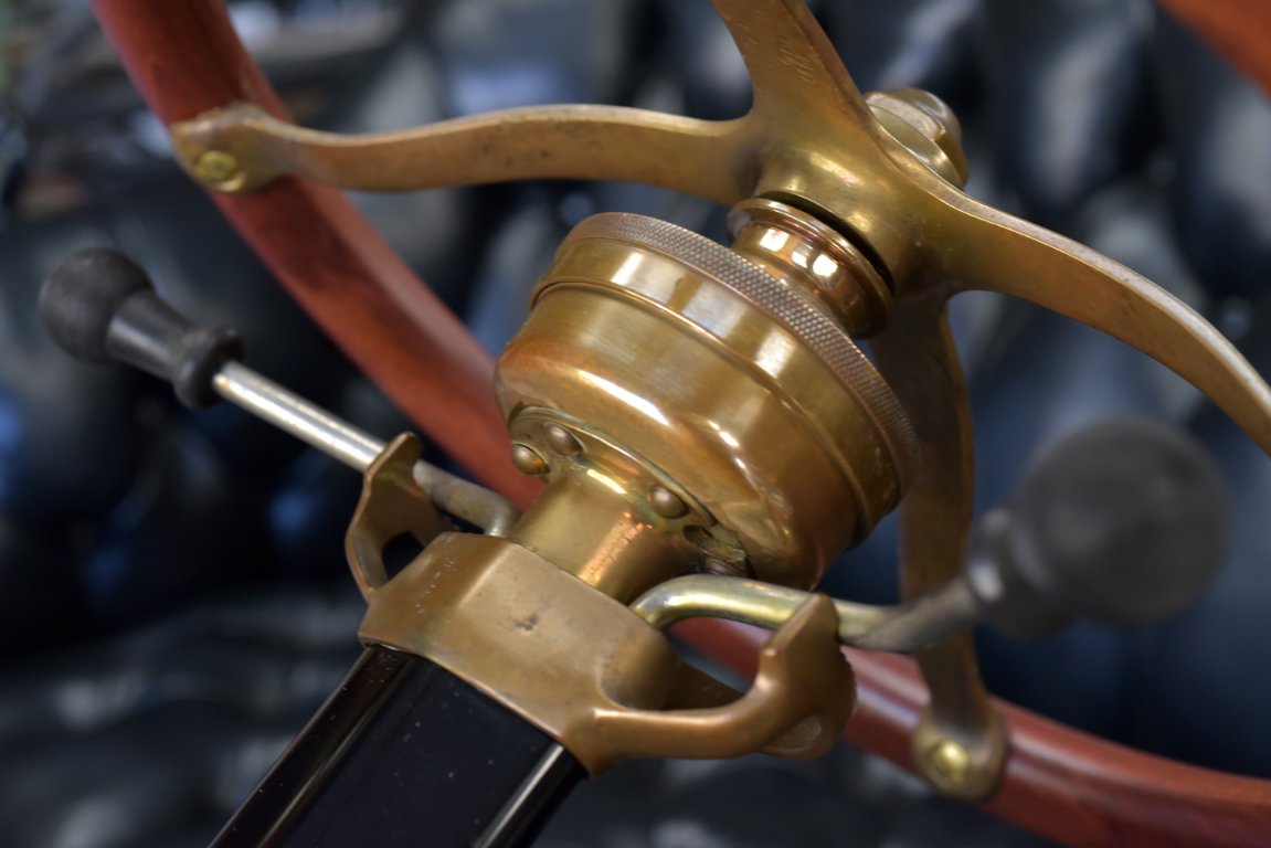

Shouldn't there be rivets in the brass steering quadrant? I am talking about the two long rivets that go through the quadrant and the steering column tube. Assuming they are needed!

looks like those are heavily ground back and polished over

Yes, there should. I think your photos are showing a rivet on the driver's side of the quadrant, albeit without a head. Perhaps someone filed the heads flush with the quadrant in a misguided notion of aesthetics ? What does the underside look like ?

Don't I see rivets in your pictures?

The dark spot in my picture is actually just some oxidation in some pits that needs to be cleaned out. A close look both top and bottom I see no evidence of rivets or previous holes. I suppose the rivets, if they are there, could have been ground down but I would think that I could see evidence of them. And, the previous owner was not the type to do something un-original, so I think he had not gotten around to drilling and riveting. I assume the steering quadrant etc. were all riveted in this manner, just as I had to do when I rebuilt my 26 steering column.

I have had a couple repros of those (one on my 1913 project), and a couple original ones. That definitely looks like a repro. The funny thing is that one of the repros I had, had a nearly identical flaw in the casting where yours should have a rivet!
It looks to me like the previous owner never drilled and installed the rivets, and that definitely NEEDS to be done!
It really should be taken apart and inspected inside. Make sure there are no cracks or other issues, and look to see if holes are inside where they should be? Holes for those rivets, both originally and even worse in more recent decades, were not drilled consistently! IF there are holes inside? You should try to match into them and remove as little material as possible.

I wonder if sometime in the past, someone couldn't find brass rivets so they cut pieces of brass rod and peened the ends and polished over? Hard to tell from looking at pictures.

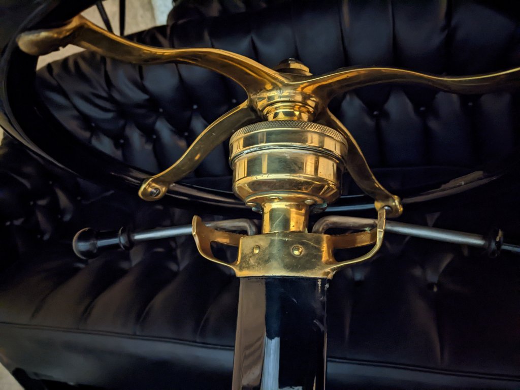

You've already gotten your answers from others, but here is a picture of our late 1911/early model year 1912 steering column showing the rivets.

Makes me think that repros were made using an original quadrant as a pattern. The original would have had the rivet holes filled in for use as a pattern, but perhaps not perfectly, leaving a small witness mark in the repro castings.Wayne Sheldon wrote: ↑Sun Dec 04, 2022 8:04 pmI have had a couple repros of those (one on my 1913 project), and a couple original ones. That definitely looks like a repro. The funny thing is that one of the repros I had, had a nearly identical flaw in the casting where yours should have a rivet!

Jerry, I had a similar thought a few years ago when I was looking at the parts I had. I haven't seen enough original ones in many years, to see how they mostly were. The couple original ones I have are much lighter in weight, and bulk than are the repros. The brass "bow" with the notches to hold the spark and throttle levers where placed on the original ones I have are only about half as thick or strong as the two repros I have? I wonder if the makers of the repros just wanted to make them stronger? One of the original ones I have is broken, but I think I can repair it. In the past I have welded brass by creating a plaster form to support the part being repaired that allows me to heat and fill missing brass as needed. That has worked rather well on several parts.
Perhaps someone built up an original piece to make it heavier and stronger to create the form for the repros, but left the original hole in place? Seems strange to me, but maybe?
Also, the first photo at the top of the thread has me wondering about the "two-piece" gearcase? It looks like the lower piece may be correct original? However the gearcase riveted to that lower piece doesn't appear to have quite the shape of the couple original gearcases I have. It looks more like a later "one-piece" gearcase cut and altered to replace a missing or broken piece. I notice this because I considered doing this myself on one of my cars when faced with a broken gear. Then I found a better replacement.

Wayne has spotted an interesting detail. Contrast the flat bottom on the gearcase in the initial post, with the tapered base on the later posting. He may well be on the mark with his observation that perhaps a later gearcase has been grafted on. Notice the absence of any solder between the two components. We may be looking at a heavily modified component.
