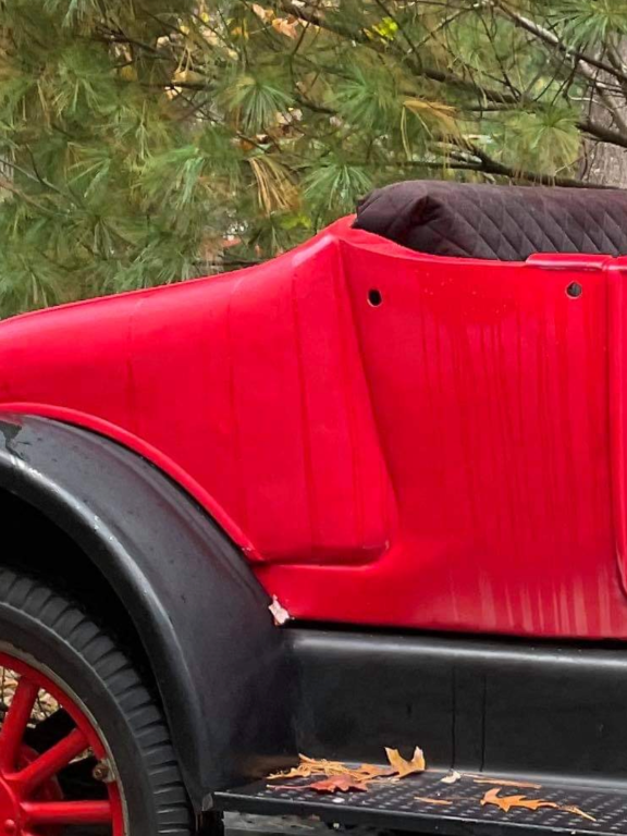

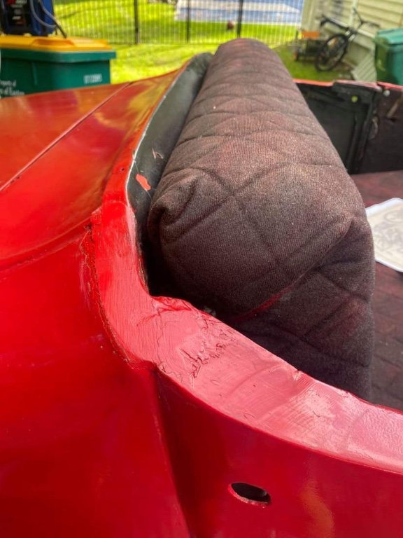

Hello
Please review the two pictures attached. See how the trunk has been molded (bondo’d?) into the rear of the body?
It is not a fiberglass body. The body and trunk are both steel. Is it safe to presume that this is the result of an improper “restoration”?
Until I saw the same thing on a FB post today, this car is the only one I have seen like this and I plan to cut it apart and fix it this winter, but now seeing another one I thought I would check to see if I was missing something that I don’t know first.
Thank you in advance.

Wow, that's really cobbled up. No it should not be smoothed over at the seams. Looks like they cut off the flange for the wood trim along the top edge too.

If I were faced with this, I'd be inclined to contact the guy on Facebook and ask him if he'd like to own a pair of 'em, or leave it as is and accept it for what it is.
The amount of work I see involved to make this right would lead me to simply look for a better project. The horrors you are going to encounter would be more than I could personally bear.
I do wish you luck. It's not a lost cause if you have the talent and time, and the wallet for the parts you will need...but it is going to be a huge amount of work for little return.
The more you spend to initially buy the car, the cheaper it will cost in the end to make right.

If you have not bought it, DONT! It can be fixed, but would take a lot of work just to get it useable, unless you only want to drive it without the top. It would not ever be a show car, or even a good "unrestored" You would need to know how to cut and weld metal and completely paint the car. The upholstery is not correct either. If all the other parts are there, and running offer maybe 1,000 or less, or else, look for something better. I suspect someone had ideas of putting a big engine in it and making it into some type hybrid car.

The body is probably rat rod or perhaps speedster material.

Maybe even the wrong trunk…

Looks like a cut-off touring body that has been "married" to a trunk.
