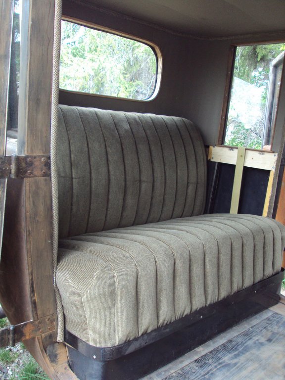

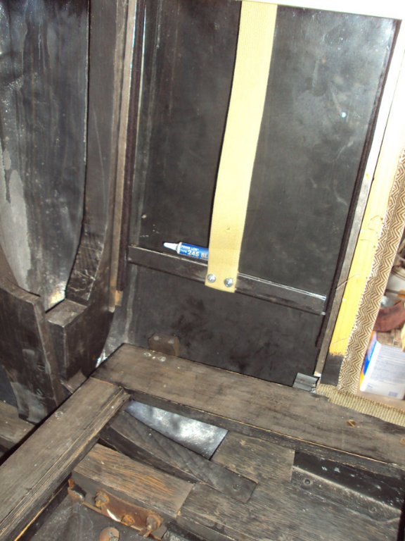

Re: 1920 Coupe Window Pull Info Wanted
I had to guess on mine but here is what I did. I believe it is pretty close.
I put several holes in the strap for different window heights.
