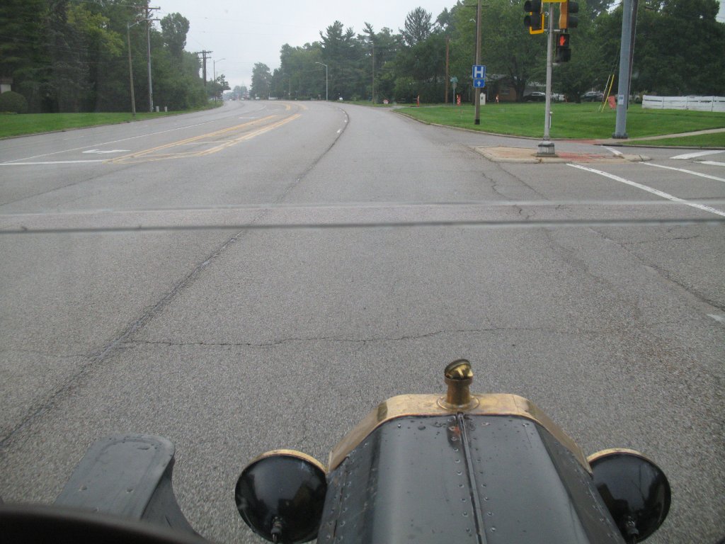

I bought one of those fancy hood ornaments and the thing won't screw in right. I have tried adding some rubber rings aka gaskets to supplement it but it still won't fasten correctly. When i screw it on it tightens north south not east west. . . regardless of the gaskets. I have come to the conclusion that to make this work I probably will need a new filler neck. The question is: Can this even be done? I don't see any bolts holding it on. It looks like its pressed on or maybe welded. I am not super technical with this stuff. Any knowledge on this?

See picture below. North south meaning when i am looking at the radiator from the front the wings are pointing to me and the windshield instead of pointing to the front wheels. That is where is screws to. I wish i had better pictures but i am at work.TRDxB2 wrote: ↑Mon Nov 28, 2022 11:01 amcramagraham wrote: ↑Mon Nov 28, 2022 10:05 amI bought one of those fancy hood ornaments and the thing won't screw in right. I have tried adding some rubber rings aka gaskets to supplement it but it still won't fasten correctly. When i screw it on it tightens north south not east west. . . regardless of the gaskets. I have come to the conclusion that to make this work I probably will need a new filler neck. The question is: Can this even be done? I don't see any bolts holding it on. It looks like its pressed on or maybe welded. I am not super technical with this stuff. Any knowledge on this?

Radiator is original yes. i attached a pic of the moto meter that we bought for it.

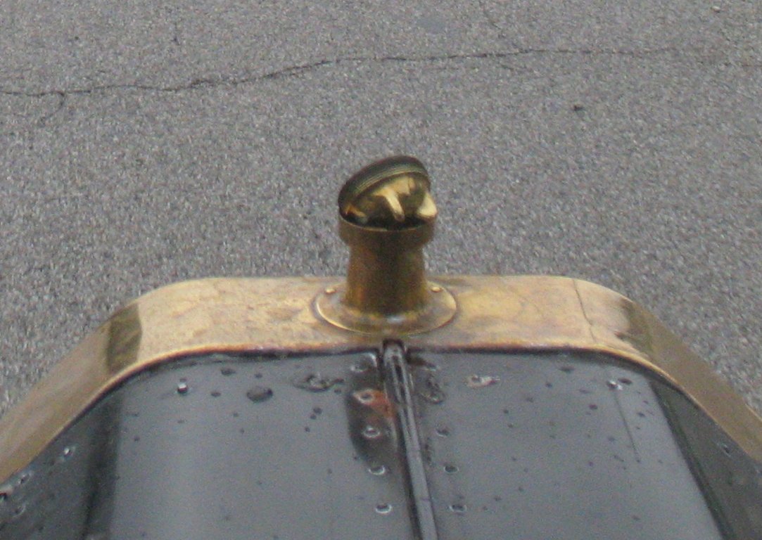

On my screen the view of the radiator neck in the first photo appears to be such that the top of the neck is angled to the passenger side as if it has been knocked or bent in that direction. It certainly is not centered in the shroud. If it has been knocked/bent, it's also possible that the neck is out of round, and that could be preventing full thread engagement of any radiator cap or appliance. If you have added the recommended gaskets to no avail, the problem might be lack of full thread engagement, the new 'cap' may not screw down into the neck sufficiently to make contact with the gasket(s). Again a closer view inside the neck would help determine if this is the issue. And if the neck is out of round, bent or damaged, be very careful in straightening it, you can easily cause more damage than you correct. And if the bent neck is an optical illusion, don't mess with it or the shroud. If the dogbone is horizontal with the proper thread engagement, the neck ok, and adding gaskets should be sufficient to get tight while pointing 'true North'.

If the cap tightens up, just not straight, how can that be worn threads?

See thats what i mean. its almost like the model t gods are laughing at me.
- Posts: 6581
Re: 1918 Ford Model T Filler Neck questions
I think there is some confusion when you say "if the cap tightens up" and when you say " When I screw it on it tightens north south not east west".
If the cap were tight all around it would not be loose in the neck in the any direction. So if the inside of the neck were out of round (bent or threads) it might account for the movement you described. Then again, maybe the cap is at issue?

Different thickness gaskets will allow different orientation of the dogbone ears.
If the dogbone is bottoming out on the base when you screw it in, you could also machine/sand/file a little off the base of the dogbone thread, allowing it to screw a little further round.
Brassworks radiator necks are soldered in place. I know this because I had to shift one for the radiator shell to fit. Original radiators are different. The top plate has a flange bent upwards into the base of the radiator neck. When the neck is fitted, the flange is bent down to capture the rolled-in base of the neck. Thus the joint has a mechanical element to it, which is then sealed by soldering. This makes a joint which will support more weight of an accessory cap better than one which relies solely on the solder joint.

Oh my gosh... His cap tightens up 90 degrees from where it should be. The threads are fine, or it wouldn't tighten at all. He needs more washers under the cap.
Brian,
Measure the depth of your radiator neck, from the top edge, down to the shoulder where the gasket sits. Measure it with no gasket in place. Then measure the length of the cap threads. I'll bet the neck is way deeper than the cap threads are long. The difference in the 2 lengths, is the minimum thickness that your gasket stack should be. In fact, the stack should be just a bit thicker.
Brian,

Holy cow I never thought of this. This is probably it exactly. What should I use around the cap threads to block them?

Here are some more pictures and hopefully these will help.
- Posts: 8642
If you put enough shims under it, you can make it snug up anywhere you want it to.
- Posts: 4472
YES! Do what Pat says.
If it takes 6, (or more, or less), gaskets to make it work, then so be it. Keep adding gaskets till you get what you want. I don't know how to state it any clearer than that.
cramagraham

Did you see my added pictures? The problem seems that it only bites on the neck threads when its near the bottom of the neck.Allan wrote: ↑Mon Nov 28, 2022 5:33 pmDifferent thickness gaskets will allow different orientation of the dogbone ears.

I'm not sure that the pictures really show that. Does the regular T radiator cap do the same thing? Can you show a good picture of the moto meter threads?cramagraham wrote: ↑Thu Dec 01, 2022 12:23 pm

You have a paper gasket in there.
You'd need like 20 of those to make the dogbone seat on it
the Langs rubber gasket is, perhaps, 1/8" thick
either 1 or two of those langs gaskets (probably 1) will snug the dogbone long before it bottoms out on the top edge of the neck
or, as I mentioned before, wrap 1, 2 or 3 wraps of teflon pipe tape on the dogbone threads which will physically "enlarge" the threads and will be an interference fit all the way to where you want to leave it facing...meaning 3/4 of a turn shy of where it is seating at now

Yeah my dad was supposed to show that in the picture but he failed to do so. The mere fact that he was able to use his smart phone and take pictures and send them to me was mind blowing in itself...lol.
