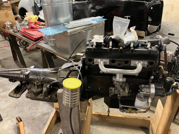

Re: What have you done to your Model T in December?
Pressure oiled counter balanced crank
Datsun B210 oil pump
Pruss head
Stipe cam
Marvel Schebler carb on home made manifold
Borg Warner T35 automatic from a 68 Cortina
Cast aluminum adapter by me (I no longer have the pattern)
Pruss head
Stipe cam

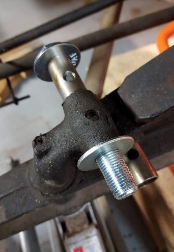

Helping an 87 year old new model T owner get his car roadworthy. Today we replaced the front spring shackle bushings using a Steve Jelf Press. Boy-o-boy, the new budget shackles made from studs pressed on a plate are a POS, but all he could get.

Jeff
hold out for better shackles!
I've seen them wear out crazy fast, especially if the knurling in the bar fails...that bar will stretch at the hole like salt water taffy.

Jeff, check the fit of a new set of bushings (prior to reaming) on his old shackles. Sometimes the undersize of unreamed bushings will make up for the wear in old shackles, resulting in a good fit.

I did try the old shackles, they are worn, just a little more than I would prefer to use. He bought the crapy ones and wanted to use them, so I used them. We are keeping the old ones as a backup plan.
Anybody use the budget shackles and find them OK?

They work until one side (apparently) starts to lock up in the bushing (lack of oil?) and then the knurling fails and the strap's hole elongates.
Several have been shown on the forum over the years
I think the key is to keep them well-serviced
Here's Rich Eagles tribute to them: viewtopic.php?t=5264

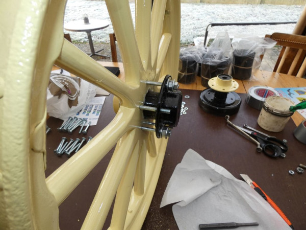

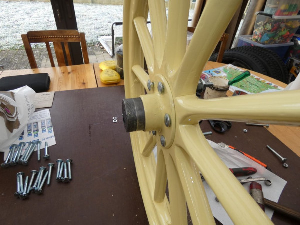

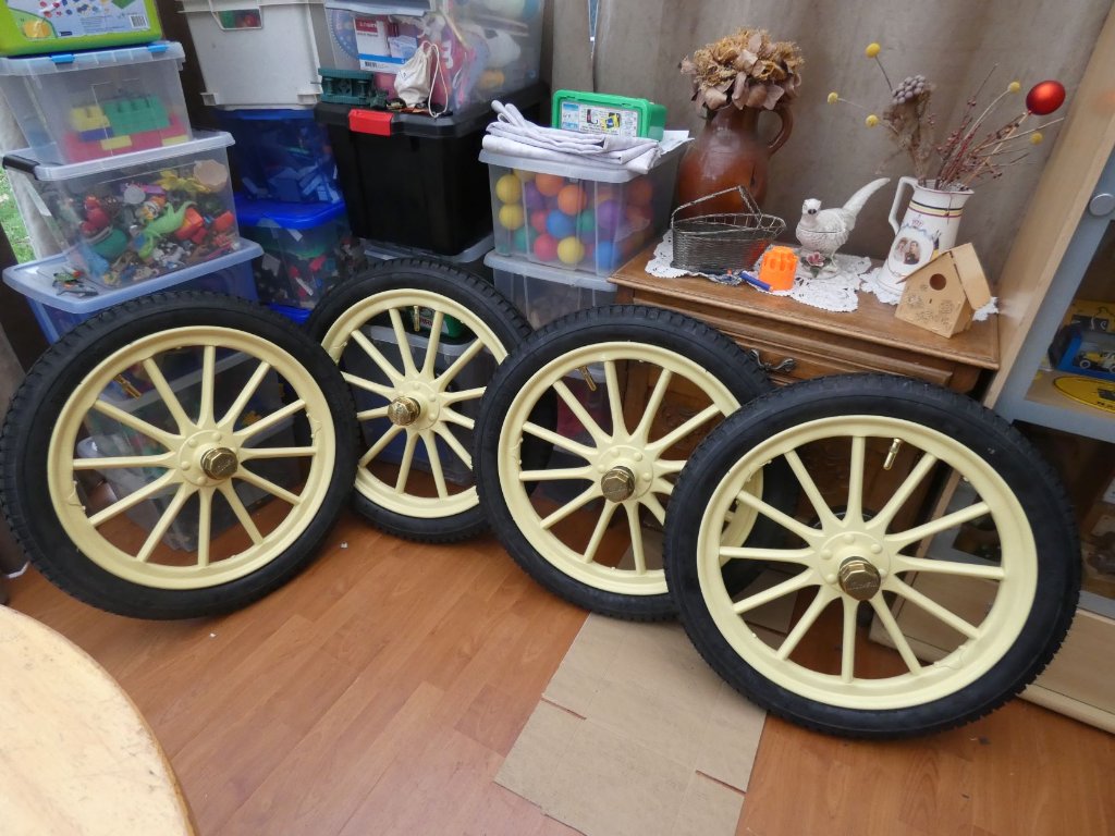

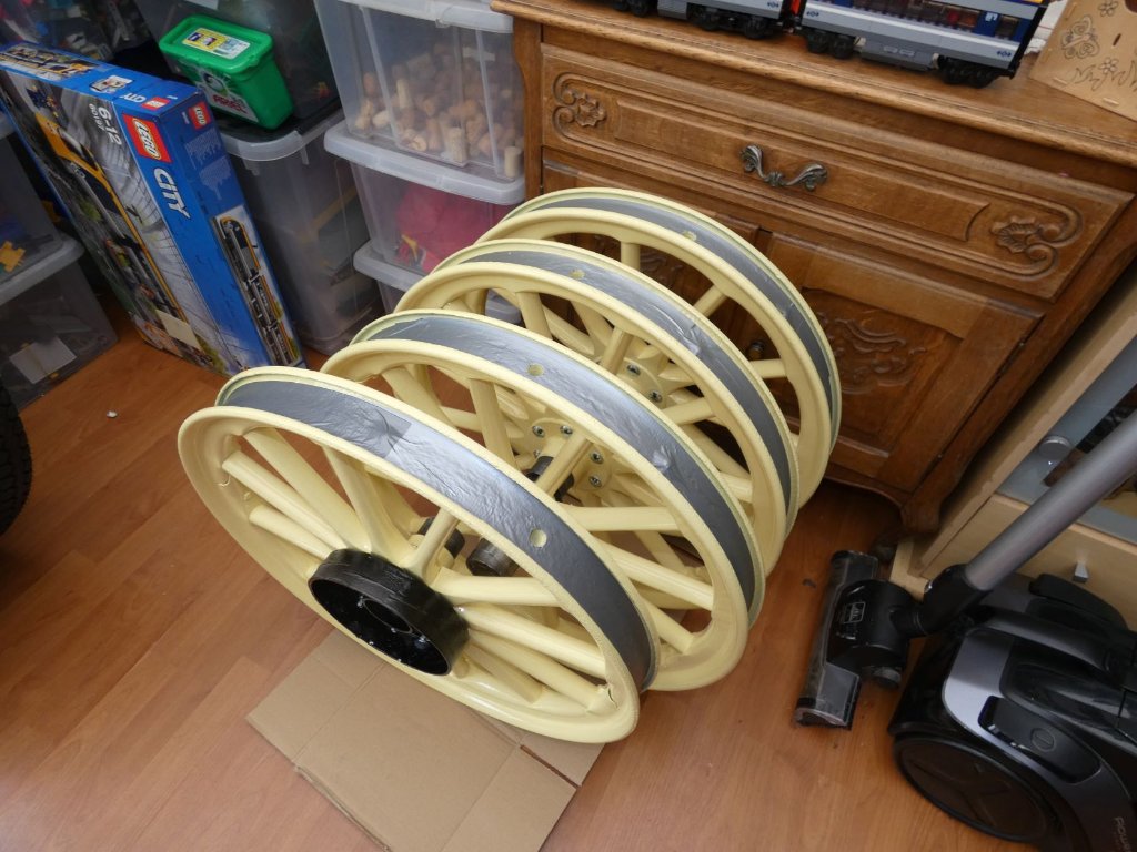

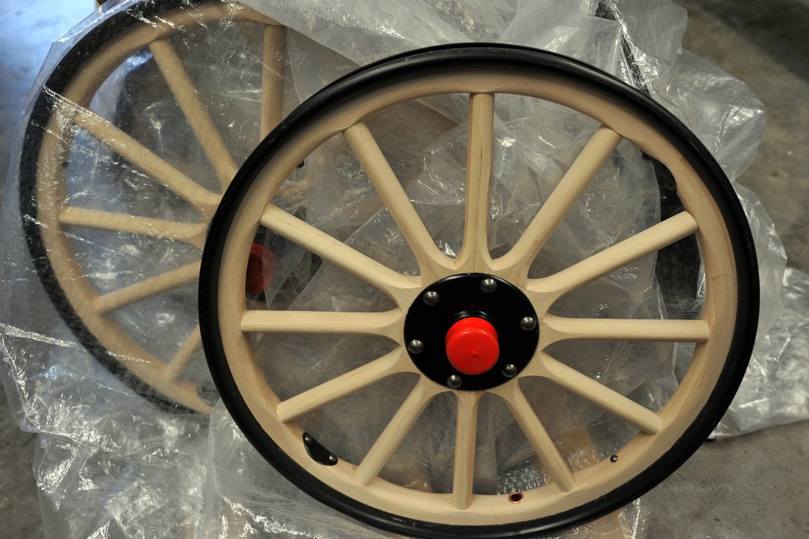

I received my rebuilt wheels from Stutzman in December for my 1912 Roadster. Dang, he sure does nice work and could possibly be the best value in the restoration business.

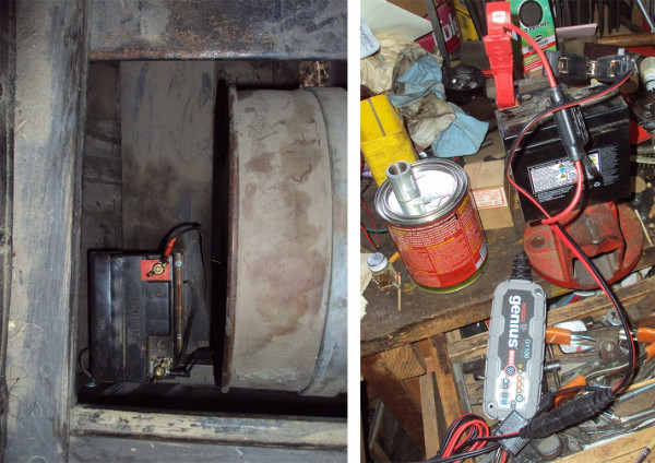

My condolences too. By all means, give it some time. Things often get brighter.
Today I bit the bullet and rescued the battery from the snowbound '14. I have left too many in the cars without charging during the winter and they died. I charged 3 of them today and they reached full charge quickly. Rich

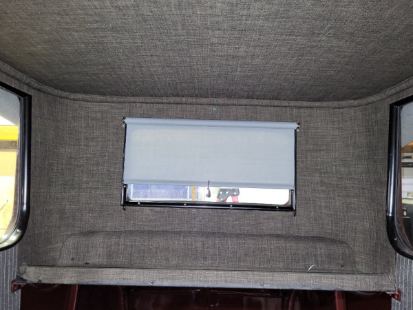

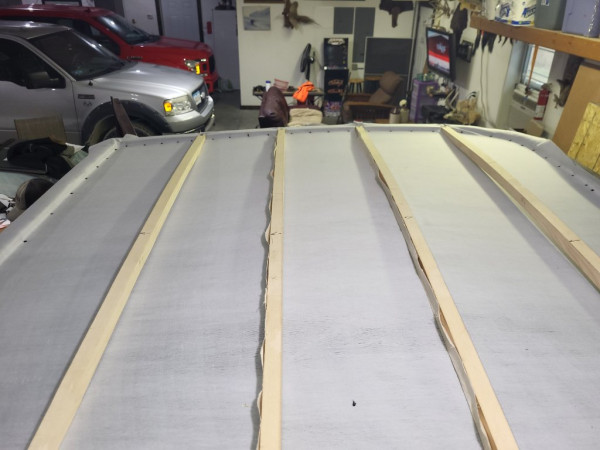

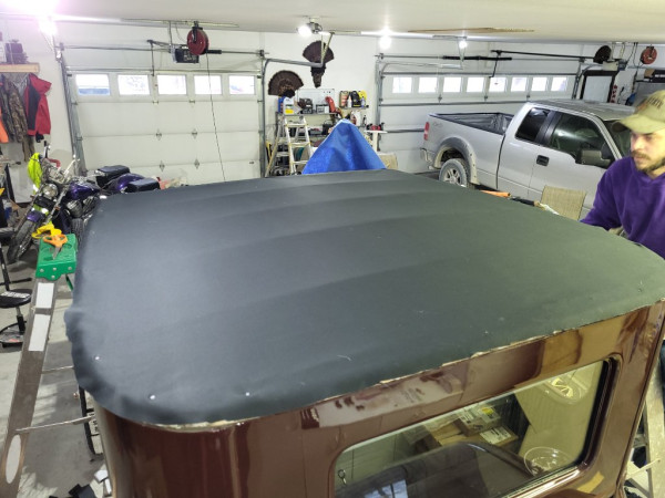

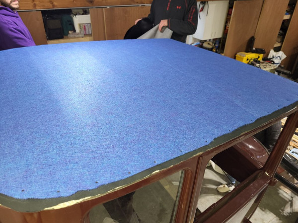

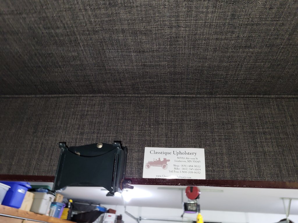

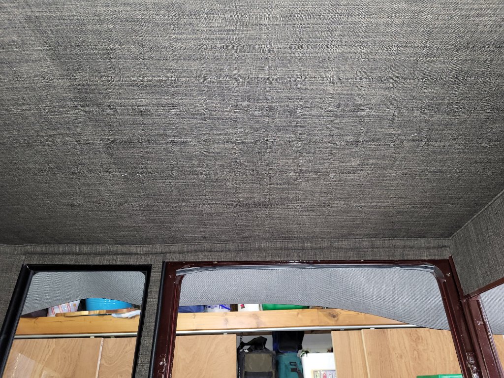

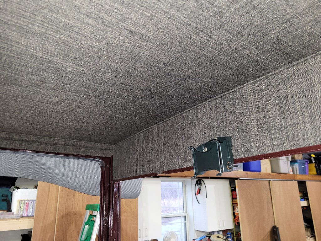

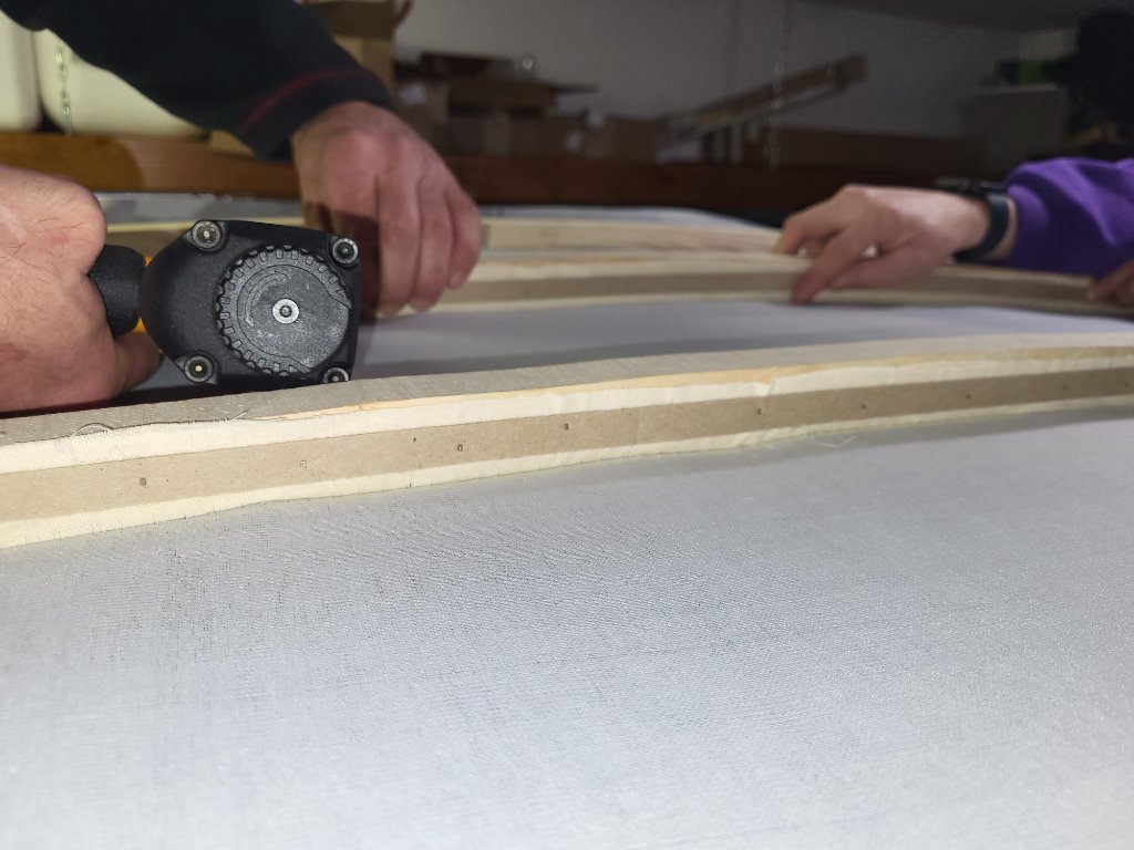

What we did today was a big step forward in the restoration of my 1927 coupe. We installed the rear curtain, the headliner, and two layers of the top. The last layer (the vinyl) will be next.
I had never installed any upholstery, so this was sort of a scary endeavor! My son and a friend helped, and I am pleased with the results. The wood bows were made for me be Jeff Humble and the upholstery was from Classtique (Thanks Jeff and Mike).
These are the first five photos, and then I will post five more.

Nice work on the interior.

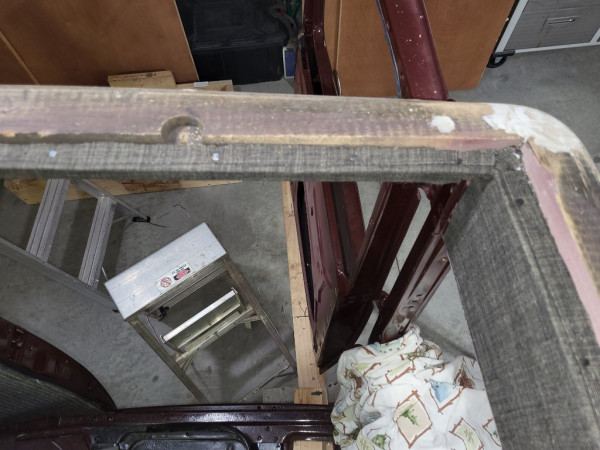

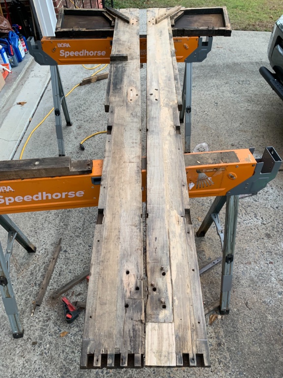

I turned this 1912 PWOS (Piece of Shhhh..... Wonderful Old Stock):
Into this 1912 PWOS:
Trying to fix all the wood beetle holes, rot, manufacturing (meh, good'nuffs), without totally ripping it apart and replacing all wood.
The seat frame on one side was 1/2'' off from the other side. All original...
I really want to replace all wood... but, then it wouldn't be so original.

you have the start of a really wonderful car! Is that from Don Elis?
Yes, it is wonderful. What a treat to see the original body and the wood the way it was. Those things are absolutely fantastic.
Thanks for the chance to see them.
Best of luck with the progress.

Yes, I got this from Don Ellis. Squirrel nuts and all…

I just finshed the rebuild of the four wheels for the 1911 Maxwell.

Beautiful.
Thanks for posting it.

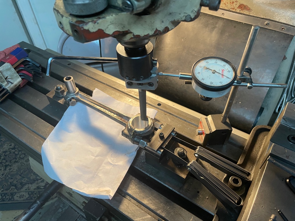

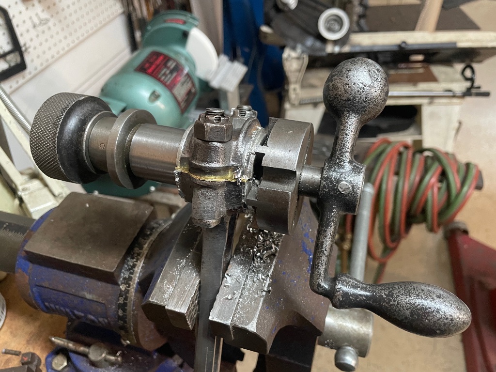

I have been able to rebabbit Model T main bearings for some years now, but I thought I would try my hand at connecting rods. I made a jig for boring the rods on a milling machine (based on a set of jigs a good friend of mine had made up for his own use). I used one of the commercially available molds to pour the rod and the cap separately. I mounted the rod in the jig and used the DRO on the mill to set the center to center distance between the piston pin and the middle of the large end bearing to 7 inches. The Ford factory drawing for the connecting rod showed that Ford did not use shims between the rod and the cap, but the drawing also called for oil grooves to be broached on each side of the rod at the joint between the rod and the caps. I have no good way to broach the babbitt the way Ford did, so I used a pack of 1/32” shims between the rod and the cap on each side to substitute for the groove.
The boring head on my mill produces a very nice surface finish when the quill travel is set on its finest feed (.0015/Revolution). Once I got to the ballpark of the final size, I took very small incremental cuts until I reached the desired final size, in this case .010 under.
With the bore finished to size I used a KR Wilson bearing facing tool to cut the radius on each side of the bearing and to narrow the side to side width of the babbitt to 1.490 which is .010” less than the width of a crankshaft rod journal.
I am satisfied with the way this rod came out, and it was an interesting project, but I can say that after doing all the work necessary to complete one rod that paying $90 apiece for rebabbitted rods from Lang’s is a bargain.
Respectfully submitted,
Trent Boggess
Trent Boggess

Yes, purchasing is cheap but you can control the quality when you do it yourself. If you have a ground crank, you may want a wider side to side dimension. I haven't been thrilled with the rods coming fom the suppliers for a couple reasons. Poorly cut radii for one, inconsistent side to side dimensions for another.

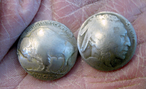

My major accomplishment today was making a couple of casting/freeze plugs to go in my box of spare hardware under the seat. You have to grind the edges a little to make them fit in the hole. Better to do that in the shop than out on the road.

So Steve, are those worth two plug nickles?

I really liked the using of nickles for freeze plugs and made a set. I didn't care for the thickness of the nickles and was afraid of cracking the thin edge of the block when setting them so I chickened out and used the thinner brass ones. bobt
- Posts: 7411
If the steel ones were that thick I would worry about them breaking something, but nickel is a softer material. It has never been a problem in that way for me. I do use Ultra-Black behind them. Old time Permatex #2 is not good in that application.

It hurt a little bit to see that con rod in your vise. Did you check for bend & twist afterwards?

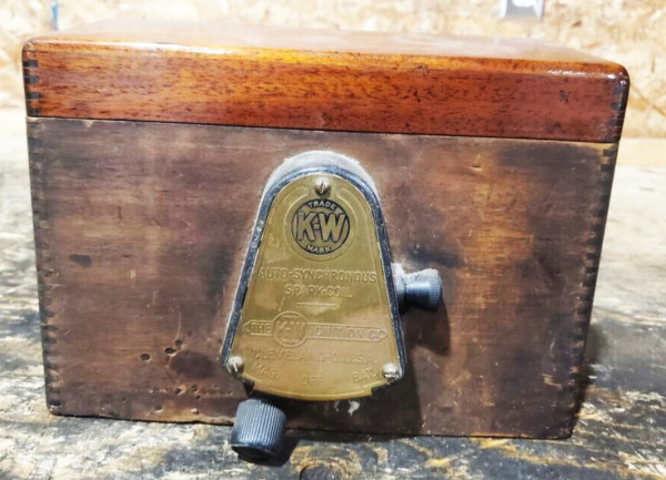

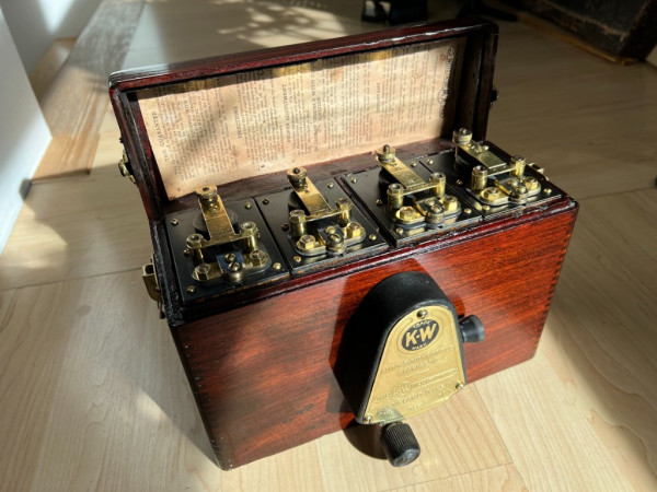

I've been restoring a 1913 coil box and coils for a touring car project. The box I started with had two correct coils and I found two others from separate sources on eBay. I replaced the capacitors and points before repotting the boxes with type III asphalt per Ron Patterson's suggestion from previous postings. I'm also working on (or have in the queue) restoration of coil boxes and coils that include a Kingston 4200 for a August 1909 Tourabout, 1910 Kingston for a touring car, Heinze for a May 1911 touring car, and KW red brass top coils for a January 1915 Coupelet. Dr. Larry Azevedo is helping me with the testing and adjustments as he has the equipment and knowledge to analyze the conventional sized coils, like the red brass top ones, but also the coils that don't fit in his ECCT. The Tin Lizzies of Albuquerque, and me especially, are very lucky to have Larry as an expert and generous resource!

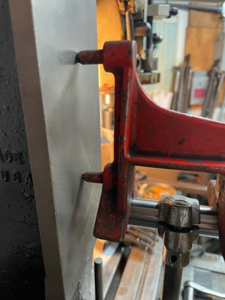

[/quote]

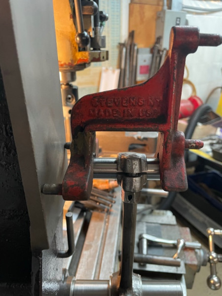

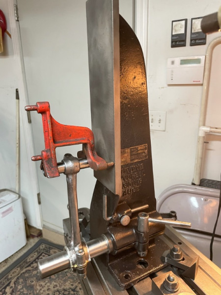

Trent,
[/quote]
Jerry,
The next step is to straighten the rebabbitted rod:
Once all the rods have been straightened, the last step before assembly is weighing and balancing the rods.
Respectfully Submitted,
Trent Boggess
Trent,
[/quote]
Jerry,
Trent Boggess

- Posts: 4471
Trent,
[/quote]
Jerry,
Trent Boggess
[/quote]
Awesome Trent! Nice equipment! Thanks for the pics.

1914 roadster,
Engine out, installing new rods, adjustable lifters and valves, new timing gears, starter mag ring, rebush transmission, new bands, new clutch spring, new Z aluminum head and rebuilt straight thru Holly carb. Also installing a new gear reduction starter and converting to 12 volts.
Next will be disc brakes.
That should keep me out of the pool hall and away from wild women!!!!!
fronty boy.

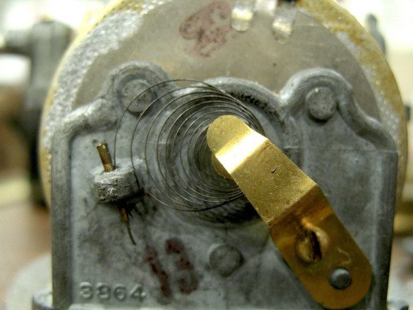

My speedometer wasn't returning all the way to 0, so I advanced the spring about ⅛" and that cured it. I hope I didn't hurt its accuracy any.
- Posts: 8640
It may affect accuracy if friction was causing it not to zero. I would think that the spring ought to be less distorted and that it shouldn't touch anything except at the ends. If it's accurate to within 5 to 8 % from 5 MPH to 35 MPH, that's great.
- Posts: 7411
Nope, no drag on the speed drum. I suppose the spring lost a little springiness in the course of 106 years. If the speedometer has lost a mile or two, no problem. At 35 mph 5% is 1.75. It has no effect on the odometer.
- Posts: 5251
Not an expert here, but as I understand how the thing works, there are magnetic fingers inside the speed drum that move the drum magnetically. So adding more spring tension to the drum will require more magnetism to show accurate speed.(if the reading was accurate before) The magnetized fingers would need to be slightly closer to the drum to recalibrate(speed up the drum) without touching. Or if weakly magnetically charged, re magnetized.
