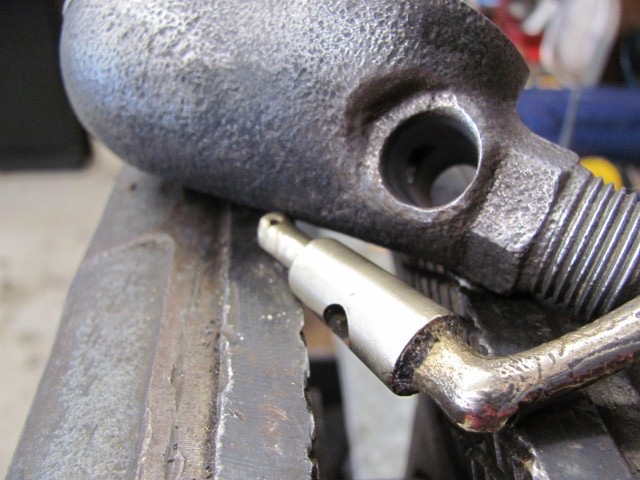

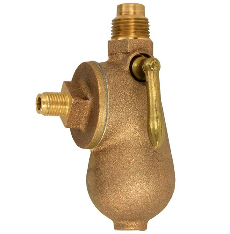

Does anyone reproduce the shutoff valve handle itself? The whole potato is reproduced but I just need some valves. I have probably a dozen good assemblies that the handle is broken off.
photo borrowed from Lang's

I have successfully silver soldered some handles on. You could put the taper in a piece of pipe to work as a heat sink to reduce the chance of warpage. Brazing might work too. It's not seen so it doesn't have to look pretty.

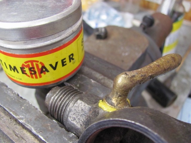

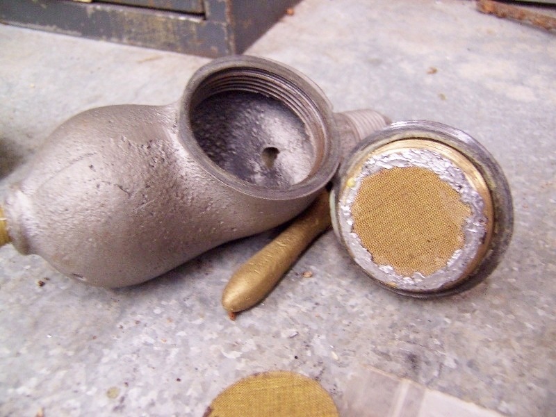

When rebuilding the sediment bulb, replacing the filter screen and cleaning up the bulb, the handle gets polished, then inserted in the bulb valve opening and using TimeSaver, lap the valve body to the iron bulb.
