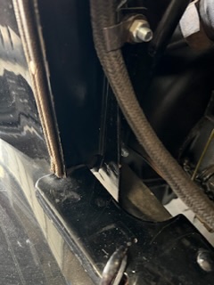

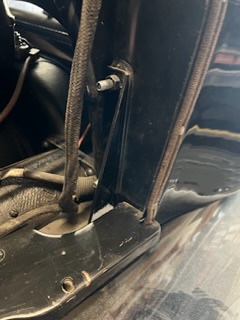

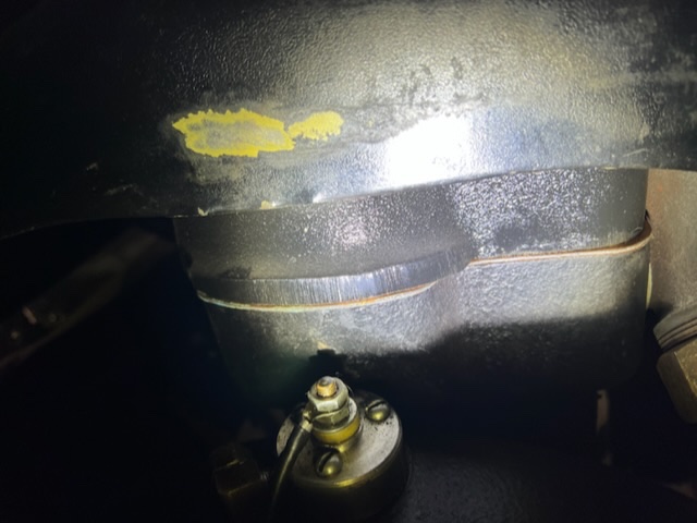

Drivers side bracket
Passenger side bracket
Hope this turns out.
Thanks,
Posts: 7279
Re: Firewall bracket 22 touring
Post by Allan » Thu Dec 08, 2022 5:37 am
The first photo shows a hood shelf with the dogleg at the back end. This normally indicates a high radiator car. In turn, does this mean that the firewall is necessarily a steel firewall. The change from wood to steel occurred with the last of the lo radiators.
Or have I missed something in translation?

be a little more generous with the camera pixels and show us where the back of the motor rubs the firewall
from your bracket pictures, things look fine...the engine does sit very close to the firewall on these cars and maybe all you need to do is give the firewall a bit of a tug at the bottom to pull it off of the back of the head.

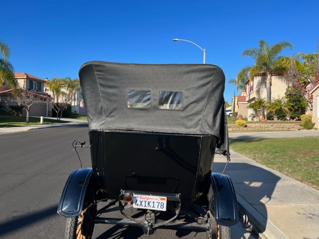

overall shots of the car will help folks too. Front, rear, side, interior...Like Alan said, you have shown us enough to think your car may actually be a '24 (regardless of what the title says...). This will all add up to better advice.

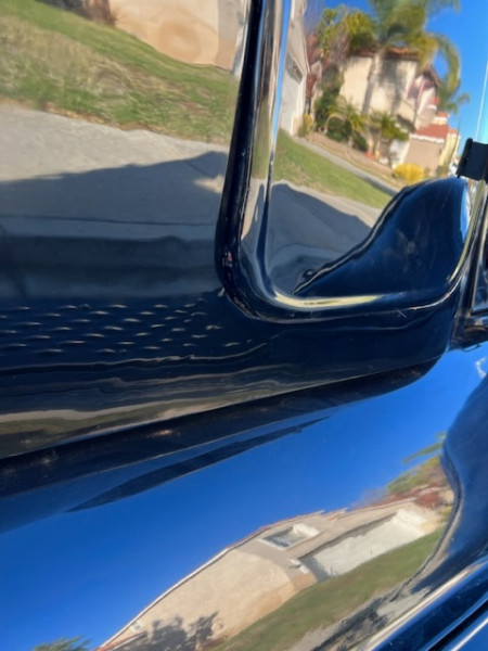

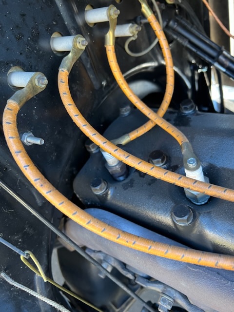

Firewall hitting the head

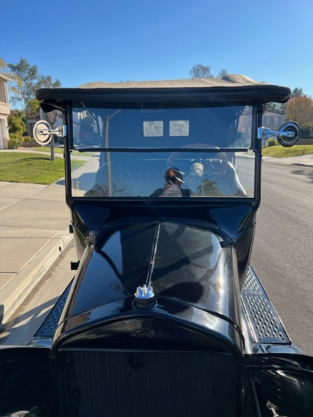

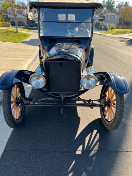

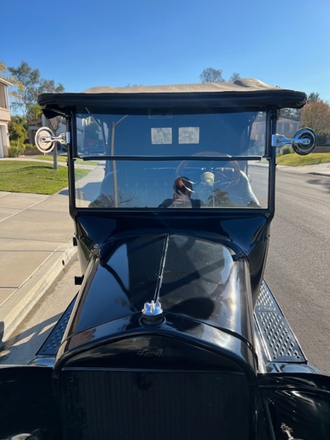

Post by Tbuff23 » Thu Dec 08, 2022 12:15 pm
p
Here are some pictures of what I am working with.
Thanks again for all the help.

It's not uncommon for the firewall to rub the back of the engine. Also, not uncommon for the door to poke out as yours does. The body and the door are made with wooden framing, covered by sheet metal. As such, the wooden framing sometimes loosens up and distorts with age. Your issue may be that the door has a warp in it, or that the body has spread open a bit, meaning that the dimension from the right-side armrest to the left-side armrest has widened with age. The amount that your door hangs open at the bottom is somewhat minor compared to many I've seen.

Looking at the front view of your T it looks like the hood is a bit higher from the radiator on the left side (driver's side). I think that the chassis might be sagging on the right side. Hard to tell for sure because it is parked on a crowned road. You can block up the front of the body by putting a piece of an old tire between the body blocks at the bolts on that side and it might correct the problem. You will need to start at the front and get the hood to fit right and then adjust in the center to fit the door and finally the back door. It will take some experimenting because any change in one location will effect the other locations. Park on a flat surface when you do these adjustments.

With a little more checking the right side is sagging I am trying to figure a way to correct the sagging. If I push a little on the windshield frame the door closes fine and does not rub. The body blocks is that the blocks in the frame? The only other blocks that I can think of are the blocks under the running boards.

He's basically saying that you can put shims between the frame and the body to correct the sag.
