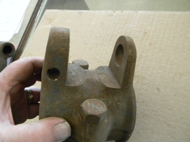

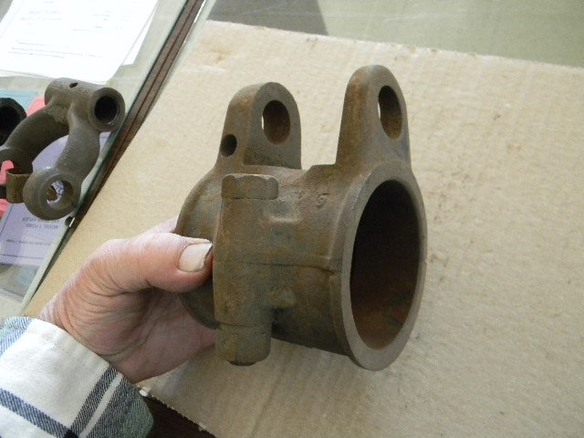

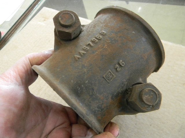

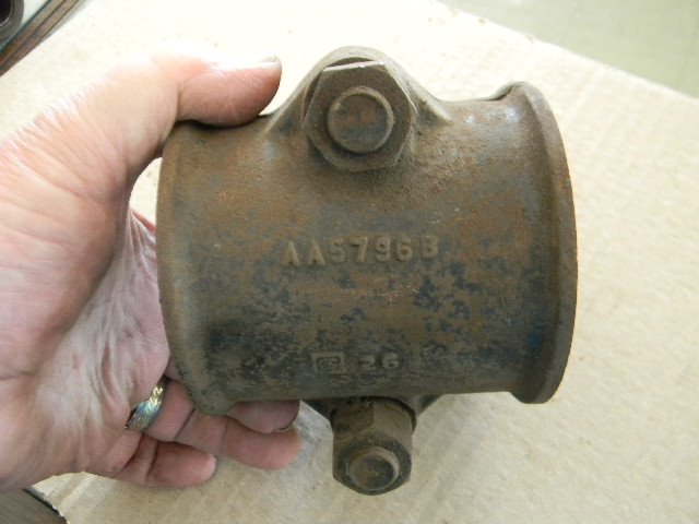

I looked i8n the books but can not find out any information on this coupler, will this also work on the TT truck and how reare are these, Bob

Anyone know about this? Bob

Looks like an AA rear spring perch to me.

Bob;
I wrote the number down and will look in the Big Green parts book on Monday. It cover chassis parts from 1928 to 1947 for trucks and up to 1948 for cars.

Bob it Looks to be the late 31 AA shackle hanger that fit on the rear axle for straight frame trucks.

Thank you, Bob

I was thinking that the slight offset alignment of holes in the two lugs might suggest that a pair of these might have been designed to mount the reinforcing truss rods that you sometimes see on rear axle housings,....???
