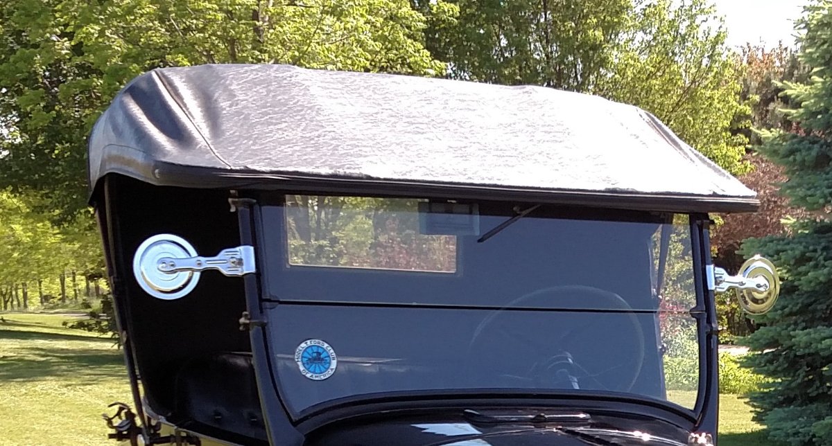

Recently I ran across an ad for a ‘25 Roadster and it struck me that this wasn’t the first time I’ve seen the top done wrong and in the same manner. Rear iron/bow too far forward and middle iron/bow too far back.
No way to correct it without installing a new top!

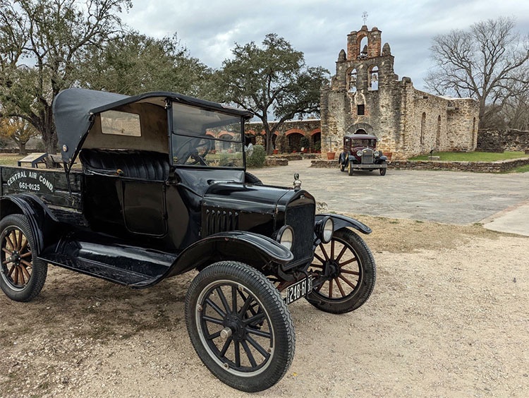

The ones I really hate to see are the two man tops where they leave the front moveable bow in the lower folding position and then cut and fit a top onto it. Runabout or touring car doesn't matter. Nothing can make it look right except starting all over again!
Part of the problem is of course boat top fitters that aren't smart enough to realize they do not know what they are doing. Simply looking at a few proper photographs could make all the difference in the world.
There is really only one right way all the way through. And a hundred possible wrong turns. At least TRY to find a road map!

I keep looking at the geometry in the first photo. The top irons aren’t correct or the front irons have been lengthened. The rear bow is close to its correct location but the second bow needs to hinge forward. Doing so would push the front bow forward and past the windshield more than it currently is.
Definitely a DLR…Doesn’t Look Right.

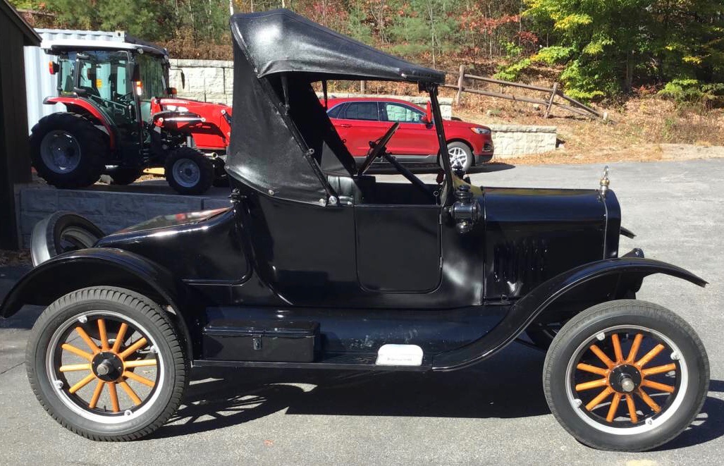

Don’t feel too bad Mark. Heres the worst::
- Posts: 6825
Re: How to do a roadster top wrong
George
having a hard time typing while convulsing with laughter!
A second look tells me that it can be put right in seconds, though.

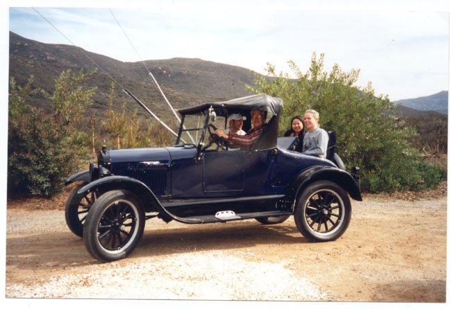

My 26 Roadster came with earlier top irons. It also has an after market rumble seat. I think the top looks OK, but if I ever need to replace it, I will look for the proper irons.

George, that’s the worst one I’ve ever seen!

Scott, et al,...that cut off touring in the pic I sent has had the top exactly like that for over the decade that I’ve known the owner. Hes satisfied with it...
