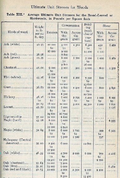

J1MGOLDEN
Posts: 1323
Last Name: Golden
Location: Bowie, MD
Re: Ash wood substitute
Post by J1MGOLDEN » Sat Dec 10, 2022 10:25 am
This is more information, but not a great copy.
Wood Specs Early 20th at 72.jpg (75 KiB) Viewed 5963 times
