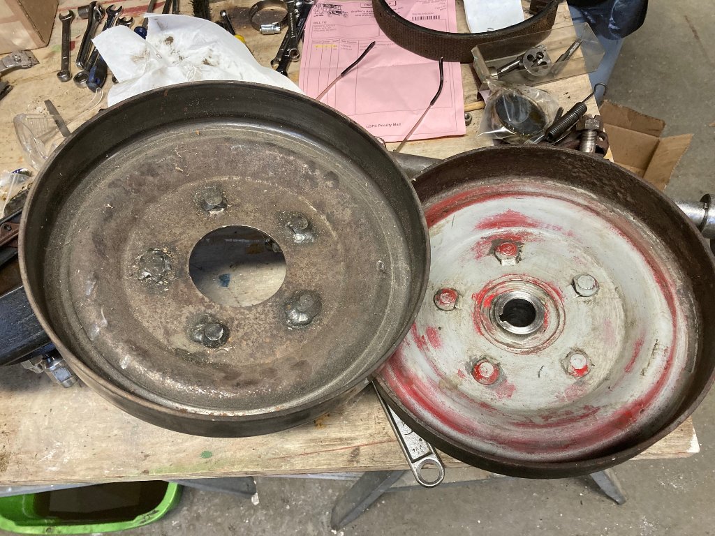

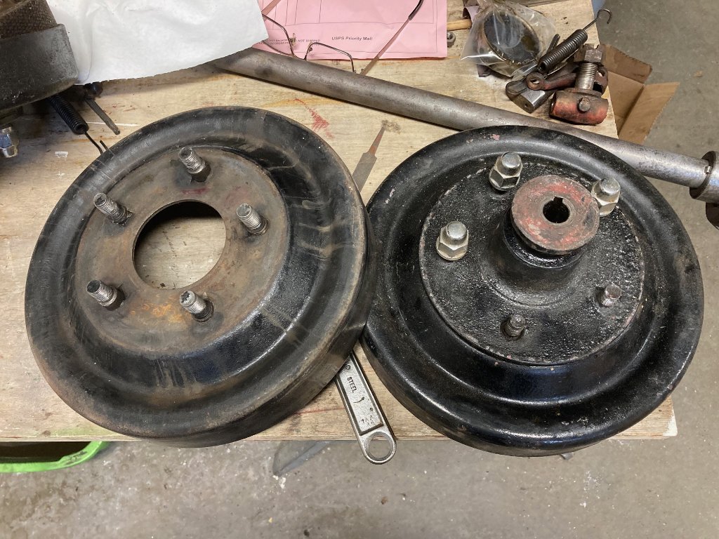

Can I replace the rear drums on my hubs for my wire wheels, my hubs are good but the drums are rusty, I've searched online, in the service manual and front and rear axle book and don't see anything about this, can it be done and how to you do it?
I see there are drums for wire and wood wheels, what's the difference and what are the spare drums I have?
All the studs in my current drums and the spare drums are welded in, is this okay or do they have to be sweged?
Thanks for the help
Thanks for the help

The brake surface can be dressed & squared up via a tool post grinder. If severly pitted, there isnt much point. The drum will still work as a parking brake.Scott_Conger wrote: ↑Fri Dec 09, 2022 11:22 amBruce
unless you are modifying your car to use the rear drums as service brakes, I would not see a problem with sandblasting things and using as-is. So long as they remain in their original state, that of parking brake, no harm-no foul.
as for welded studs, they wouldn't bother me in the least.
The way your sample drum was welded was no good. The hub needs (originally was) to be securely fastened to the drum. Welding the stud heads is ok, but that function is to keep them from turning only. The swedging is on the outside to the hub. Note your complete unit has tabs in the drum & flats in the stud bolts to keep them from turning. The studs get swedged into the hub holes.
The process is common for model A's. Look there for the procedure. The swedging process requires a beefy press & an A style swedging tool.
I have changed out several bad drums or hubs with good drums or hubs to get one real good usable unit.
I have heard that the repop drums wont run square when assembled. (from a disappointed fellow member) They must run true. So working with original drums would be a priority.
The difference between wood & wire drums is the 5 vs 6 hole pattern. Before I would use new drums, I would modify wood drums.
