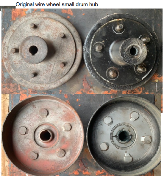

I did this 5 years ago. The flange on the hub to center the brake drum is the same size on both small drum and large drum. Transfer the holes and drill, 1 hole will line up. I found a (modern) stud with serrations and pressed the studs in. Seems to me I had .015 press fit on the serrations. The stud was Dorman brand, but I don't remember the part #.

Good memory! Small drum wire wheel hubs for sale.... to easy a solution
- Posts: 4725
Re: 26 27 wire spoke wheels on a 25
Wow. The rare of the rare. OP, you better jump on these.

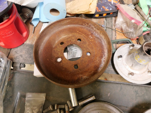

Topic author - Posts: 132
- Joined: Sun Jan 06, 2019 12:34 pm
- Last Name: Cox
- * REQUIRED* Type and Year of Model Ts owned: 1915 Runabout, 1925 Pickup
- Location: Tucson, Arizona

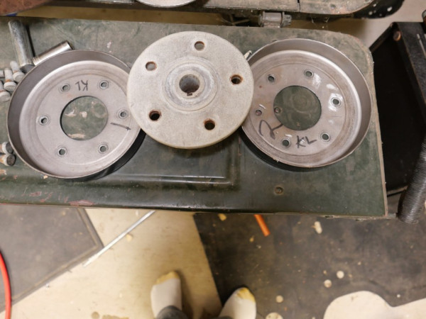

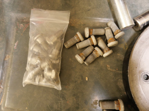

well I am back and confused
I bought new hub bolts (studs) from Langs and they measure .5 inch across the threaded section and .62 across the section that is swaged.
the hole in the hub is .5
The hubs had splined studs which I pressed out.
My question is do I have the wrong hubs?
should I ream the holes out to something close to .62?
I bought the whole collection from a gentleman up in Washington state.
He said that they had come off of a friends car.
- Last Name: Cox

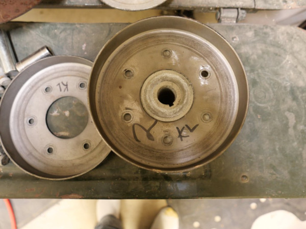

the studs fit the 26/27 brake drums just fine.
The rusty drums that I have may have been in an accident as the surface that mates with the hub is not
parallel with the outer edge of the drum.
I won't be using them as I have a set of early drums that I bought from Chaffins.
The problem is with the stud to hub fit.
The hubs may not be for a wire wheel T 26/27.
I may need to find a correct set of rear hubs or drill/ream the holes in the ones that I have.
If I decide to do that I need to know what the hole dimension should be?
How many thousands should it be undersized?
From the one picture you can see that the brake drum fits correctly on the hub casting (the big hole not the stud hole).
- Posts: 1855
- Last Name: Tannehill
- Location: Hot Coffee, MS

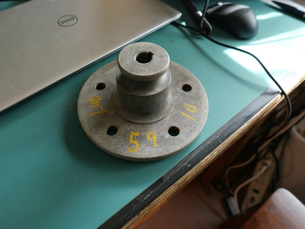

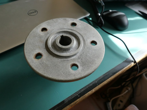

T wire wheel 5 lugs are spaced at 5”. Turn the hub over & take a picture of it. I see the back side but not the front. It appears correct on the backside, correct number of lug stud holes on the hub. If you do decide to use the small EB drums you need to know that you are placing the lug stud through the drum & into the wire wheel hub & even though swedged into the wire wheel hud & the head of the stud is flush with the back of the EB drum you will need to weld (and I mean a good weld) the head of the Lug stud so in the event you have to remove the wire wheel that the bolt doesn’t spin when trying to remove the lug nut. Ideally it would be better to form a punched lock as seen on a 26-27 wire wheel EB drum. Trust me that if those studs are not secured in a solid almost permanent fashion you will have some major issues & be in for a world of hurt if you ever have to remove the wheel. Others may have a varied opinion

- Posts: 6260
Think it would be best to start over. First with pictures of the hubs you purchased from the guy in Washington state. Why did they have "splined" studs?
The only thing that about the studs that matters are the diameter, length and that head does not interfere with the axle housing backing plate etc
Do the wheel hubs fit the front & rear ?
- Posts: 1855
That’s correct but the splined lug studs shoulders don’t appear deep enough. Remember they have to go through the EB drum and then the hub itself. Could be optical but I’d measure to be sure. Best John
- Last Name: Cox
the hubs came without the brake drum
Just the hub with the studs installed
I didn't realize that they were splined until I pressed them out
If the brake drum had been installed I wouldn't have had the problem.
The brake drum holes are .6 so the hub would have been .6

I’m talking about the depth of the splines, they need to be deep into the hub maybe even very slightly proud if your going to do that. In addition if you drill the hubs to .62 what are the splines supposed to dig into to keep them from turning in the hub? It’s supposed to be a solid press fit. Just realized you have bought what appears to be the correct lugs & won’t be using the splined lug not in the bag. Still you will need to weld as stated before because you don’t have punch locks int that small EB DRUM

The rear hubs you show look correct. I have not seen one drilled smaller with splined studs. I cant say thats correct for early 26, however, in looking @ the super rare original small drum hubs, they appear to use the larger later style studs with the flat in the drum to keep from turning. Those splined studs for smaller holes is a head scratcher.
The replacement studs do look correct.
I would consider going to later big drum axle housings/rear end. The parking breaks are terrific & can be used as a service brake.

When replacing studs on a T wire wheel hub, you must remove the swage by cutting it off the swage off top of stud. Must swage the new stud with a tool.
T studs do not have teeth on them. Guess is the wrong studs deformed the hole in hub. I have a homemade small drum wire wheel hud I will post pictures tomorrow if you want. Not hard to do, other than the small drums don’t have the piece to lock the side of the studs. You must weld them after you swage them.

I don't believe the rear hub you show looks like a Ford manufactured hub. That does not mean it's not meant to fit a Model T. I don't recall ever seeing one with a step in the face** of the flange.
**The face with the paint pen markings.
- Posts: 4725
Interesting thought J.V.O., You made me go look.Jerry VanOoteghem wrote: ↑Mon Feb 13, 2023 7:06 pmI don't believe the rear hub you show looks like a Ford manufactured hub. That does not mean it's not meant to fit a Model T. I don't recall ever seeing one with a step in the face** of the flange.
That step cut is in the ones I have also.

Thank you to all of you for your comments and advice.
My current plan will be to
drill the hub stud holes to .622, which is the new stud diameter, minus a couple of thousands.
use the tool that I bought from Langs to remove the swaged material ,that it turned out I didn't have, to
bevel the the edge of the holes in the hub'
locate and drill the .622 holes in the small brake drums
press the stud through the brake drum and hub
swage the stud
tig weld the stud to the brake drum
swage the stud

Hi John,
Any chance you have a part # for the serrated studs? I found a Dorman stud that had way to much serrations for my application so I had to
turn them down and thread them farther to use model A hubs on the front of a speedster project. For those wanting to use adaptors &
model A wheels Speedway Motors sells a 5 on 5 1/2 bolt pattern to support A wheels on after market hubs that are small in the O.D. The
3 piece adaptors are large enough to support the A wheels the same as T wheels and the A wheels are stronger & cheaper than T wheels.
Thanks.
