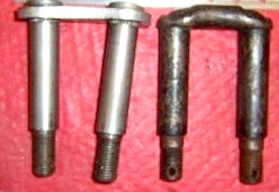

Rich- looking at your picture, I had the same problem. I now like the type in the eBay picture.
- Posts: 6607
Re: Budget Spring Shackles
Would welding the pressed in bolt caps to the strap solve the concerns about being pressed in? There may be other issues but would welding make the usable? At least something to try

In the picture above, it looks as if the splined portion of the pins can enter the ends of the bushing. That could cause problems. Is there a shoulder on the nut end of the pin to limit how close the end plates can come together?

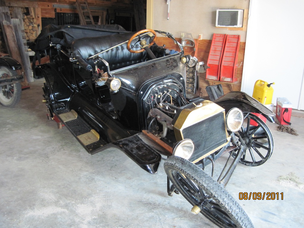

This was a pristine car until the spring shackle broke. The driver was killed and passenger was seriously injured.
- Posts: 6827
Uh,
No
An aftermarket shock absorber/perch combination broke
but in fairness, the result could possibly be the same with a failed shackle
No

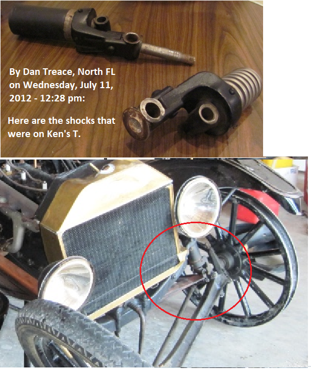

In the picture of the Meek 1915 posted by Hal you can see the surviving aftermarket shock directly below the left headlight. It was the one on the right that broke. From what I've read in posts about this wreck there was some speculation on whether the immediate cause was the shock/perch breaking, or the loss of the underinlfated left tire causing it to break. I've lost a front tire twice, once on the left due to a rim cut and once on the right because I neglected keeping the pressure up.The left incident was at cruising speed on pavement. The right side incident was on dirt/gravel at about 25 mph. In neither case did the car give a hint of wanting to veer off course or go sideways. I believe that's because all my stock steering and suspension parts remained intact. The under-axle wishbone in both cases may have helped.
If I was ever tempted to try aftermarket accessory shocks, the Meek wreck dissuades me. On any car with the over-axle wishbone I would switch to the incorrect later wishbone or add under-axle reinforcement.
- Posts: 4414
Hasslers seem to be okay. Thousands of model Ts currently use them, and there have been very few scary incidents with them (unless they were worn out to ready to fall apart!). And most H&D style may be okay. However, some of the H&D knockoffs I would NOT trust! Some of the era cheap knockoffs were too flimsy.
That style of tall tower/spring shock absorber should NEVER be used on the front end of a model T! NOT EVER! Regardless of original manufacturer, whether forged or cast, one-piece tower or multi-part tower? NEVER!
There is an engineering flaw in the design that MIGHT cause the front axle to become unstable under certain conditions that WILL happen from time to time at speeds over about twenty miles per hour. They may have been okay during the brass era when Fords were rarely driven too fast. However, today, when we routinely exceed twenty miles per hour? NO WAY!

I had heard the story about the death shock in the past and assumed where it may have broke. It wasn't as I had expected at all. I just did a search and found the picture below. Ken Meek accident follow up https://www.mtfca.com/discus/messages/2 ... 1342495776
- Posts: 4414
The Meek's shocks were an unusually BAD design, multi-part riveted and poor material choice. But make no mistake about it! All such "tower" shocks are NOT safe to be used on modern roads and speeds. Several severe accidents and a few deaths have occurred using other tower shocks. I would NOT trust any of that design shock absorber on the front end.

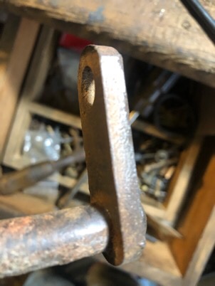

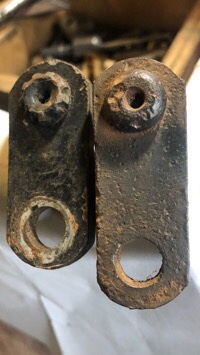

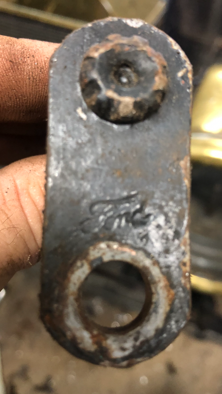

I thought about this thread today when I found this 1/2 shackle in a drawer. It appears to be a stud pressed through a plate as described with the budget shackles. I don’t know what the new ones look like but was this one has Ford on it. Was this design used in production at some point?
- Posts: 4699
Uh Corey! You may have started something! ! I’ve been following the this thread also. To me this particular shackle your showing looks like it’s a bit thicker plate than the budget ones made these days. I didn’t know Ford made that type but???
- Posts: 4414
I have had (I think still may have?) a few of those "L" shaped shackles with a Ford script on them. They are quite old, and a couple I had were thoroughly worn out! Years ago, they were believed to have been used by Ford for a short while during the model T era. Perhaps between the earlier "L" shaped ones with threaded oiler holes in the late brass era and the common later "U" shaped ones? I don't offhand recall if Bruce ever covered those in one of his books or not? The stamped "Ford" script would seem to indicate something around or later than 1919? Once the "U" shaped ones became common, I can't really see them making these? I think the common "U" shaped ones were available new as replacements at least into the 1950s.
There were also simple "L" shaped ones forged out of a single piece of metal. These ones are two pieces of metal. I had one that appeared to have been broken in collision damage. They seem quite strong, and I personally would probably use them if I had enough for an appropriate year car (if I knew what year was appropriate?).
The problem with the current cheap replacements isn't simply that they are made from two pieces of steel. The problem is that they are poorly made from two pieces of steel.

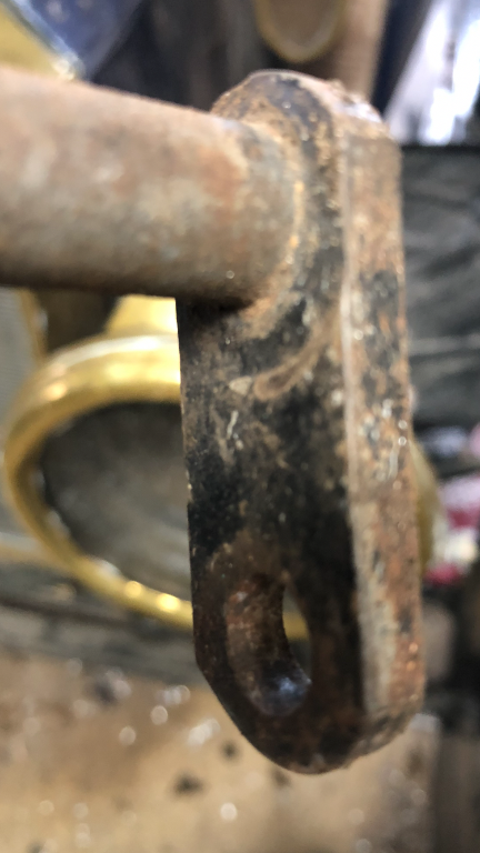

Here is another one that I found. This one is a rear shackle with no script. The way they swaged it is didn’t leave the dimpled edge.

Looking online at hotrod suppliers, the shackles they sell look the same as the ones pictured above but use nylon or urethane
bushings. The hotrod guys don't seem to have any issues with them. Of course they only run blown V8's. Where was the ones
in question purchased from? Hope not from any regular suppliers. Maybe the fore mentioned trailer supply? I purchase every
good original set I find that are serviceable but most are not. Shackles seem to be a part only changed when totally worn out.
Craig.
Craig.
