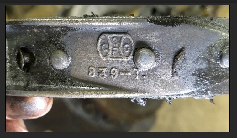

Re: Is Anyone Still Using the Riveted ‘Ears’ 1 Piece Tranny Bands?
ok so another old thread but I'm bringing it back to life! I'm looking for information on this. Doesn't say Ford on it...
SFCO was an early parts supplier to Ford - I have curved fan arms, rear brake levers, slo-speed connection arms & some others to start.
Thanks! Looks like I have an "unmolested" engine here to film!
