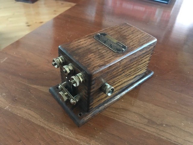

Has anyone used or is still using one of these Master Coils?
Are there any real benefits from using one?

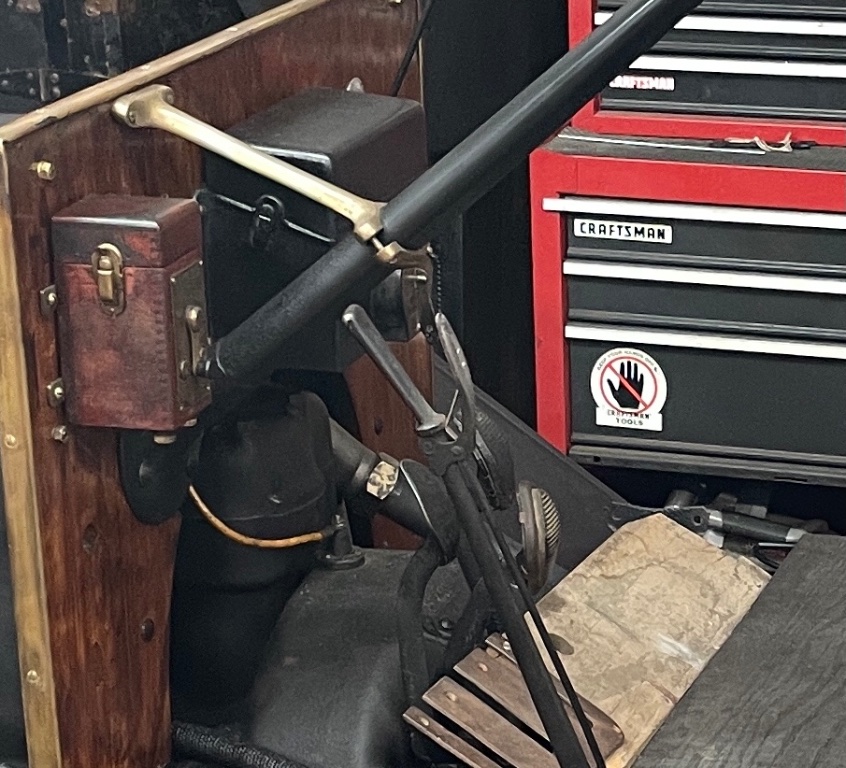

On my ‘12 project have mounted one with the wires to the coil box cutaway. Just for fun discussion when someone asks, what is that?
I reply, “a Master coil used with the early wooden dash box with 4 individual spark coils, these early ones didn’t work together well, so owner used that single Master coil. Someone removed the wooden coil box, and installed a later metal coil box that used 4 better coils that improved over that Master coil, so that Master coil was just left in place with the wires cut.”

The 1922 woody was driven with the Master Coil since then for about 15,000 miles without any problems. About every time the car is started it was given a free start even cold and set for a long time. Cold I just turn the engine a few times over with the choke pulled out and the ignition switch off. as soon as the switch is set on battery I have a start. Starting on Magneto is easy also. I don't know if the free start had something to do with the Master Coil but ... .
Since that time I rebuilded a few of different kinds. The best results I have with the K&W MC's.
