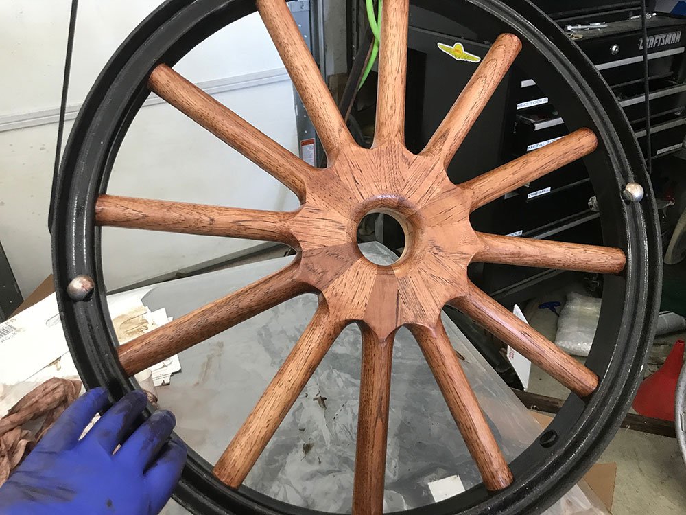

I agree with the other posters. When you consider the individual cost of the spokes and the need to build a Regan spoke press, sending the wheels to Stuzman seems a good deal. I have visited his shop and he has a truly quality operation. This is one he did for me after I stained it. I had him leave the hub out as I was using it to replace a wheel that had been modified for floating hubs and disc brakes.

I like the way your spokes are finished under the hub. Did you put some sort of sealer or preservative in the areas where the spokes come together at the center and on the end grain at the rim ?
