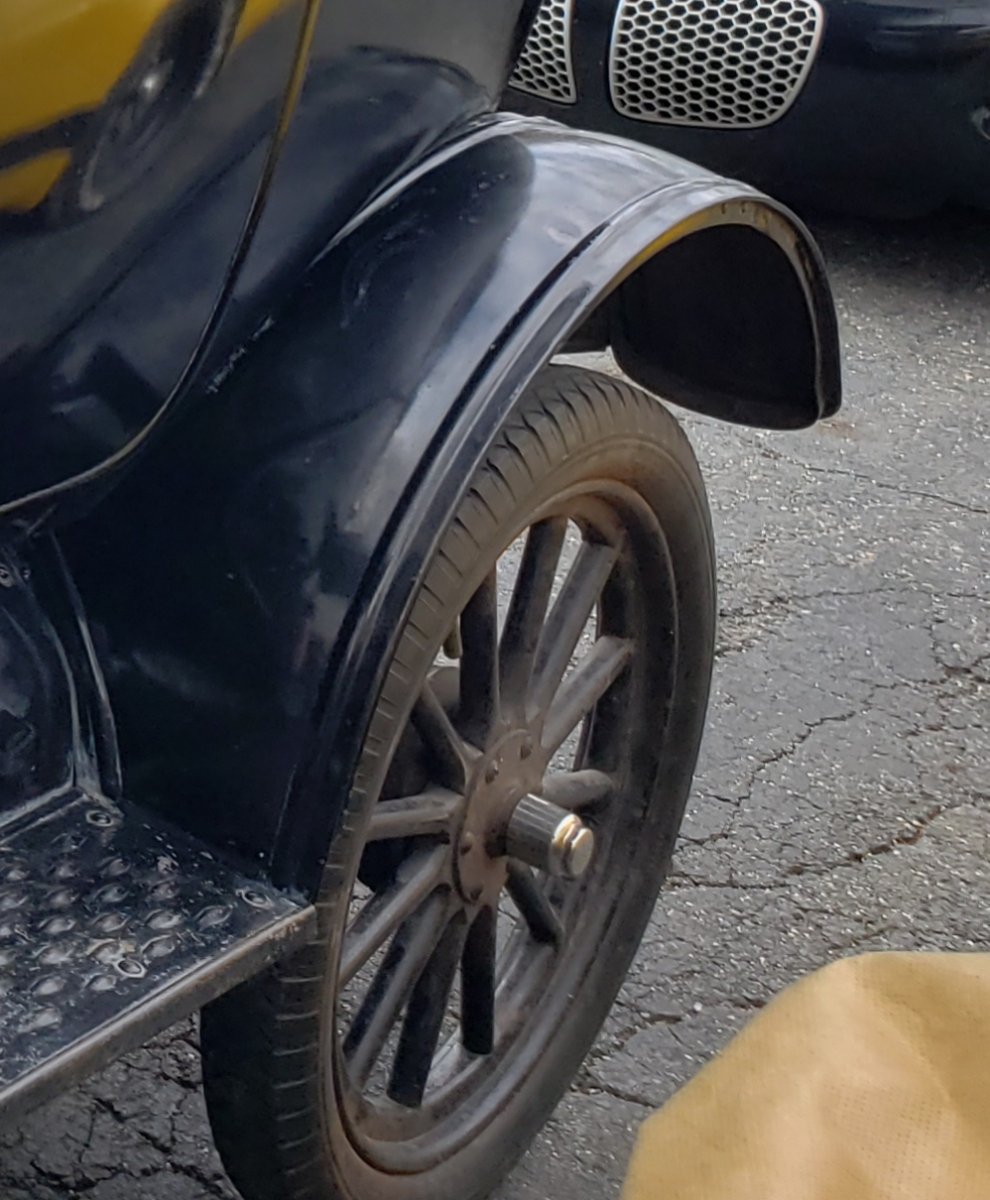

Oh wow!! 1909-1916 round fellow nondemountables with well worn Wards Riverside tires. As mentioned above, you should have demountable rims/tires fastened to steel fellow wheels with 4 bolts and lug nuts.

While they might be wood fellow wheels, they look like metal fellow that came later. The coloration of both the rim and fellow look the same. Plus to me the spooks just look to big to be early. DONES475, are the fellow wood or metal, the part of the rim the spooks press into?

The felloes look steel to me, looks like a little rust spot at about 5:30...
Correct for a 21 without the starter option, I believe, 30X3-1/2" non demountable clinchers.

John, the picture you posted is a non demountable clincher rim. You change the tire with the wheel on the car. Jack it up, put a jack stand under the axle, and get to work with a couple of tire irons. Cars with non demountable wheels do not have a spare tire. Early cars came with a tire pump, tire iron, and tube patches.

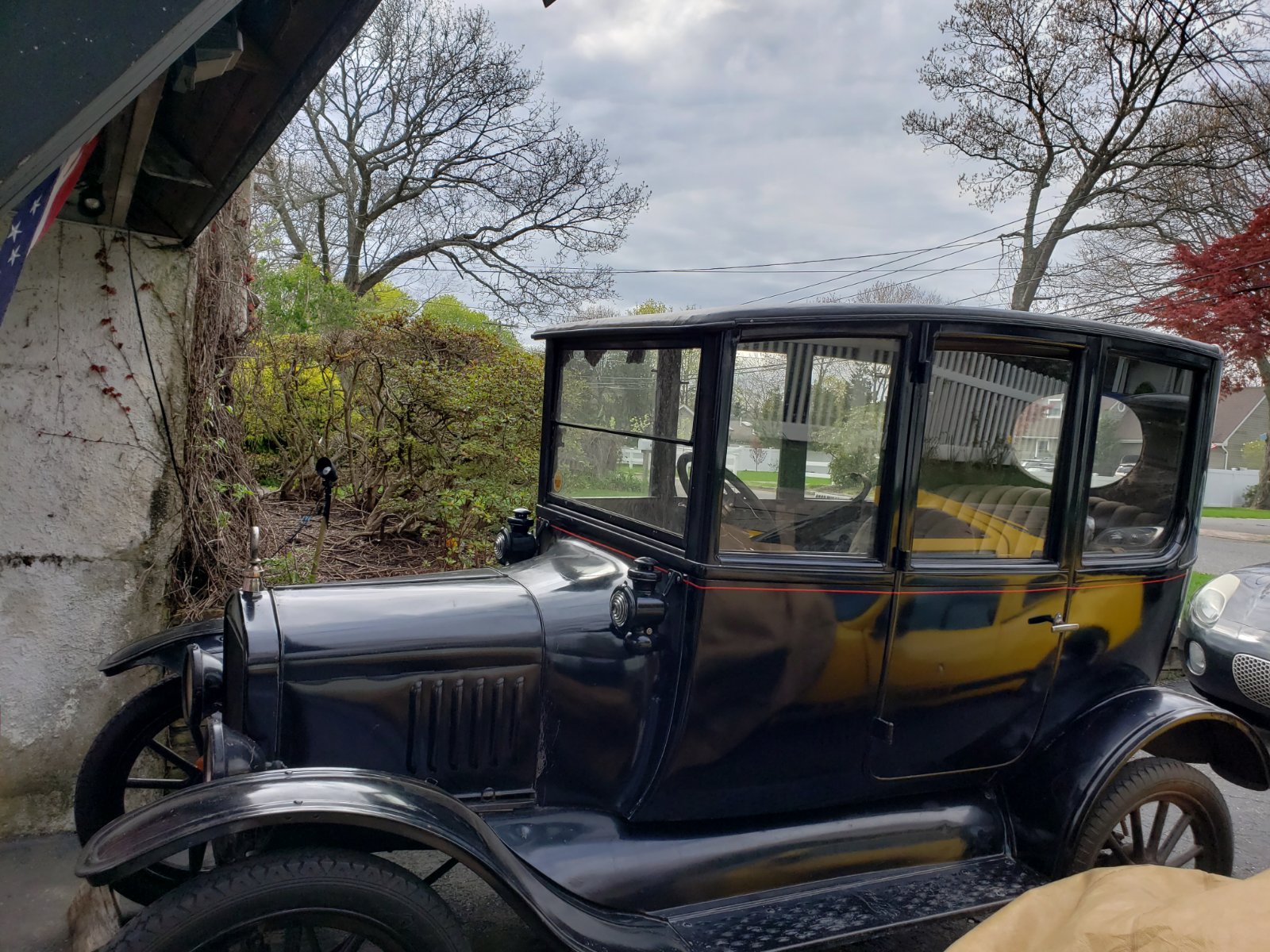

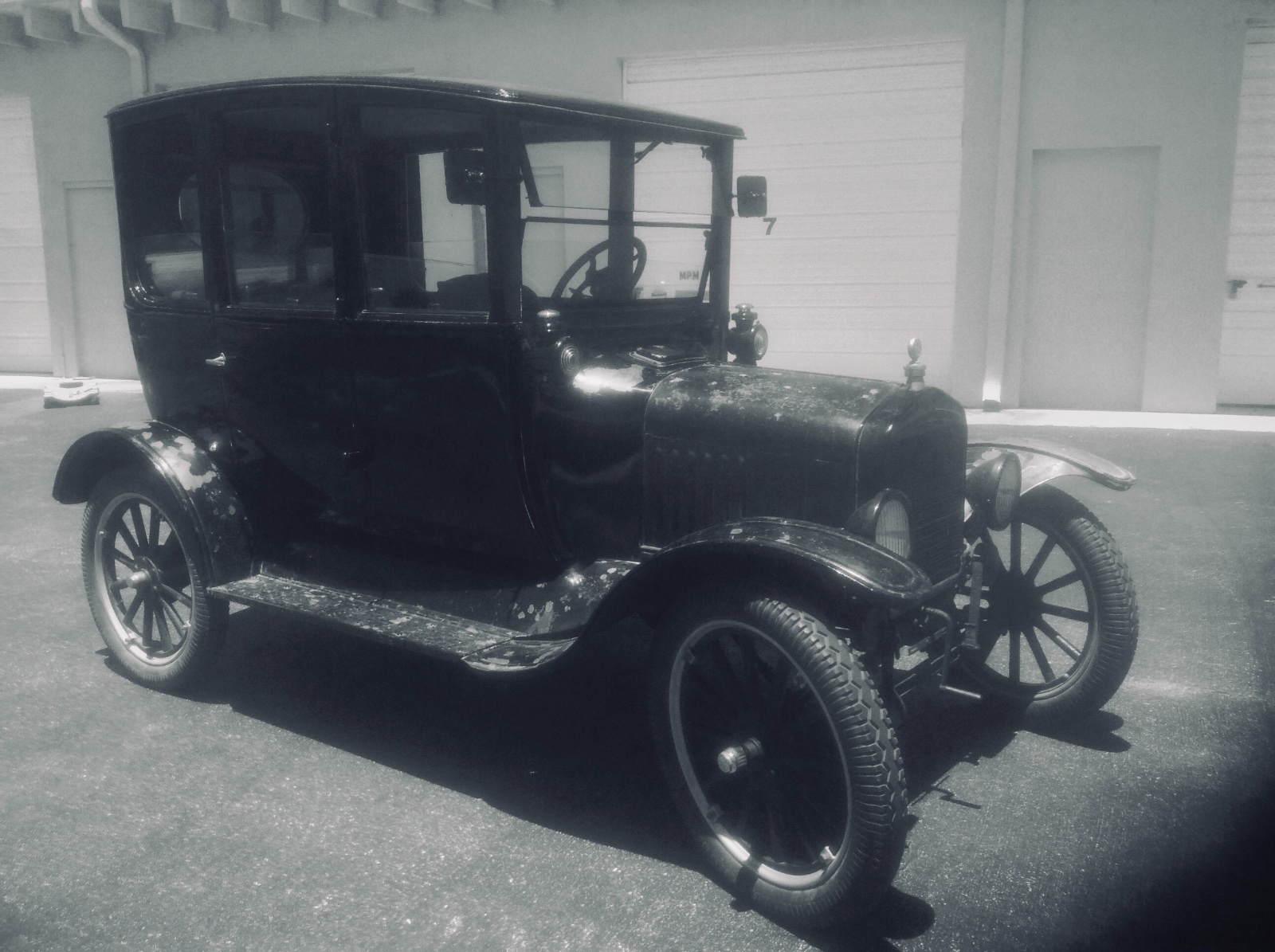

Heres a shot of the car.

By 1921 for was using 30x3.5 demountables all around
My friends 17 centerdoor has demountables all around
- Posts: 7411
Re: Rims and Tires
I agree with George House. The wheels on the car are 1909-1916 round felloe nondemountables. Correct for 1921 would be 30 x 3½ demountable clinchers all around. I would go with Hayes rims like the ones in Bob's second picture.

So who says the T is a 1921? It also has oil sidelamps. Parts may have been changed in any of many possible combinations. The wheels it has and the sidelamps could be correct for a '17/'18 or very early 1919 model Ford center-door sedan. By February 1919 (supposedly?) ALL Ford center-door sedans and the new coupes had the starter/generator (electrical) as standard equipment, along with the new demountable clincher wheels, rims, and tires. The electrical package and the demoutable wheels/tires were optional on open body cars into 1927.
It may be necessary to examine numerous minor details to determine the proper year of the car. Regardless of what year it may or may not be? It sure looks like a nice model T! And I do like the center-door sedans!
- Posts: 4410
Re: Rims and Tires

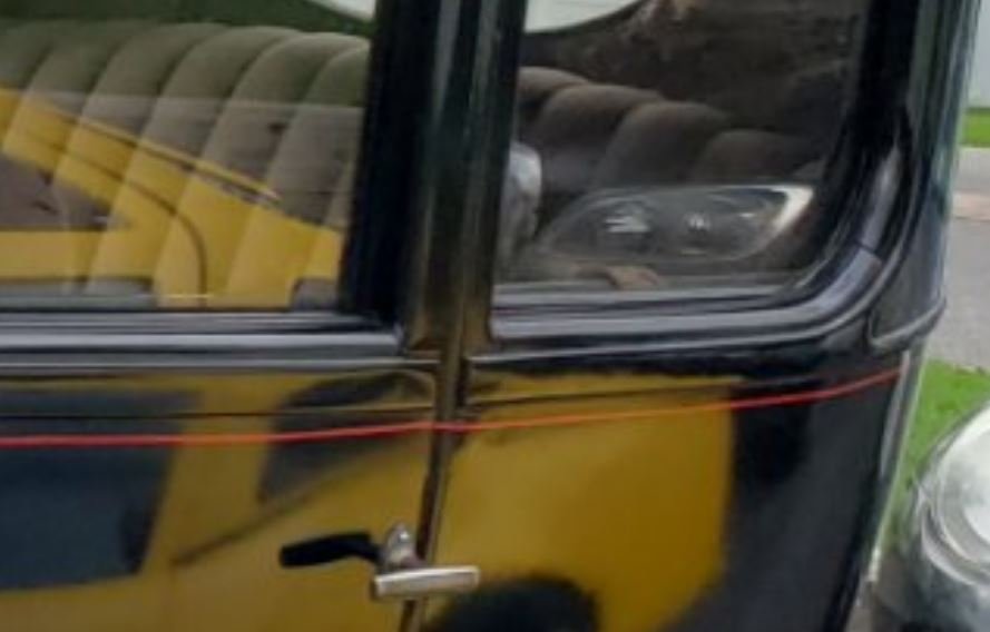

Zooming in on the picture, the seats look pretty nice. Due to the reflections on the glass, I can't see much else inside. Original interiors are getting difficult to find. If that is the original interior? It maybe should be preserved?

John,
Welcome to the forum! And you have a beautiful Centerdoor.
From your posting it sounds like this is your first T? If so great welcome to the hobby! If this is another T for you – please let us know so we don’t bombard you with things that you already know from having driven and lived with other Ts for years.
For doing some background reading on your T – pages 287 to 304 in Bruce McCalley’s “Model T Ford” covers the 1915-1923 Centerdoor bodies and some of the changes to the Centerdoor bodies over the years. You can obtain a used copy of his book (Amazon, AbeBooks.com, e-bay etc.). Or my recommendation is to order a digital copy (available from: Available from: Barbara McCalley,308 Cottingham Court, Allison Park, PA. 15101 (412) 364-0561: gourmetbarbara2@gmail.com
$50.00 + $7.25 shipping. (05/22/2018). He also covers the 1909-1927 chassis parts including wheels and rims in other parts of the book. And the CD contains the Ford Price List of Parts for 1909-1927+ etc. As well as a digital copy of other Ford books.

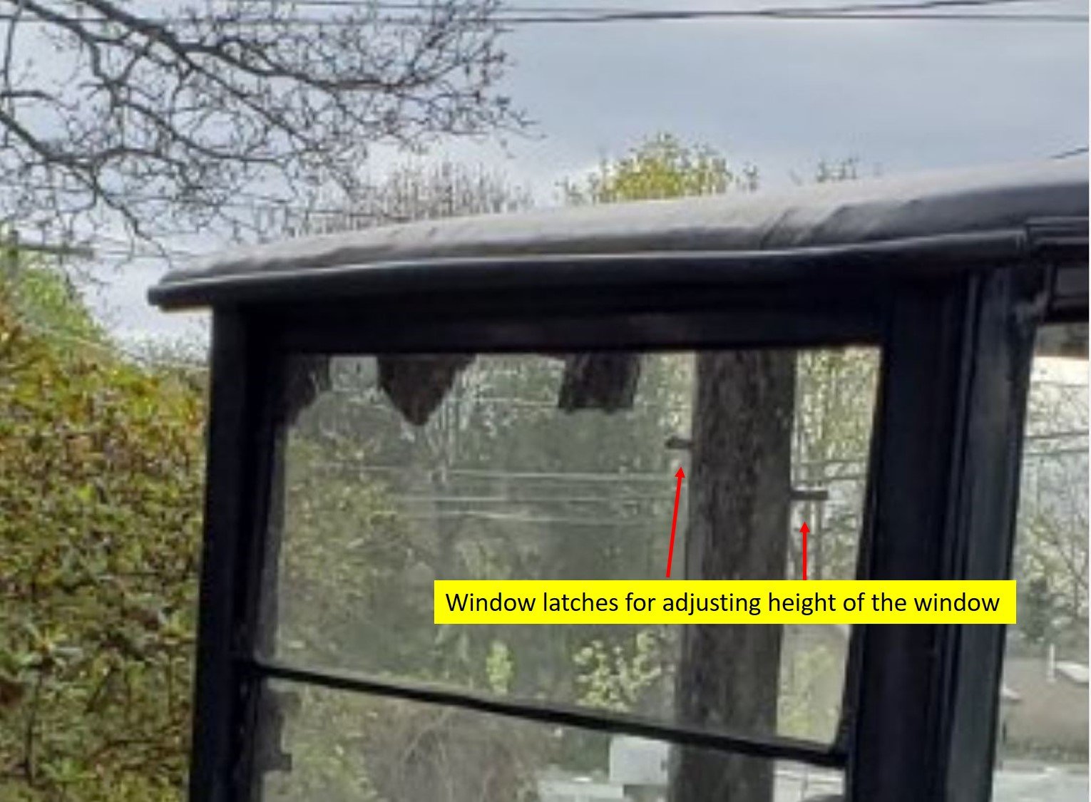

I need to run to work – but the summary is – your car’s body has the latched tracks to hold the front side and door glasses in position rather than the strap that is used to hold your back sides glasses in position. And your car appears to have the metal covers over the exterior window frames. Those features were introduced around 1922ish. Why “around” … on page 292 he shares about a Centerdoor in the book:
“David Simmering’s 1922 Sedan, a classic example of why one can’t absolutely define a certain year Ford. This one has the earler body with the painted wood window sills and the strap-type windo lifts on all side windows. This car has engine number 5,699,521 which ahs a casting date of Jand 21, 1922, and which was assembled Feb 8, 1922. This would be considered “mid-year” since Ford generally introduced “new” models about Aug each year. In any event, this car is typical of the 1919-1922 Sedans before the “1922 updating.”
And there was considerable overlap when both the older and new style bodies were used. Below are some cropped photos from your posting showing your car has that later style body with the latch style widow tracks and the metal over the outside window surrounds. Again welcome to the forum!

Wow Hap! I should have looked more closely to the photos. Nice catch.
So the body (hence likely the car) is a late one and not an early one. Therefore the oil side (cowl) lamps and the nondemountable wheels are not correct for the car as those features ended for the center-door sedan in 1919. However, if you like it that way? You are not alone. Keep it that way if you want, and enjoy it regardless. You should likely change the wheels to the proper demountable types as they are generally easier to work with.
Beautiful car however you go with it!

From here, they look like steel felloe nondemountable wheels. To me, the curvature of the felloe is different than a wood fellow wheel. JMHO Dave

Hi John, thanks for sharing your new baby with us, and welcome to the T hobby,

I have never seen a steel felloe non demountable wheel other than in photos on the forum. I thought the transition between the usual felloe and the rounded section as seen on wood felloe wheels was radiused. On these wheels, that transmission is abrupt, like it is between the wood and the felloe on earlier wheels. Am I missing something?

Again welcome. Model Ts have had many changes over the years. Saying your car should have demountable wheels is a bit harsh. What I would suggest is you have great looking wheels. If they are straight and tight run them. Keep them aired up and probably use flaps and balancing beads. Put any new tires out is the sun on a hot day to make them a bit easier to mount. Ditto for getting the old ones off. That probably needs 2 people. I try on the car and on the ground if needed. Do not cut as already said old tubes are probably better than new ones.

Nice Centerdoor! Looks like a '22 to me as it has the ratchet window risers and no visor. My unmolested '22 has Kelsey rims. Someone added side lamps at some point and an after market cowel vent as well. Lots of cars were modified like that. I like the look!
