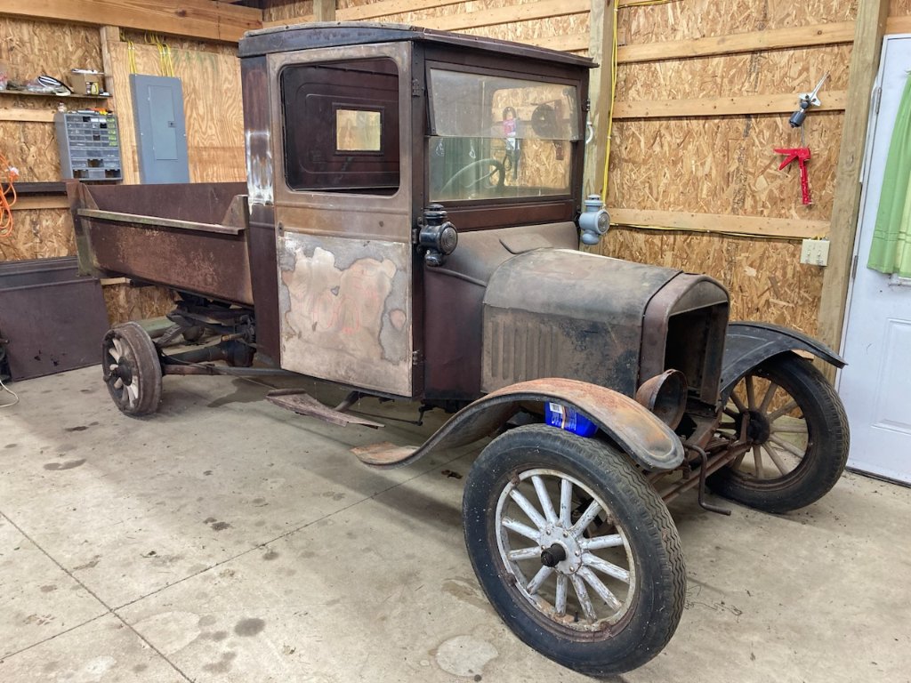

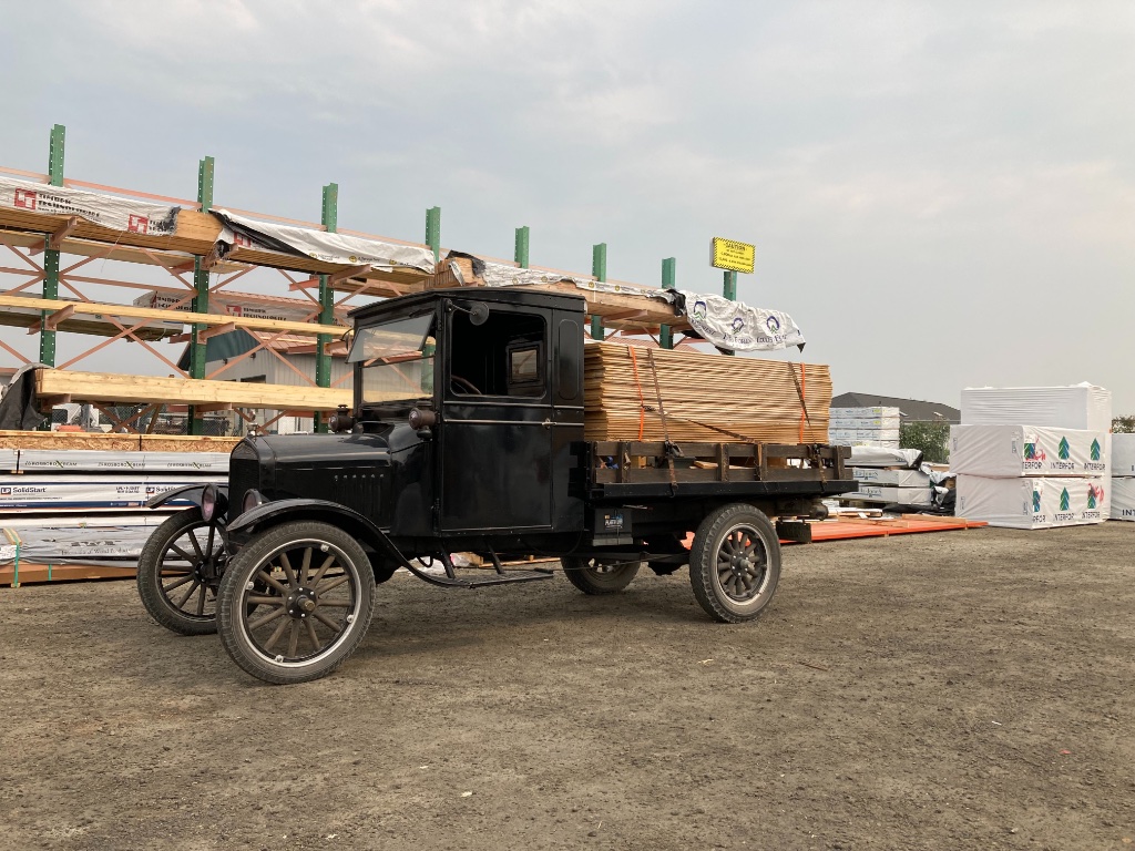

As they say in Chugwater, ... no pictures, .. it never happened. Let's
see this wreck of yours. Here is mine:
Here it is, I got in 2017 and have been collecting parts for it since then. It had no bed, doors, fenders, hood, side lights. The dump bed was a lucky find that was only about 25 miles from home and a great price too! Still on the market for better doors though (the one in the picture is not as nice as it looks) and the better outer demountable rims for the rear 20" wheels, and a shift lever for a Chicago auxiliary transmission because mine is broken off. I am currently working on going through the process of getting a proper title for it and thus the year question.
