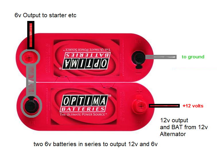

Two identical 6 volt batteries in series with a full gauge center tap for the 6 volt starter would work well for the starter. I'm not sure an alternator's regulator would be entirely happy with the arrangement, or that the batteries themselves would be. Using the starter would load only one of the batteries, which would leave you with what is effectively a 12 volt battery with 3 partially discharged cells. That could lead to issues with both the alternator regulator and the batteries.
