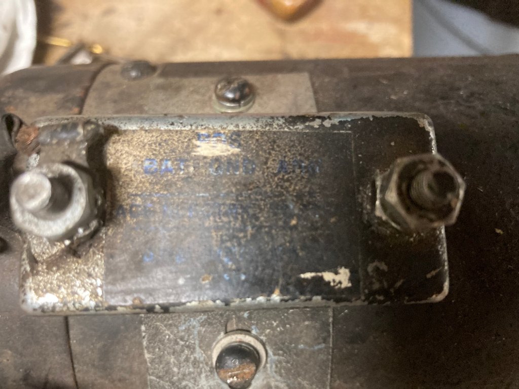

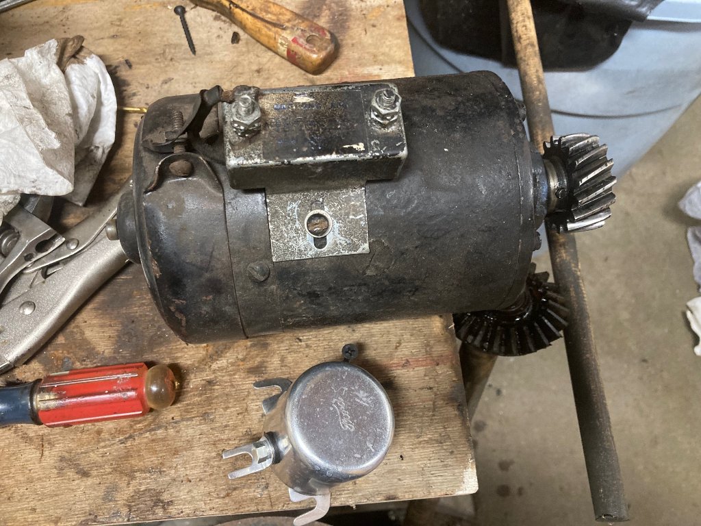

What do I have on my generator, should I leave it or change it out for the semi-conductor cutout I bought.
Does anyone know what it says under the paint, all I can read, top line POS, second line, BAT, GND, ????

It is an early cutout rectangular instead of round

I don't think so Frank - might be a re-fitted voltage regulator off a ????

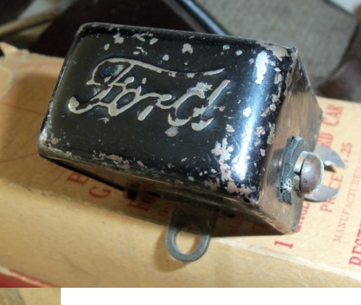

Actually I don't disagree with you. Your question prompted me to do a bit of surfing the internet and I did I find a picture of a similar looking repro for a 1928 Chevy. But the only way to tell for sure is to see what's inside the box. So its "most likely" a cutout.
Automotive voltage regulators started come into prominence in the mid 1930's https://ethw.org/First-Hand:The_Story_o ... _Regulator
The VR's do come in square or rectangular containers. Ford has some square cutouts too
ford cout.png (356.15 KiB) Viewed 2733 times
