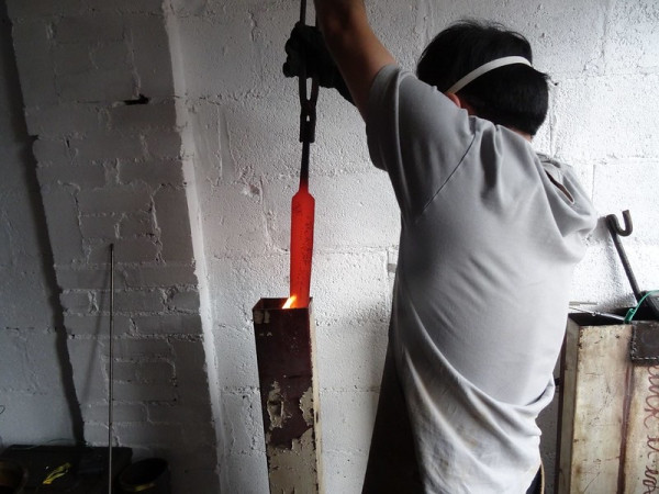

A hundred years ago, most amateur shade tree mechanics were unaware of how to straighten a tempered part, which means they were also unaware that, if they used heat to straighten a special alloyed part that never should have been heated, they needed to re-temper it, which, in this case, they obviously failed to do. At least they did not use water to quench it or the shaft would have probably broken during a turn, causing a wreck. If you have ever watched “Forged in Fire”, where 4 contestants (usually blacksmiths), compete to make the best historic weapons (swords, knives or axes), the part where they harden their blades with a long metal tube filled with oil will show you how tempering metal is done. Jim Patrick

This is nowhere near the same steel that knifesmiths use in Forged in Fire.jiminbartow wrote: ↑Sat Dec 17, 2022 2:58 pmA hundred years ago, most amateur shade tree mechanics were unaware of how to straighten a tempered part, which means they were also unaware that, if they used heat to straighten a special alloyed part that never should have been heated, they needed to re-temper it, which, in this case, they obviously failed to do. At least they did not use water to quench it or the shaft would have probably broken during a turn, causing a wreck. If you have ever watched “Forged in Fire”, where 4 contestants (usually blacksmiths), compete to make the best historic weapons (swords, knives or axes), the part where they harden their blades with a long metal tube filled with oil will show you how tempering metal is done. Jim Patrick
