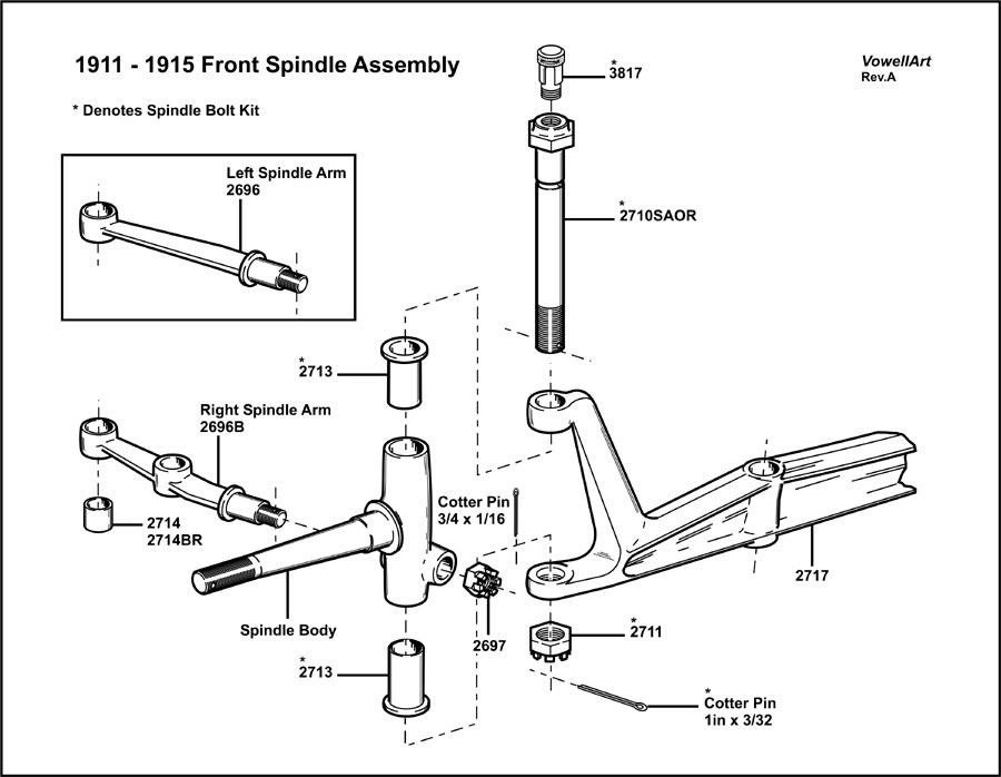

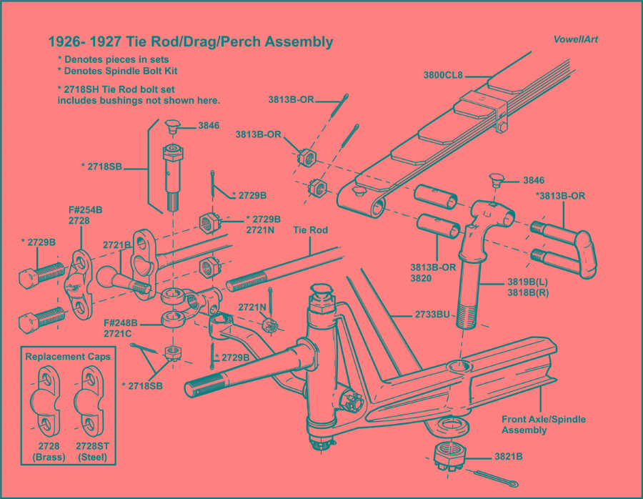

It would really help you if you had a manual of an front axle breakdown and pictures to go by. Get the MTFCA front axle manual for reference! Pictures say a thousand words! It will help you identifying parts and what they are called!
Here are some pictures of the Model T front axle. One is for a 26-27 and the other is a 14-18.
These can help some but do purchase the Ford service manual to get a good overall idea about a Model T and the MTFCA front end repair manual.
These will help you.

All advice was very helpful, thank you!!
In fact I had the manual and forgot I have it!
The diagrams John are also very appreciated.
