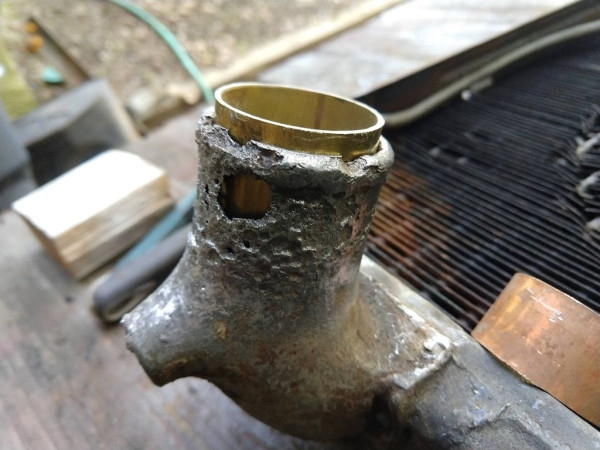

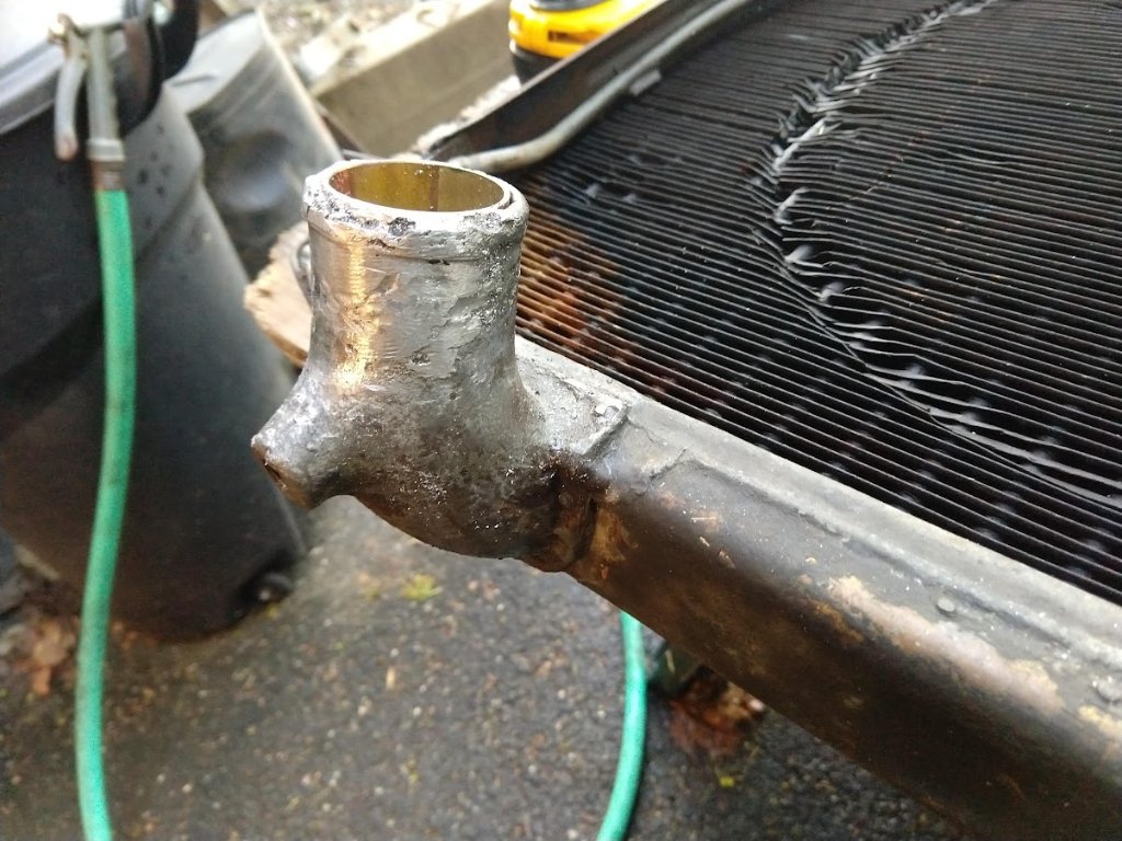

Here is what I did for the lower radiator connector. The connector had holes as you can see in the first picture. I used a brass plumbing pipe and a lot of solder to seal it in. It doesn't leak at all.
John

John, this is well done.
Luckily my radiator necks are good. Soldering so close to the radiator would make me a little nervous that some other solder joint gets apart. But in your situation there was not much to lose, I guess.
