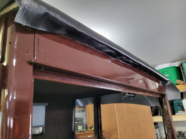

The next step in installing the top on my 1927 coupe is to attach the vinyl layer. Should I wrap it onto the "bottom" of the wood frame on the front or stop it at the vertical edge like on the sides and rear of the frame?

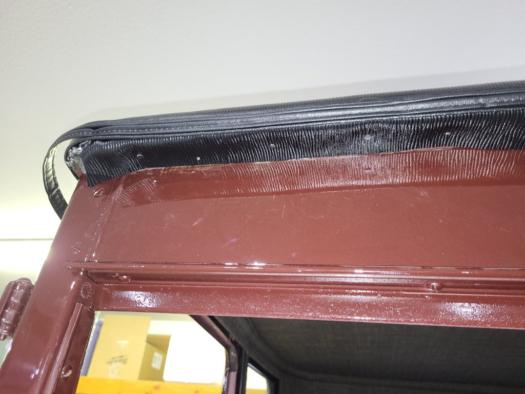

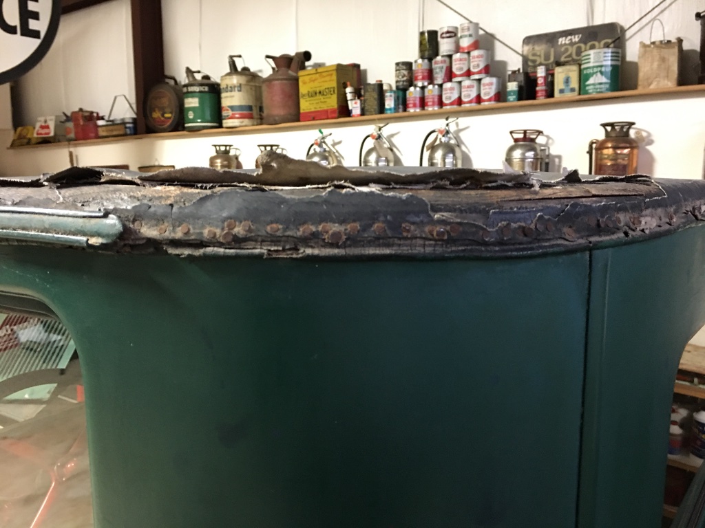

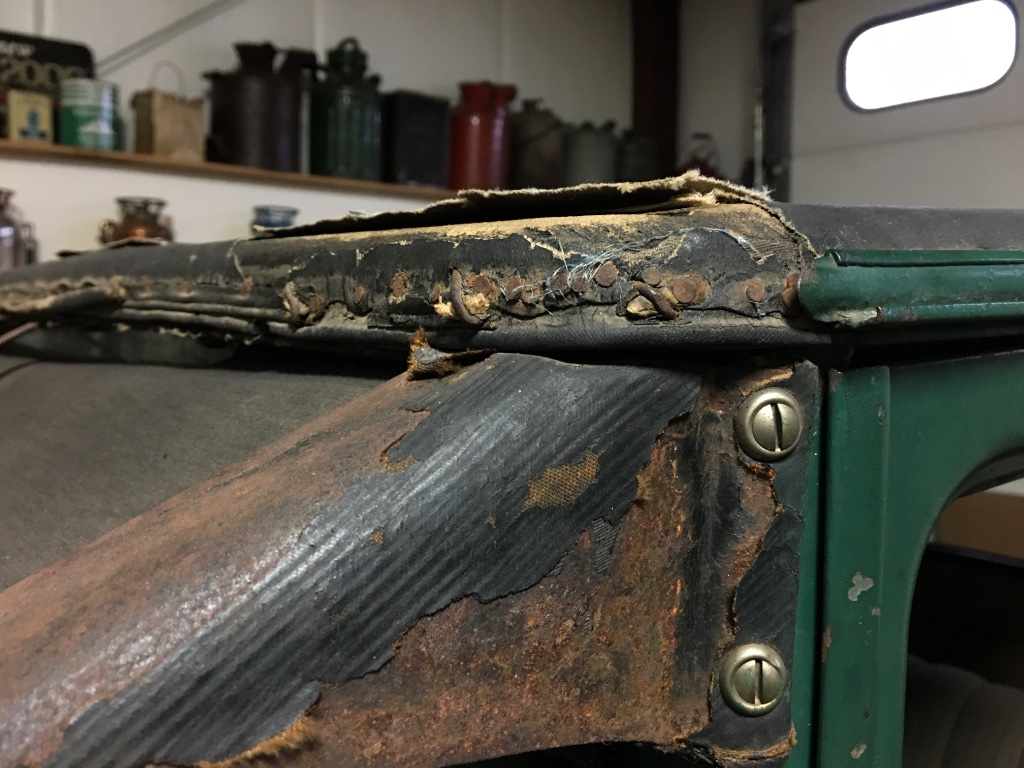

Here is a photo of whats left of an original top at the left rear corner.

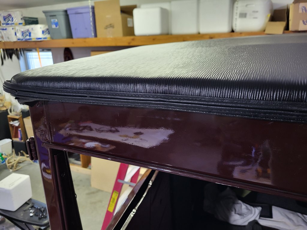

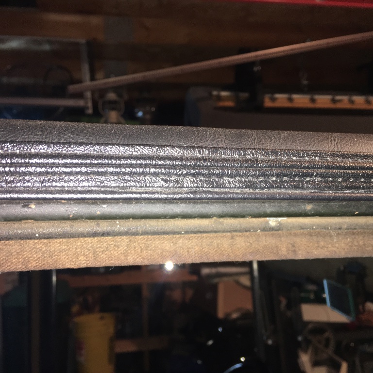

This is how it should look all the way around (unless using gutters).

Here is the front of an original and the visor.

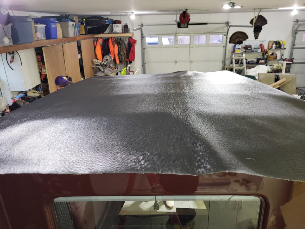

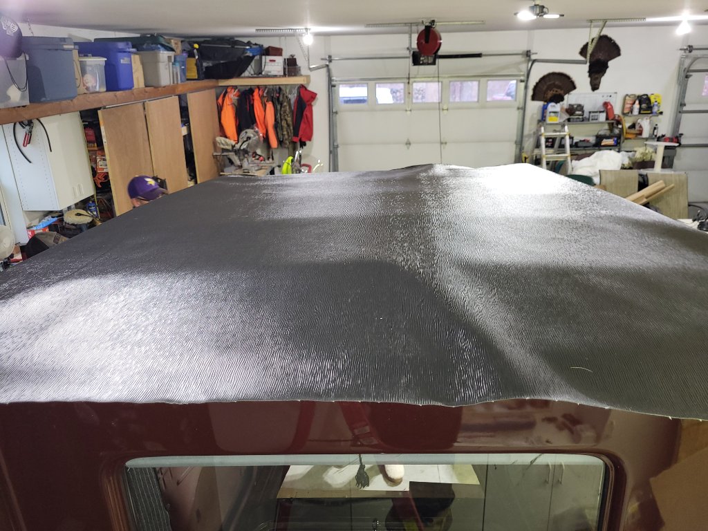

Post by BLB27 » Sun Dec 18, 2022 11:02 pm

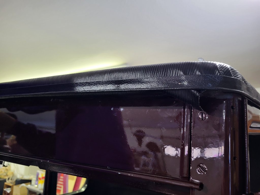

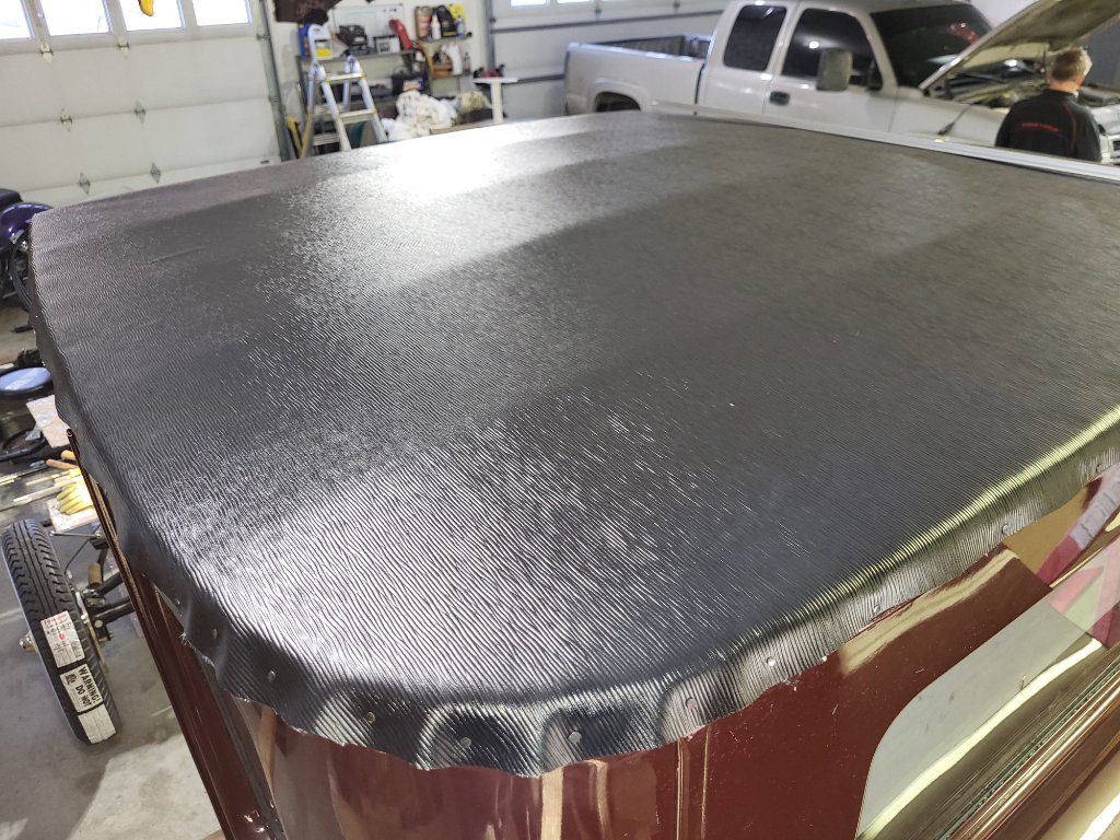

We got the top on.

After tacking the material and before installing the hidem-welt, you should cut slits or wedges in the material between the tacks where it goes around the corners. That helps to minimize puckering of the material at the corners so it will lay flatter and give a neater, higher quality appearance.
Adam
Posts: 1603
First Name: Adam
Last Name: Doleshal
Location: Wisconsin
Re: Installing the Vinyl Top
Post by Adam » Mon Dec 19, 2022 11:11 am
Don’t cut slits between the tacks. The material gets stretched while tacking so there are no puckers. If you cut slits under the hidem its a place for water to collect. Even if it isn’t a noticeable leak, the wood stays wet and rots.
Posts: 4448
Post by Jerry VanOoteghem » Mon Dec 19, 2022 11:40 am
Agreed! With proper stretching and a little help with a hair dryer, the top can be laid over the corners without puckering.
Also, the topping does not have to go under the front edge of the top, although no harm done I suppose.
If you add more tacks along the edges of the top, while also stretching a bit, you'll reduce the small stretch marks that you're seeing adjacent to each tack location.
BTW, you're doing a nice job! Just adding a few "pointers" for you. :)

Nice work!
