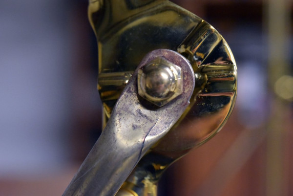

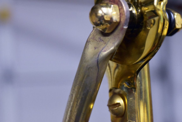

I have a fairly decent set of windshield support rods for my 1912 Roadster, with the exception of cracking as shown in the photos. Since I believe these are brass plated steel, I am thinking they could be repaired by TIG welding and then replated. I am guessing you brass guys have run into this very thing. Any advice?

Looks like a good candidate for silver soldering. Amazon sells Harris Safety Silv 45 and flux as a kit. I was told this stuff approximates the color of brass and is a good general purpose silver solder. I will be using it on a crack in my windshield frame.

I don't know the answer to your question, but I have seen both types of support rods. The ones I have came with the car, FWIW. One question I do have, is are they brass plated steel or some sort of steel rod with a brass sleeve pressed on it. I would think it is brass plated steel, but one authority insists that they are steel with brass cladding. Makes a difference in any repairs.

The one original that I've seen was a brass tube over a steel core

The original pair that I have are also made of steel tubes with a thin
brass tube covering the steel. They too have longitudinal
cracks in the brass that need silver solder repair.

FWIW My '12 Torpedo has a cast fitting at that connection for the brass tube. Never had any cracks or problems top or bottom. Check your tube with a magnet.

The brass clad tubing was also used on antique brass and iron beds. When restoring those I used chrome plated,brass sheathed bathroom towel railing, until they started chrome plating directly onto the steel tubing. Then I had to go to solid brass tubing. The brass covering on the steel tubing is not plating. If rust gets under the brass, it can literally be peeled off.
